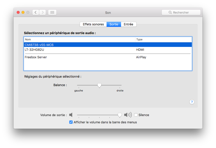

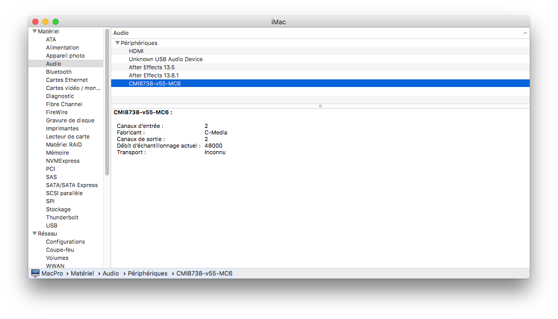

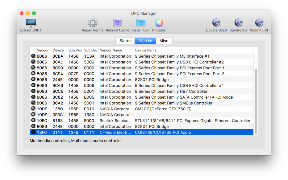

polyzargone Posted February 3, 2017 Share Posted February 3, 2017 Tiens ça me rappelle quelque chose ça, du C-Media... Moi aussi (c'est une simple carte PCI chez moi) : Link to comment https://www.insanelymac.com/forum/topic/320787-mac-os-sierra-v10123/#findComment-2362145 Share on other sites More sharing options...
angegabriel2k3 Posted February 3, 2017 Author Share Posted February 3, 2017 Alors après vérification, je confirme que ma Xonar D2X utilise le chipset audio C-Media CMI8788 ! ^^ Link to comment https://www.insanelymac.com/forum/topic/320787-mac-os-sierra-v10123/#findComment-2362152 Share on other sites More sharing options...
polyzargone Posted February 3, 2017 Share Posted February 3, 2017 Peut-être avec VoodooHDA … Link to comment https://www.insanelymac.com/forum/topic/320787-mac-os-sierra-v10123/#findComment-2362154 Share on other sites More sharing options...
