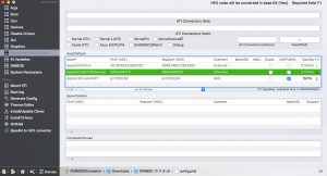

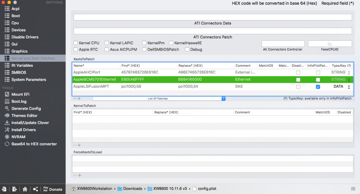

Blaggah Posted February 8, 2017 Share Posted February 8, 2017 Oh wow, i wasn't aware of it. For me on my Sierra partition, the lan kext doesn't load so therefore no internet. I'll see if it's it's the same and report back. Link to comment https://www.insanelymac.com/forum/topic/320064-sierra-1012-on-hp-xw8600/page/2/#findComment-2364843 Share on other sites More sharing options...
selkie707 Posted February 8, 2017 Author Share Posted February 8, 2017 Oh wow, i wasn't aware of it. For me on my Sierra partition, the lan kext doesn't load so therefore no internet. I'll see if it's it's the same and report back. Yep just make sure to manually delete the old one since new one has a different name Link to comment https://www.insanelymac.com/forum/topic/320064-sierra-1012-on-hp-xw8600/page/2/#findComment-2364845 Share on other sites More sharing options...
Blaggah Posted February 8, 2017 Share Posted February 8, 2017 I never had it in the first place using Benjudas pack. The lan kext is inside IonetworkingFamily kext so i have to put your new lan kext inside and install with kext wizard and test to see if it works. ===== I completely forgot that the lan kext is integrated through clover configurator and I don't want to mess things up. I'm just waiting to hear from Benjudas first before i attempt anything. At least for now, i got a fully working machine on El Capitan. I'm just not sure the proper step to take to make the change on the lan kext. I'd like to be able to revert back to his in case it doesn't work for me. Link to comment https://www.insanelymac.com/forum/topic/320064-sierra-1012-on-hp-xw8600/page/2/#findComment-2364854 Share on other sites More sharing options...
selkie707 Posted February 8, 2017 Author Share Posted February 8, 2017 I never had it in the first place using Benjudas pack. The lan kext is inside IonetworkingFamily kext so i have to put your new lan kext inside and install with kext wizard and test to see if it works. ===== I completely forgot that the lan kext is integrated through clover configurator and I don't want to mess things up. I'm just waiting to hear from Benjudas first before i attempt anything. At least for now, i got a fully working machine on El Capitan. I'm just not sure the proper step to take to make the change on the lan kext. I'd like to be able to revert back to his in case it doesn't work for me. I read benjudas post, if it is just a clover patch you should just be able to remove it with clover configurator then install the new kext. I am assuming you are referring to his updated 10.11 post which does everything via patches instead of kext files. The patch should be at one of these locations and should be labeled: http://imgur.com/a/RkmcH Link to comment https://www.insanelymac.com/forum/topic/320064-sierra-1012-on-hp-xw8600/page/2/#findComment-2364891 Share on other sites More sharing options...
Blaggah Posted February 8, 2017 Share Posted February 8, 2017 This is the patch from his config.plist Link to comment https://www.insanelymac.com/forum/topic/320064-sierra-1012-on-hp-xw8600/page/2/#findComment-2364908 Share on other sites More sharing options...
selkie707 Posted February 8, 2017 Author Share Posted February 8, 2017 This is the patch from his config.plist yep so just deleting that then installing the other ethernet kext should work Link to comment https://www.insanelymac.com/forum/topic/320064-sierra-1012-on-hp-xw8600/page/2/#findComment-2364917 Share on other sites More sharing options...

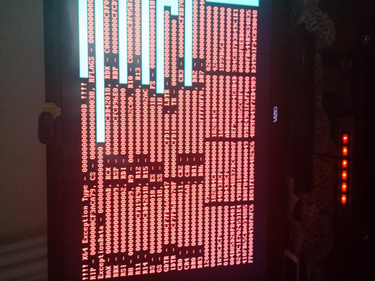

selkie707 Posted February 11, 2017 Author Share Posted February 11, 2017 So I went ahead and swapped my graphics card to the fx1800 and same thing happening. I'm going to try the FixShutdown and see what happens. Here is my entire clover folder from my efi partition, try using this. Specifically the dsdt and config.plist file should be tried. I would also make sure nvidia web drivers are uninstalled. Archive.zip Link to comment https://www.insanelymac.com/forum/topic/320064-sierra-1012-on-hp-xw8600/page/2/#findComment-2366450 Share on other sites More sharing options...
Blaggah Posted February 11, 2017 Share Posted February 11, 2017 Thanks for trying to help but when I try you whole clover folder I get this screwed up graphical screen. I just tried your dsdt and config.plist and it booted up fine but my problem still persist. I wonder if it's related to bios settings. I've got the most important things enabled so I'm not sure why I'm having such a hard time with this thing. ======Update Also with your DSDT and config.plist, after a good 30 mins of sleep, when I woke up the machine it just rebooted. I have no clue what's going on with my machine now. I just wish @Benjudas still had his machine and maybe he could look into it also. I'm gonna try El Capitan again. Link to comment https://www.insanelymac.com/forum/topic/320064-sierra-1012-on-hp-xw8600/page/2/#findComment-2366636 Share on other sites More sharing options...
