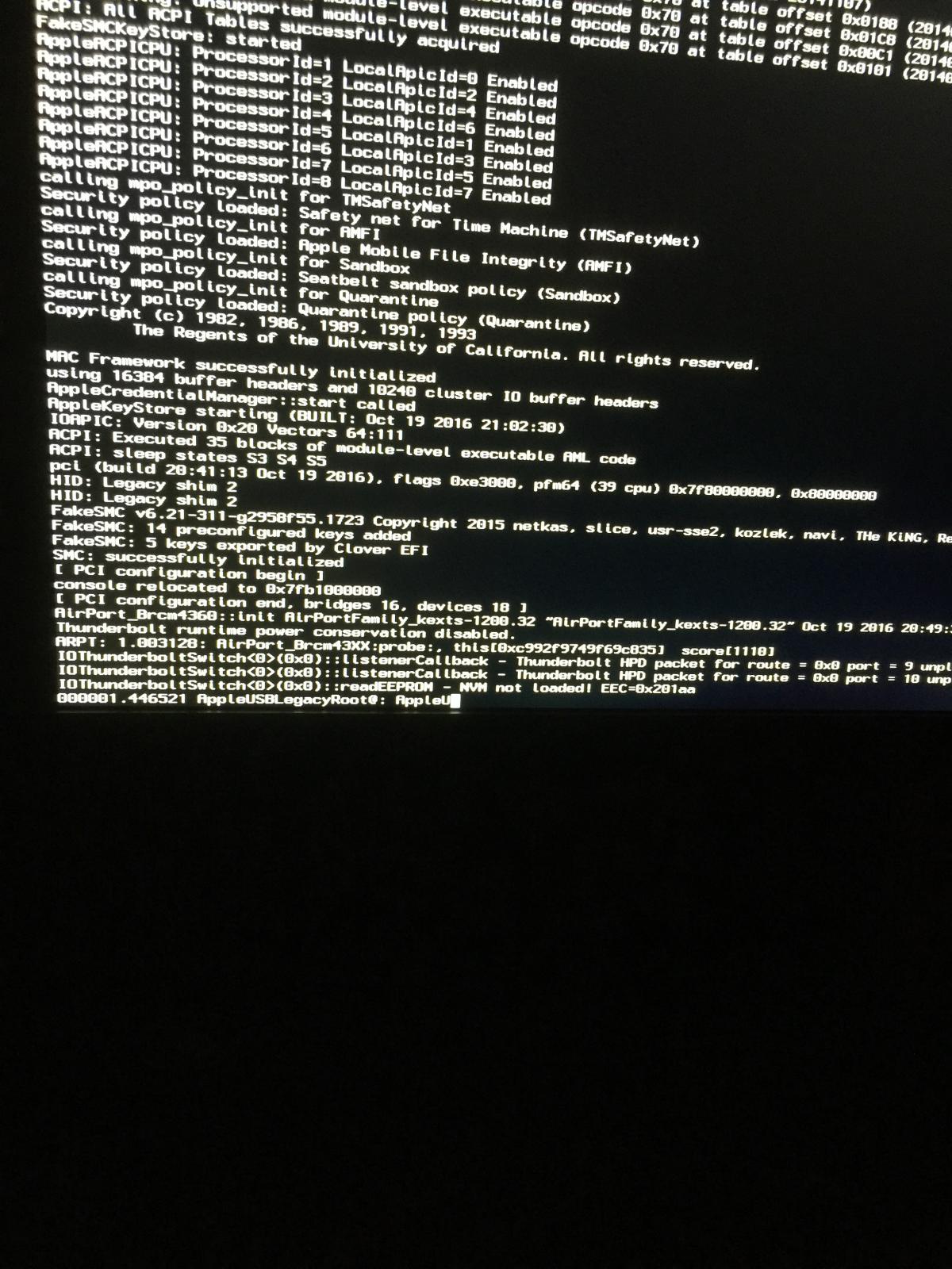

anewman143 Posted January 21, 2017 Author Share Posted January 21, 2017 I would try what Nick suggested, and you colud also check if there is a bios upgrade for your motherboard. Nick's suggestions: https://nickwoodhams.com/x99-hackintosh-osxaptiofixdrv-allocaterelocblock-error-update/amp/ So now it gets MORE interesting! Instead of trying to boot from my install USB drive, I tried to boot from my Sierra install using the -v boot flag. The boot got MUCH further along before freezing that the USB drive did! Attached is the screen shot of where the fail happens...not sure what to do next. Note: My boot SSD has not had the EFI partition modified at all - the original Aptio file is present. Link to comment https://www.insanelymac.com/forum/topic/319922-dual-nvidia-gpu-system-fails/page/2/#findComment-2353695 Share on other sites More sharing options...
bbeepp Posted February 1, 2017 Share Posted February 1, 2017 So now it gets MORE interesting! Instead of trying to boot from my install USB drive, I tried to boot from my Sierra install using the -v boot flag. The boot got MUCH further along before freezing that the USB drive did! Attached is the screen shot of where the fail happens...not sure what to do next. Note: My boot SSD has not had the EFI partition modified at all - the original Aptio file is present. This could be an issue – a Serial Port.... if you have it enabled in bios disable it. Link to comment https://www.insanelymac.com/forum/topic/319922-dual-nvidia-gpu-system-fails/page/2/#findComment-2360864 Share on other sites More sharing options...
anewman143 Posted February 1, 2017 Author Share Posted February 1, 2017 This could be an issue – a Serial Port.... if you have it enabled in bios disable it. You are correct - when I did a BIOS update (and then subsequent "down date") that setting was restored to factory which was enabled. I disabled it (along with a few other "standard" hackintosh BIOS settings) and was able to boot with just ONE GPU installed. The system runs INCREDIBLY slowly, however...not sure why yet. Clicking a menu item or dock item can take up to a minute to get an app to launch or menu item to pull down... Ideas? Link to comment https://www.insanelymac.com/forum/topic/319922-dual-nvidia-gpu-system-fails/page/2/#findComment-2360982 Share on other sites More sharing options...

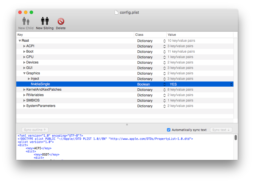

MaLd0n Posted March 6, 2017 Share Posted March 6, 2017 u can try NvidiaSingle=Yes? Inject only first one 1 Link to comment https://www.insanelymac.com/forum/topic/319922-dual-nvidia-gpu-system-fails/page/2/#findComment-2378895 Share on other sites More sharing options...
anewman143 Posted March 6, 2017 Author Share Posted March 6, 2017 Yeah, so just copy the config.plist, drivers and kext folders over. However, don't just copy the entire EFI folder, you must install Clover with the installer app first, then copy these specific files. Make sure to copy all the folders that have drivers in it over, as it could be one of these that lets your system boot. Good luck, - Matt I already have clover installed on my Sierra SSD, so is there any reason I can't just copy the EFI folder from my boot USB stick to the Sierra SSD? The guy I worked with seemed to think that was perfectly ok to do...but I'm ALWAYS happy to hear a second opinion! u can try NvidiaSingle=Yes? DaNiEl 2017-03-05 às 21.54.14.png Inject only first one See above - got the system working and booting just fine with both GPU's in place and powered. Now just working out booting directly from the SSD with Sierra instead of my boot USB stick...but think I have that one solved too...stay tuned and thanks for the idea! 1 Link to comment https://www.insanelymac.com/forum/topic/319922-dual-nvidia-gpu-system-fails/page/2/#findComment-2379068 Share on other sites More sharing options...
