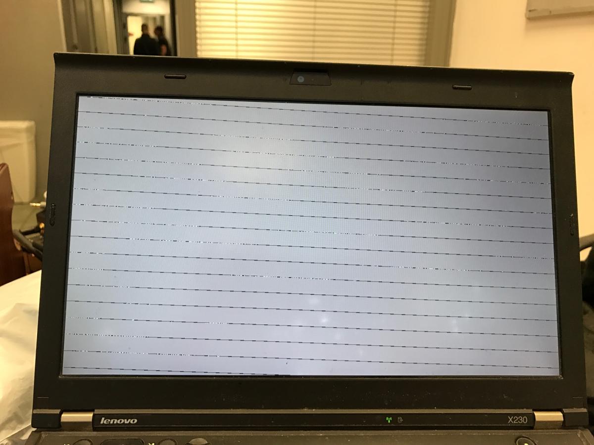

bennybar1 Posted December 4, 2016 Share Posted December 4, 2016 Hi Guys, i get this attached annoying screen. any tips? i'm using clover with EFI and. graphics card is intel HD 4000 Link to comment https://www.insanelymac.com/forum/topic/318863-cant-get-started-on-lenovo-x230/ Share on other sites More sharing options...

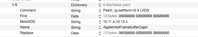

artur_pt Posted December 4, 2016 Share Posted December 4, 2016 hello possible solutionuse ig-platform-id 0x01660004and this patch in clover good hack Link to comment https://www.insanelymac.com/forum/topic/318863-cant-get-started-on-lenovo-x230/#findComment-2329272 Share on other sites More sharing options...
bennybar1 Posted December 5, 2016 Author Share Posted December 5, 2016 thank, removing inject edid fixed it Link to comment https://www.insanelymac.com/forum/topic/318863-cant-get-started-on-lenovo-x230/#findComment-2329583 Share on other sites More sharing options...
