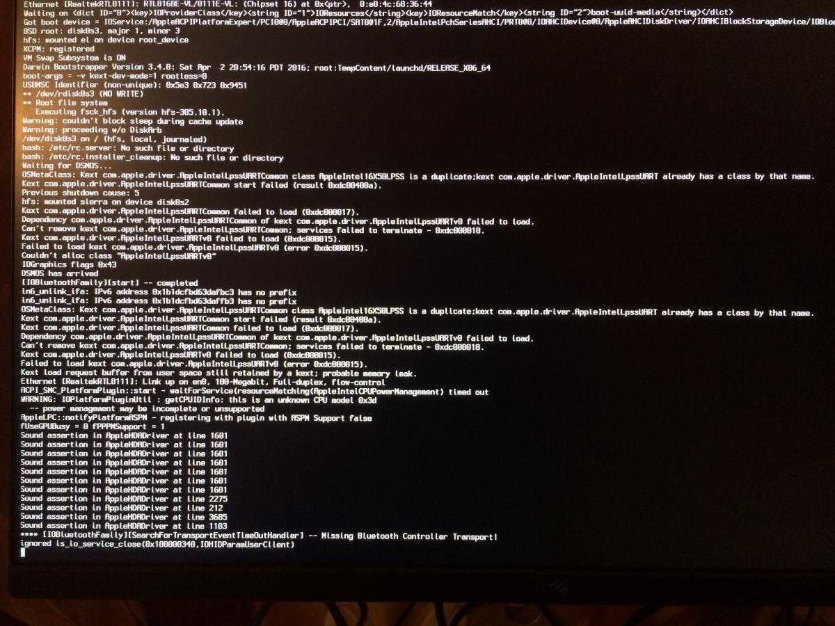

shaburshunchik Posted September 26, 2016 Share Posted September 26, 2016 Hello guys!. I bought mini pc with i5 5250u from aliexpress - it has 2 hdmi outputs,(hd6000) won't work properly via HDMI - I got video 7mb (when inject 0x16260006 via clover) or black screen when patching 16260004 from SSDT-GPU-HD6000.aml (but when I connected via VNC - it seems work, please see video https://www.youtube.com/watch?v=hgNSp0mJNNY please help me to fix hdmi output from i5 5250u hd6000os: el capitan or sierra - same troubledsdt and other stuff in EFI/CLOVER/ACPI/origin EFI.zip Link to comment https://www.insanelymac.com/forum/topic/316002-intel-hd6000-i5-5250u-wont-run-via-hdmi/ Share on other sites More sharing options...
shaburshunchik Posted September 30, 2016 Author Share Posted September 30, 2016 tried to edit AppleIntelBDWGraphicsFramebuffer binary for macbook air 7,2 to all output hdmi - nothing changed please help or give me right direction what can I do more Link to comment https://www.insanelymac.com/forum/topic/316002-intel-hd6000-i5-5250u-wont-run-via-hdmi/#findComment-2289609 Share on other sites More sharing options...
rrprime Posted March 17, 2017 Share Posted March 17, 2017 Hey, 0x1626, 0x162b, 0x1622, 0, Package() { "AAPL,ig-platform-id", Buffer() { 0x06, 0x00, 0x26, 0x16 }, "hda-gfx", Buffer() { "onboard-1" }, }, 0) remove all changes you made to any OSX files 0.5) get the latest clover 1) You have a few options here 0x06, 0x00, 0x26, 0x16 try all of them 2) Try and let Clover inject the id on it's own 3) inject the EDID even though it is blank 4) try the other video plugs of the device it is not related to the eglobal system, this is a normal GFX hackintosh issue Link to comment https://www.insanelymac.com/forum/topic/316002-intel-hd6000-i5-5250u-wont-run-via-hdmi/#findComment-2386131 Share on other sites More sharing options...
shaburshunchik Posted March 22, 2017 Author Share Posted March 22, 2017 Hey, 0x1626, 0x162b, 0x1622, 0, Package() { "AAPL,ig-platform-id", Buffer() { 0x06, 0x00, 0x26, 0x16 }, "hda-gfx", Buffer() { "onboard-1" }, }, 0) remove all changes you made to any OSX files 0.5) get the latest clover 1) You have a few options here 0x06, 0x00, 0x26, 0x16 try all of them 2) Try and let Clover inject the id on it's own 3) inject the EDID even though it is blank 4) try the other video plugs of the device it is not related to the eglobal system, this is a normal GFX hackintosh issue Thanks for reply I tried all of this with no luck, what can I do more ? BTW I checked (via VNC) situation when gpu recognize (hd6000 1536mb) but window server not run, and find that acceleration quartz QE /CI not working ;( my last efi with configs my last efi with configs EFI 2.zip Link to comment https://www.insanelymac.com/forum/topic/316002-intel-hd6000-i5-5250u-wont-run-via-hdmi/#findComment-2389541 Share on other sites More sharing options...
