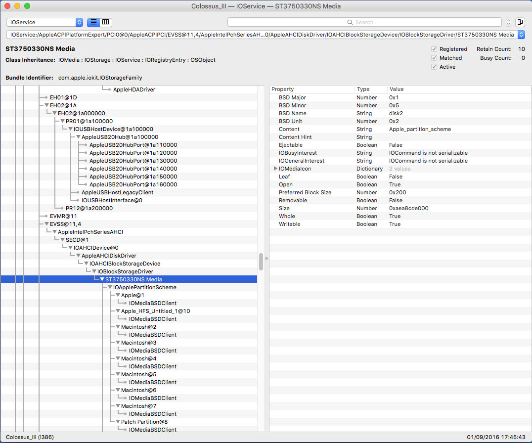

bengal stripes Posted September 1, 2016 Author Share Posted September 1, 2016 Thanks, Allan. I do have Hot Swap turned on in the BIOS. On my last machine it wasn't a problem. It also worked OOB. That was a GA-X79-UD3 running Mountain Lion. This Asus X99a doesn't want to know! Here is a screen capture of IOREG. Link to comment https://www.insanelymac.com/forum/topic/314802-hot-swap-sata-on-x99/#findComment-2272516 Share on other sites More sharing options...

bengal stripes Posted September 8, 2016 Author Share Posted September 8, 2016 I solved my problem. My eSATA enclosure was faulty. I connected drive directly to my MOBO and it worked just fine. I connected my eSATA enclosure to another computer and it didn't connect. Thanks everyone for trying to help. Link to comment https://www.insanelymac.com/forum/topic/314802-hot-swap-sata-on-x99/#findComment-2275102 Share on other sites More sharing options...
