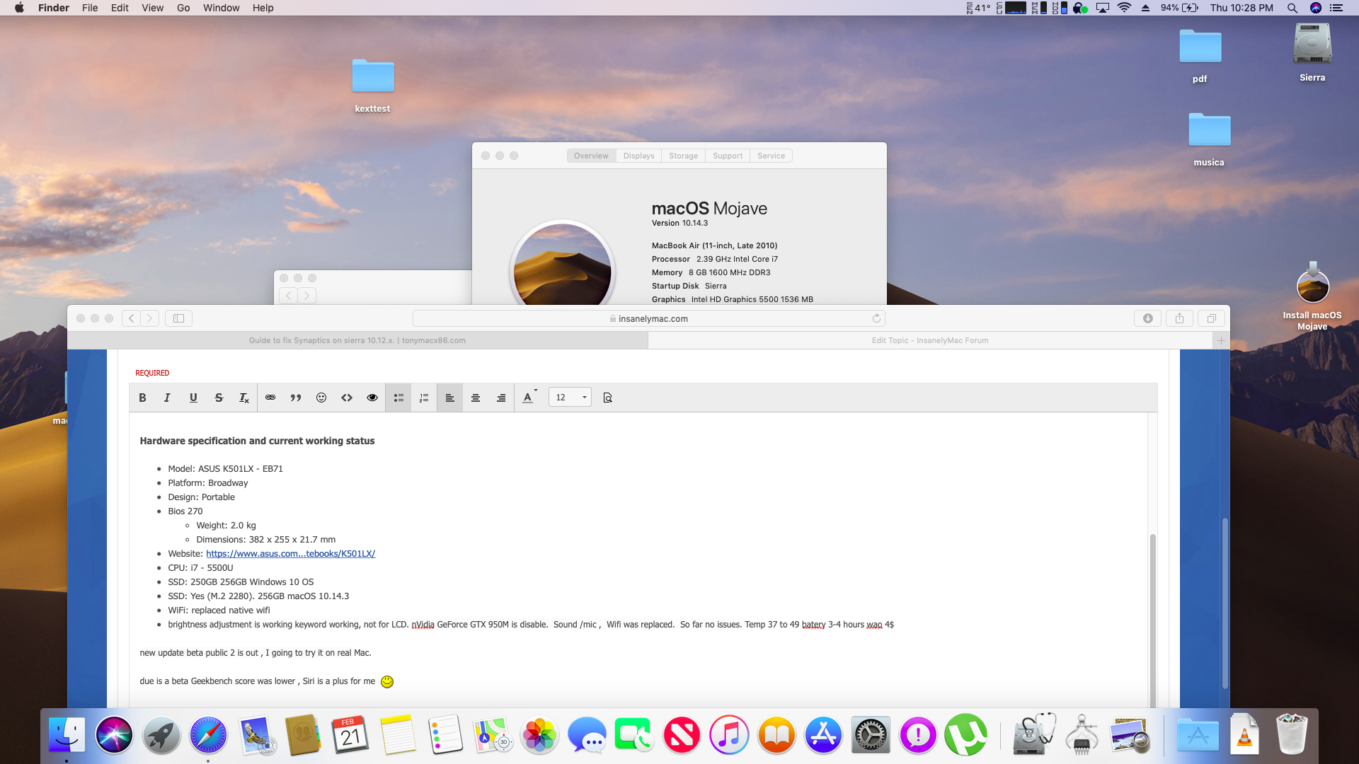

iAstroboyid Posted July 23, 2016 Share Posted July 23, 2016 (edited) All the credits goes to the guide by Nguyenic1993 [GUIDE] Installing El Capitan on ASUS K501LX http://www.insanelymac.com/forum/topic/312356-guide-installing-el-capitan-on-asus-k501lx/ I was able to install macOS Sierra public beta 10.12 with the clover_v2.3k_r3640, new just came out clover_v2.3k_r3650. Using his guide and his patched DSDT. I was on Sierra for a long time, decided to give a try Mojave due i love it on my old iMac . Hardware specification and current working status Model: ASUS K501LX - EB71 Platform: Broadway Design: Portable Bios 270 Weight: 2.0 kg Dimensions: 382 x 255 x 21.7 mm Website: https://www.asus.com...tebooks/K501LX/ CPU: i7 - 5500U SSD: 250GB 256GB Windows 10 OS SSD: Yes (M.2 2280). 256GB macOS 10.14.3 APFS WiFi: replaced native wifi brightness adjustment keyword working, not for LCD. nVidia GeForce GTX 950M is disable. Sound /mic , Wifi was replaced. So far no issues. Temp 37 to 49 batery 3-4 hours. Make sure to add ApfsDriverloader-64 to boot. All the kext my config.pl9st is incluted. you may need to not install ApplePS2SmartTouchpad.kext i deleted caused problems. now is about %95 working due unable to adjust LCD brightness. Sleep is working with HibernationFixup. to anable sound lilu.kext is required with AppleALC. takes longer to load due to the new Apfs. updated to Clover_Clover_v2.4k_r4871. config.plist.zip i7-5500U.zip DSDT.aml.zip patched.zip HibernationFixup.kext.zip 10.14.zip Edited February 22, 2019 by iAstroboyid macOS 10.4.3 installed 2 Link to comment Share on other sites More sharing options...
