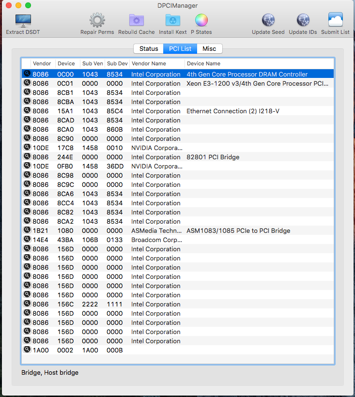

Andrew Wickett Posted May 23, 2016 Author Share Posted May 23, 2016 This is what DPCIManager shows. Can you please tell me which listing I should be looking at ? Cheers Quote Link to comment https://www.insanelymac.com/forum/topic/312295-asus-z97-a-no-usb-3/#findComment-2239898 Share on other sites More sharing options...

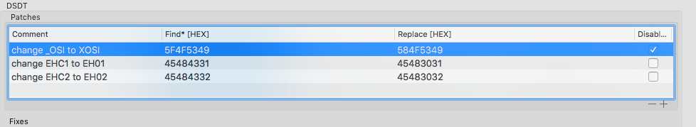

Allan Posted May 23, 2016 Share Posted May 23, 2016 Apply this patch in your config.plist: Comment: change 15 port limit to 20 in AppleUSBXHCIPCI Name: AppleUSBXHCIPCI Find: <83bd8cfe ffff10> Replace: <83bd8cfe ffff15> And, download the USBInjectAll.kext, put in EFI/CLOVER/kexts. Run this command: sudo nvram -c Reboot and see what happens. Quote Link to comment https://www.insanelymac.com/forum/topic/312295-asus-z97-a-no-usb-3/#findComment-2239899 Share on other sites More sharing options...

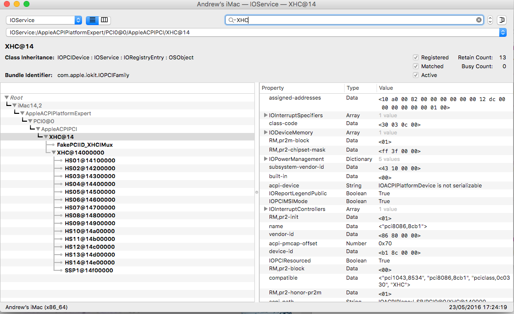

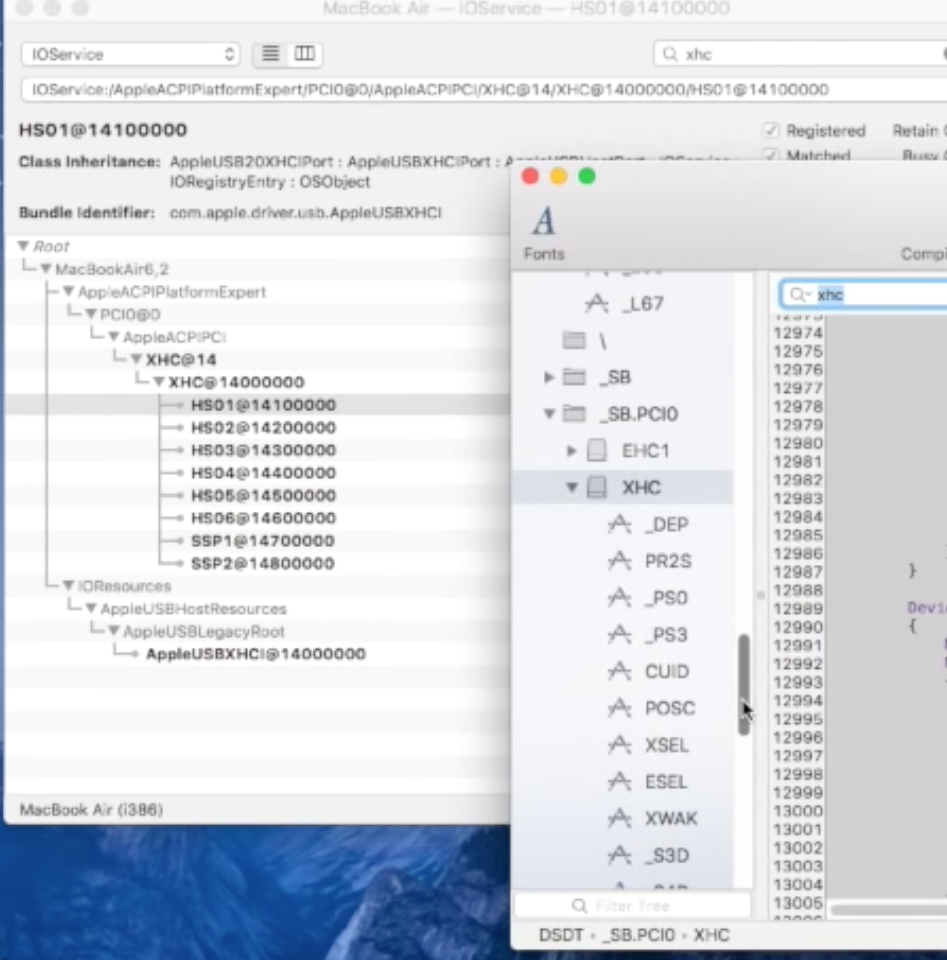

Andrew Wickett Posted May 23, 2016 Author Share Posted May 23, 2016 This is the IORegistry list. It says there is a FakePCIID_XHCIMux unlike this guys in his Youtube video. Both screenshots attached. Thanks again Quote Link to comment https://www.insanelymac.com/forum/topic/312295-asus-z97-a-no-usb-3/#findComment-2239900 Share on other sites More sharing options...
Allan Posted May 23, 2016 Share Posted May 23, 2016 Unistall FakePCIID + FakePCIID_XHCIMux, and use the kext that i've told you. Is a test. But pay attention in the note: Do not plan to use the patch long-term. It could be problematic. If you have more than 15 ports on XHC, you should use FakePCIID_XHCIMux to route the USB2 component of those USB3 ports to EHCI. It is easy to stay under the limit if up to 8-USB2 ports are routed off XHC. Quote Link to comment https://www.insanelymac.com/forum/topic/312295-asus-z97-a-no-usb-3/#findComment-2239905 Share on other sites More sharing options...

Andrew Wickett Posted May 23, 2016 Author Share Posted May 23, 2016 I'm more confused than ever after reading through that lot. They don't explain the basics. I can not find out: What version my chipset is although I have found out that it's the same as the. Where to apply the patches (I can see the fields: comment, find and replace but not the name field) Quote Link to comment https://www.insanelymac.com/forum/topic/312295-asus-z97-a-no-usb-3/#findComment-2239959 Share on other sites More sharing options...
Allan Posted May 23, 2016 Share Posted May 23, 2016 Bro, the DSDT patches already contains the correct local to apply. You just need download the tool, copy/paste the Repos, and click in "Apply" done! Can you explain what "have them in DSDT" means please? You use DSDT? If not, don't worry. Also do I install the USBinjectAll.kext from Debug or Release folder? Your choice. Do I put them in 10.11 or 'Other folder? Your choice. Also do I apply the patch in clover configurator> Kernel and Kext Patches page or Acpi page This field just exists in Kernel and Kext Patches, in ACPI you don't have the option to apply patches in kexts. Don't know why you do this question.... Quote Link to comment https://www.insanelymac.com/forum/topic/312295-asus-z97-a-no-usb-3/#findComment-2239961 Share on other sites More sharing options...
Andrew Wickett Posted May 23, 2016 Author Share Posted May 23, 2016 Ok I'll do that. Thanks again I did it and my usb 2 port is now listed as USB 3 Quote Link to comment https://www.insanelymac.com/forum/topic/312295-asus-z97-a-no-usb-3/#findComment-2239962 Share on other sites More sharing options...
Andrew Wickett Posted May 24, 2016 Author Share Posted May 24, 2016 Ok so that didn't work. Can I just disable the patch in clover? Quote Link to comment https://www.insanelymac.com/forum/topic/312295-asus-z97-a-no-usb-3/#findComment-2240018 Share on other sites More sharing options...
