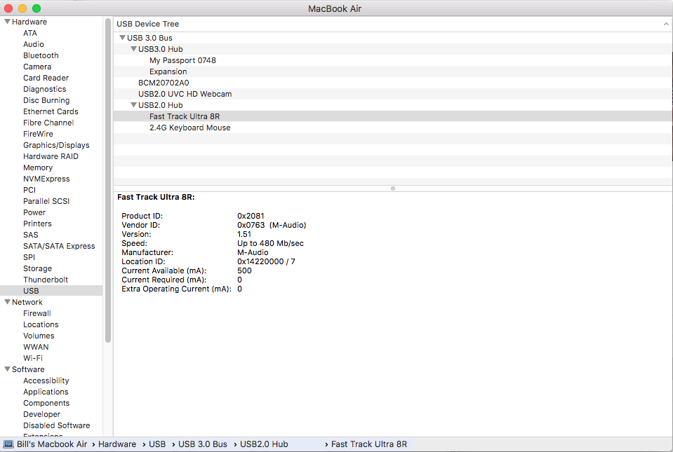

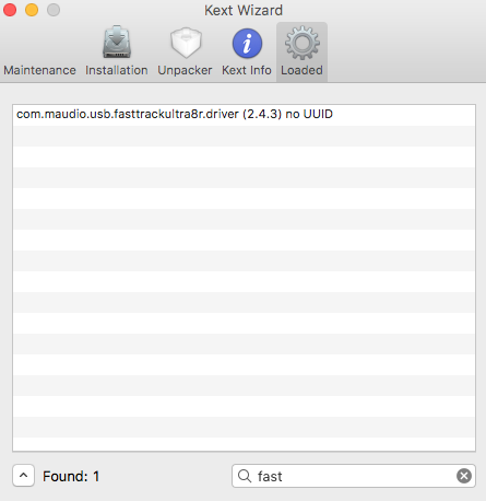

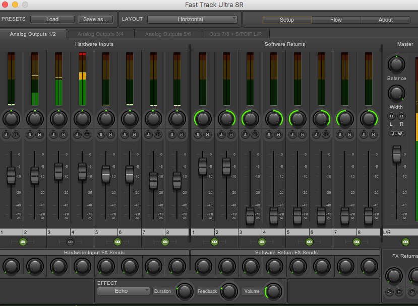

oliveiro Posted October 1, 2016 Author Share Posted October 1, 2016 Hi Bill, I checked the file from your SIerra registry, strangely, it looks similar, as far as the FTU is concerned, to an untouched ElCapitan registry (ie with a failing FTU), with the same symptoms as the ones described in that post. But as shown in your post's attached screen captures, the control panel detects the FTU : so OsX Sierra (partially) loads the driver. Maybe the failure is related to the "no UUID" shown in your KextWizard window. It's weird that the control panel is able to show sound modulating on the meters, because to my limited understanding, it requires the driver to be properly interacting with OsX USB drivers. Why you "see" sound, and don't hear it, I could not tell... sorry. I guess the workarounds we use in ElCapitan will work the same for Sierra. To be tested. But as I wrote before, I'm afraid I won't be able to install and test Sierra before spring next year. Don't hesitate to post here, if you do other tests, I'll try to help. Cheers! Link to comment https://www.insanelymac.com/forum/topic/312132-m-audio-avid-fast-track-ultra-el-capitan-workaround/page/2/#findComment-2290566 Share on other sites More sharing options...

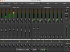

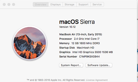

mcshmoopy Posted October 5, 2016 Share Posted October 5, 2016 Wow you guys have been hard at work! Im very impressed I tried to extract a Yosemite IOAudioFamily but Im not very good at using pacificst so the one I created I dont think was correct. Would any of you fine gents be able to provide me with a Yosemite IOAudioFamily? Ill be able to test to see if I can get audio working then Link to comment https://www.insanelymac.com/forum/topic/312132-m-audio-avid-fast-track-ultra-el-capitan-workaround/page/2/#findComment-2293746 Share on other sites More sharing options...

mcshmoopy Posted October 7, 2016 Share Posted October 7, 2016 Hi Bill ! Here's a Yosemite 10.10.5 version. Good luck ! IOAudioFamily.kext.zip Thanks for the kext! No luck still Im afraid, looks like this could be it for Sierra Link to comment https://www.insanelymac.com/forum/topic/312132-m-audio-avid-fast-track-ultra-el-capitan-workaround/page/2/#findComment-2295388 Share on other sites More sharing options...
oliveiro Posted October 9, 2016 Author Share Posted October 9, 2016 Hey Bill (& Diooo), thanks for trying... So, to sum things up, on SIerra you tested : - genuine system - genuine with modified IOUSBHostFamily only (Yosemite AppleUSB*HCI) - genuine with only IOAudioFamily from Yosemite Were results always the same ? Maybe try IOaudioFamily.kext from ElCapitan, it might be worth it on a genuine Sierra, and then if it fails, on genuine Sierra with a modified IOUSBHostFamily (yosemite files). Finally , did you try replacing all USB kexts with yosemite files (if Sierra USB files look the same as ElCapitan's) ? That's all I can think of for now. Thanks ! PS : what are the benefits/improvements between ElCapitan & SIerra (speed ? stability? GUI ?) 1 Link to comment https://www.insanelymac.com/forum/topic/312132-m-audio-avid-fast-track-ultra-el-capitan-workaround/page/2/#findComment-2296348 Share on other sites More sharing options...
mcshmoopy Posted October 11, 2016 Share Posted October 11, 2016 Hey Bill (& Diooo), thanks for trying... So, to sum things up, on SIerra you tested : - genuine system - genuine with modified IOUSBHostFamily only (Yosemite AppleUSB*HCI) - genuine with only IOAudioFamily from Yosemite Were results always the same ? Maybe try IOaudioFamily.kext from ElCapitan, it might be worth it on a genuine Sierra, and then if it fails, on genuine Sierra with a modified IOUSBHostFamily (yosemite files). Finally , did you try replacing all USB kexts with yosemite files (if Sierra USB files look the same as ElCapitan's) ? That's all I can think of for now. Thanks ! PS : what are the benefits/improvements between ElCapitan & SIerra (speed ? stability? GUI ?) Tbh I dont think there are many benefits from going to Sierra aside from a few gimmicky apple features. I just like everything working on the latest software and what not! Ive actually managed to buy a brand new Tascam US 16x08 which is class compliant and working without drivers now! Ill still be keeping my Fast Track Ultra 8R and when I get some time Ill see if I can go over all the workarounds you listed off again and see if we can be successful! Link to comment https://www.insanelymac.com/forum/topic/312132-m-audio-avid-fast-track-ultra-el-capitan-workaround/page/2/#findComment-2297608 Share on other sites More sharing options...
