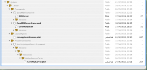

For those who might be interested, I enabled my Fast Track Ultra in El Capitan (10.11.4) by simply reversing IOUSBFamily.kext and IOUSBHostFamily.kext, to only one IOUSBFamily.kext from a Yosemite drive (10.10.4).
Had also to backup few kexts related to USB storage and networking which prevented kernel to prelink correctly.
It might be relevant to reverse AppleUSBMassStorage kexts to try to avoid these depedencies problems.
So Fast Track Ultra Control Panel is fully functionnal, as in Yosemite.

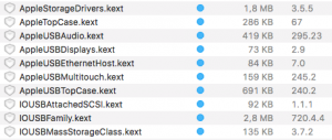

I've had more time to further experiment : my attempts to modify the Fast Track Ultra drivers all failed.
But I've found another way, much cleaner, much lighter. I suspected the M-Audio driver was not using the whole IOUSBFamily and plugins, and checking the IoRegistry in Yosemite I saw that the M-Audio kext was simply relying on AppleUSBXHCI.kext (found inside the Plugins folder of IOUSBFamily.kext in Yosemite).
My system is USB 3.0 based, so it's using XHCI, maybe older systems are relying on older EHCI OHCI or UHCI. So I did the following modifications on the attached file : this is a IOUSBHostFamily.kext from a clean install of ElCapitan 10.11.5 :
  • I removed AppleUSBEHCI.kext, AppleUSBEHCIPCI.kext, AppleUSBOHCI.kext, AppleUSBOHCIPCI.kext, AppleUSBUHCI.kext, AppleUSBUHCIPCI.kext, AppleUSBXHCI.kext, AppleUSBXHCIPCI.kext from Plugins folder.
  • I added previous Yosemite versions of AppleUSBEHCI.kext, AppleUSBOHCI.kext, AppleUSBUHCI.kext, AppleUSBXHCI.kext (taken from IOUSBFamily.kext Plugins folder, from a clean install of Yosemite 10.10.5) inside Plugins folder.
You can do the mods yourself, or use the attached file. Remember, if you're not familiar with kext installation or modification, do backup first, especially if you're trying this on your main system. This is for ElCapitan 10.11.5.

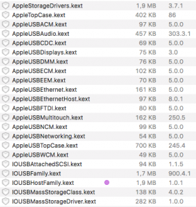

Managed to figure it out!
I basically went back to the El Capitan kext and used Kext Wizard to see which kexts were loaded when bluetooth was functional, so I figured out I have to revert IOBluetoothFamily to Yosemite's version to get it working. I did this but nothing, but I tried using a bluetooth firmware uploader kext specifically for Yosemite instead and not the El Capitan version I had and voila! Working as normal.

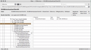

I removed all the Fast Track Ultra (FTU) drivers/files from M-Audio and reverted back to the original (El Capitan) IOUSBHostFamily.kext. When I booted, I simply plugged in (USB) the Fast Track Ultra and the midi was fully working, but no FTU audio. So, I have two scenarios:
1. Midi Working, FTU Audio not working: Latest Avid/Maudio drivers removed and the El Capitan IOUSBHostFamily.kext.
2. Midi not working, FTU Audio working: Latest Avid/Maudio drivers installed and Yosimite IOUSBHostFamily.kext installed.
I do not think that audio or midi was working with the El Capitan IOUSBHostFamily.kext and the Avid/Maudio drivers installed, but will try that next again, for completeness.
Any suggestions on how to get both working in El Capitan? Is there a way to understand where to keep the appropriate references in the IOUSBHostFamily.kext? I opened the file contents, however, not sure if I could edit it correctly by modifying the text entries in the contents.
Any help would be greatly appreciated!!

Using IoregistryExplorer.app, here's what the device looks like in Yosemite
The selected item is missing in ElCapitan.
Here are the occurrences of midiserver among system folders in Yosemite
I suppose the possible resolution of this midi problem lies in reversing the ElCapitan Coremidi & Coremidiserver frameworks (experimenting and checking for dependency problems is required). Otherwise, investigating around IOUserClientCreator and IOUSBInterfaceUserClient might be a lead (and might require the procedure of first workaround : full IOUSBFamily replacement (see post #2)

I noticed problems with the help of IOregistryExplorer : IOUSBuserclient seems to be broken when using the workaround described in Post10.
Which prevents the Fast Track Ultra MIDI port to be correctly configured by OsX.

I removed (and backed up as usual) the following files from ElCapitan(10.11.5)/System/Library/Extensions/ :
And replaced them (installed with KextUtility) with the following ones from Yosemite(10.10.5)/System/Library/Extensions/ :
Some files seem to be missing from the Yosemite folder, but if you check inside the plugins folders of IOUSBFamily.kext, you'll find the related kexts.
So this is basically reversing all USB kexts to yosemite versions.
