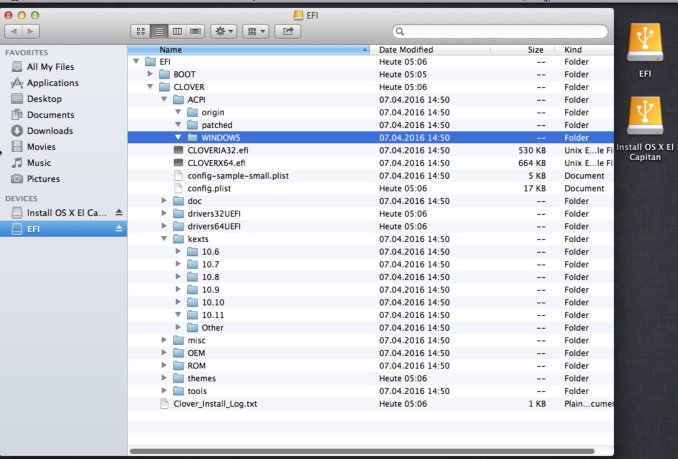

SgtSaber Posted April 12, 2016 Author Share Posted April 12, 2016 THX Now I am at step 4 Step 4: Now its time to add all the kext, patched DSDT (if you use one) and SSDT (if you use one) the required kext is FakeSMC, 10.10 shown in below pic but add a new folder and name it 10.11 for El Captian Where can I get this? I can Google four it but dont know witch is the right four my System. Or that is not system-related? Quote Link to comment https://www.insanelymac.com/forum/topic/311798-asus-x99-el-capitan-gtx-970-help-under-construction/#findComment-2231739 Share on other sites More sharing options...
Dwarfy Posted April 12, 2016 Share Posted April 12, 2016 No need for SSDTs and DSDTs for install, do that for post install. here is fakesmc. 1 Quote Link to comment https://www.insanelymac.com/forum/topic/311798-asus-x99-el-capitan-gtx-970-help-under-construction/#findComment-2231740 Share on other sites More sharing options...
Dwarfy Posted April 12, 2016 Share Posted April 12, 2016 If you have problems making a config, delete the config-sample-small.plist and the stock config.plist and then add this. 1 Quote Link to comment https://www.insanelymac.com/forum/topic/311798-asus-x99-el-capitan-gtx-970-help-under-construction/#findComment-2231745 Share on other sites More sharing options...

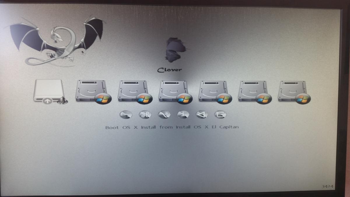

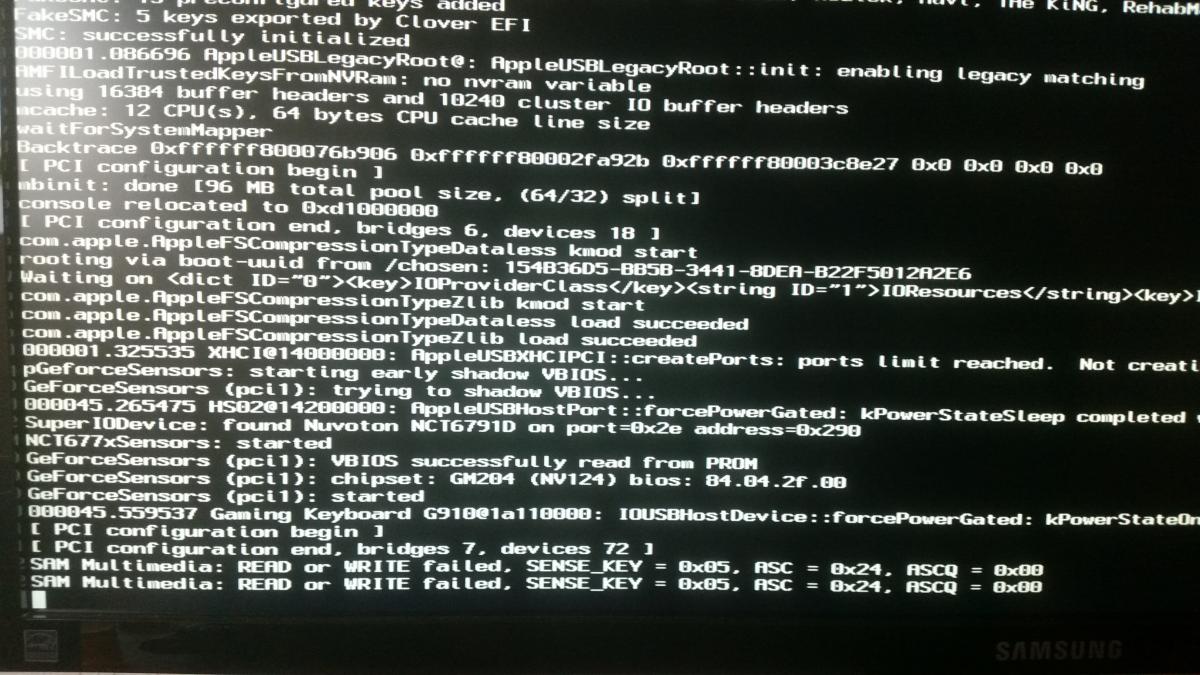

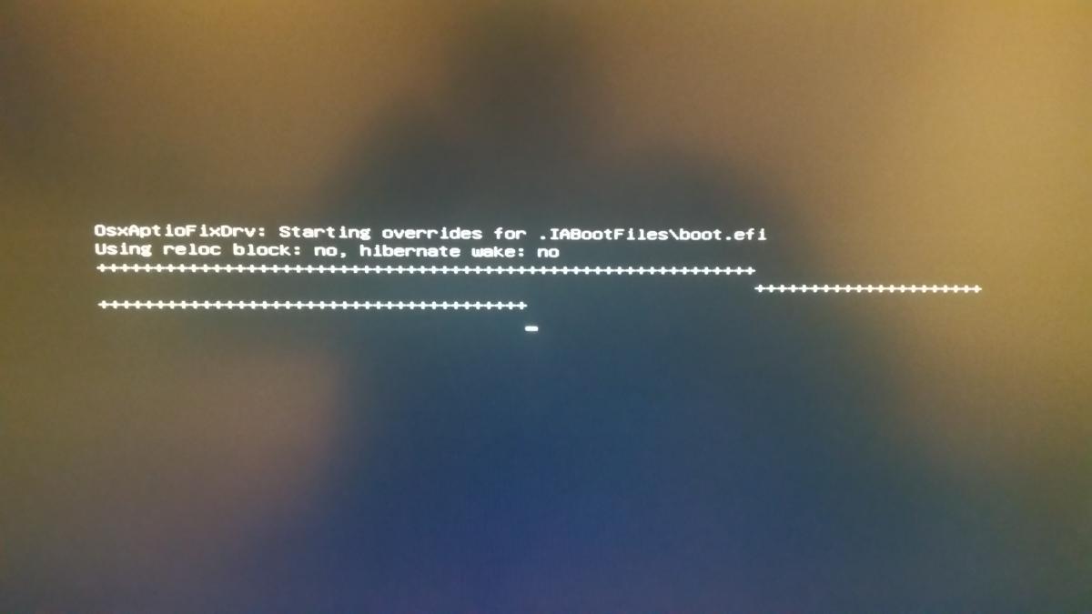

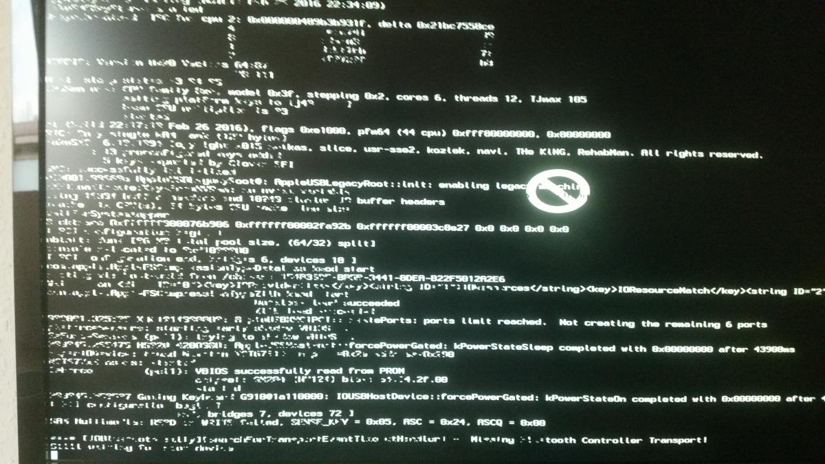

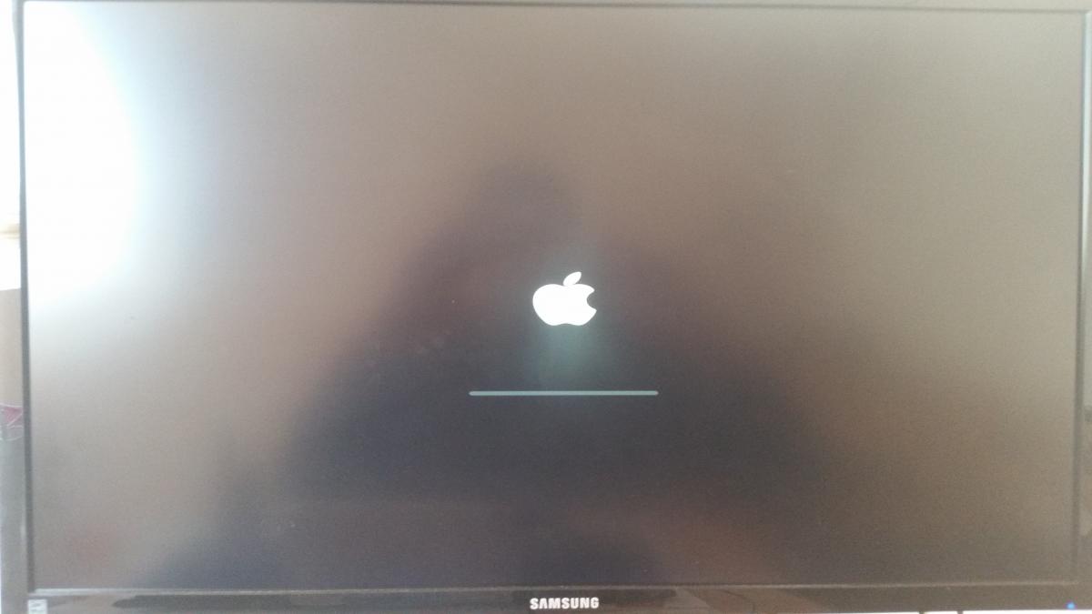

SgtSaber Posted April 12, 2016 Author Share Posted April 12, 2016 Starting / installing from USB doesn´t work. Here some pics from Clover I chose Install in Clover menue .... than comes the apple ... pc reboot Someone an Idea why I cant install? Quote Link to comment https://www.insanelymac.com/forum/topic/311798-asus-x99-el-capitan-gtx-970-help-under-construction/#findComment-2231828 Share on other sites More sharing options...

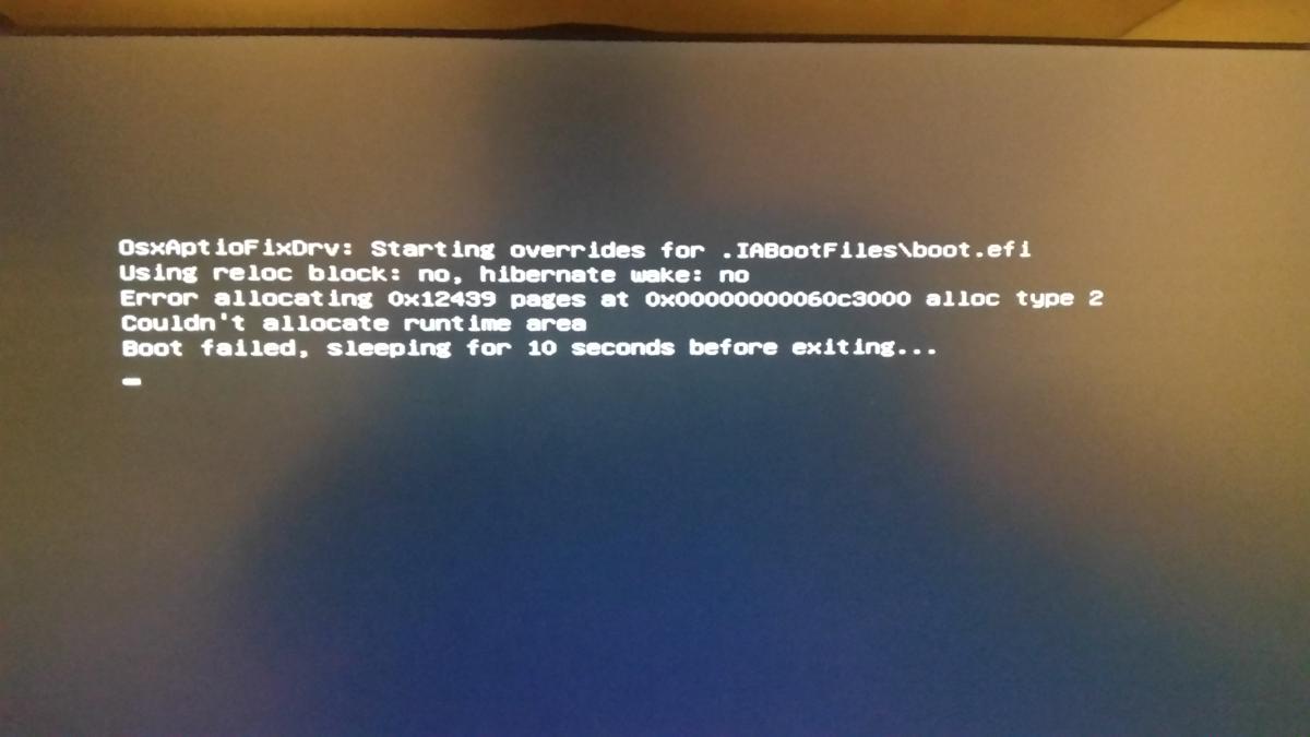

Dwarfy Posted April 12, 2016 Share Posted April 12, 2016 Is this the fake smc? HWSensors.6.19.1406.Binaries.dmg No, but it contains FakeSMC.kext Quote Link to comment https://www.insanelymac.com/forum/topic/311798-asus-x99-el-capitan-gtx-970-help-under-construction/#findComment-2231840 Share on other sites More sharing options...

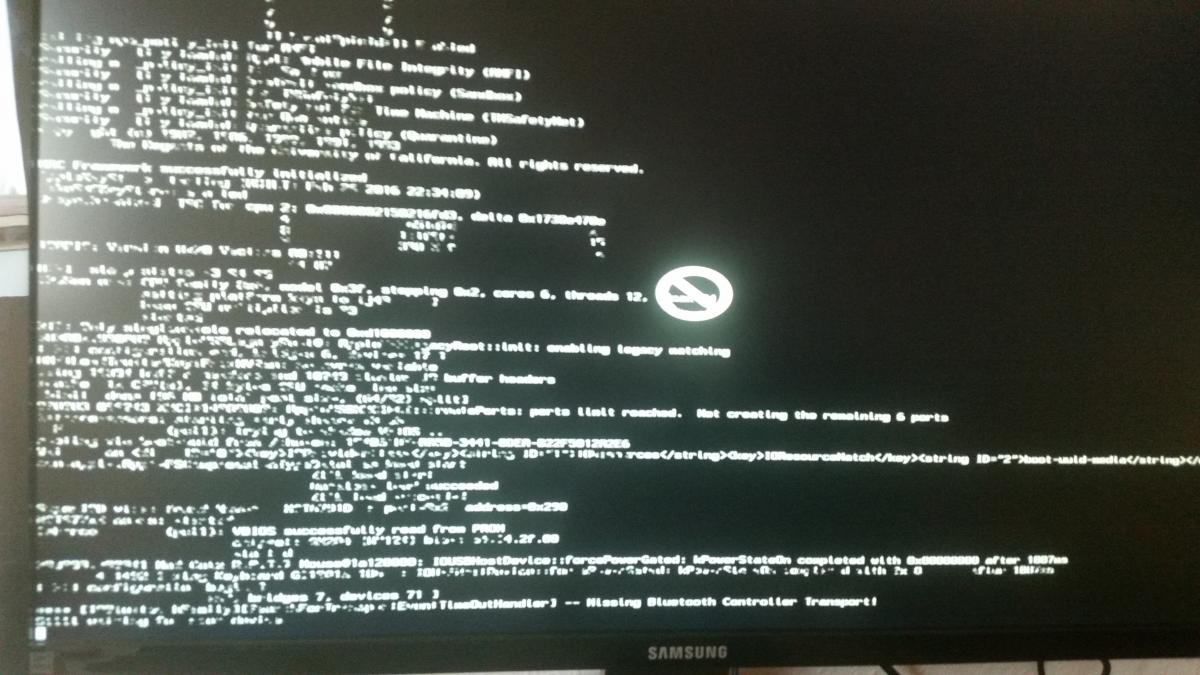

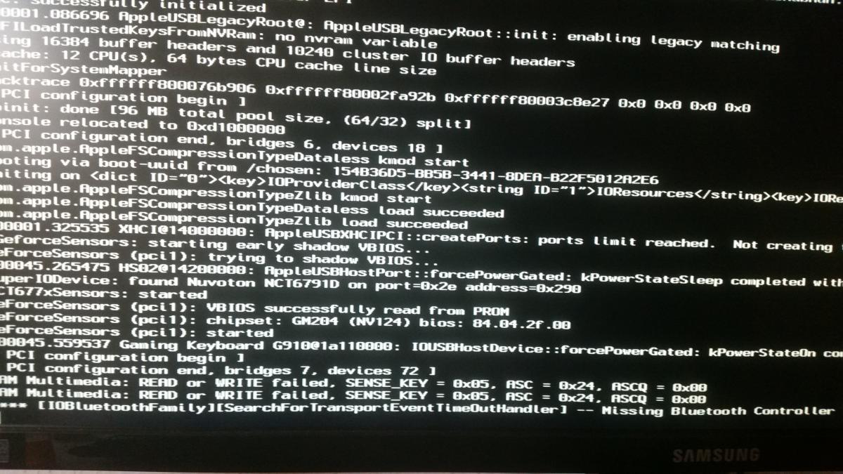

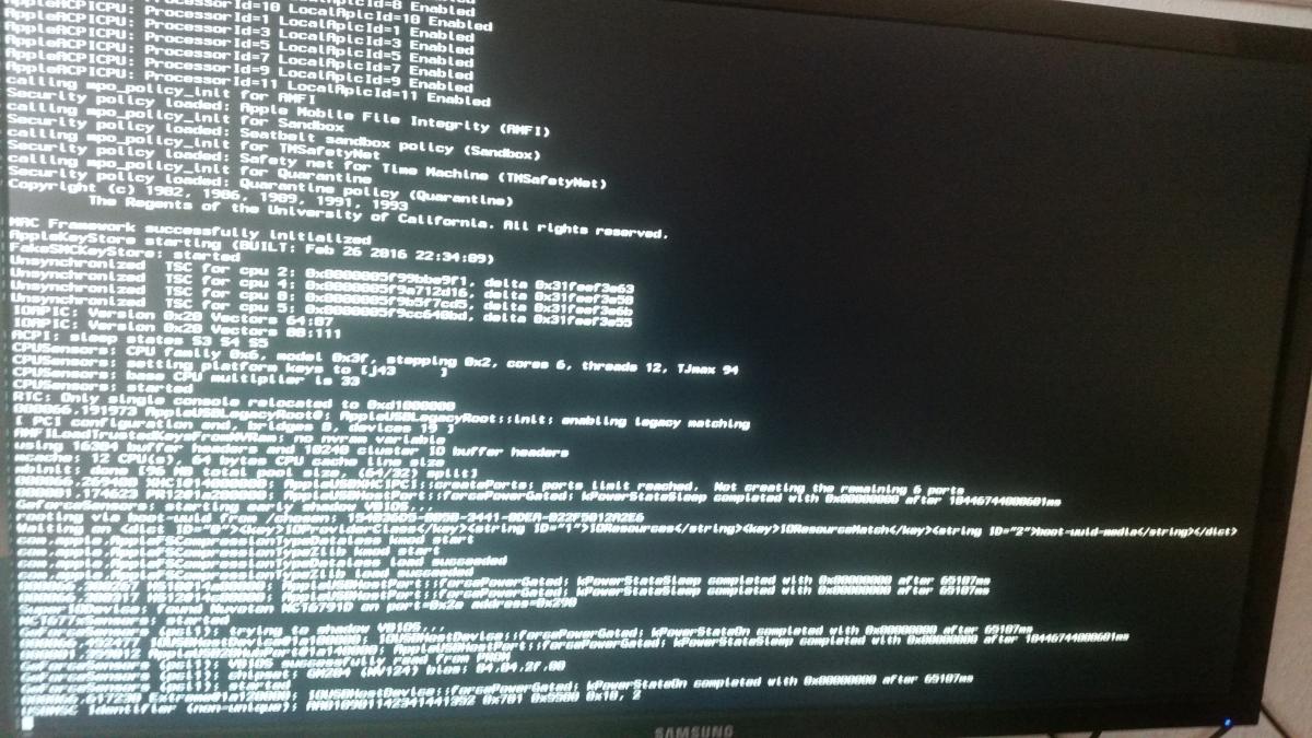

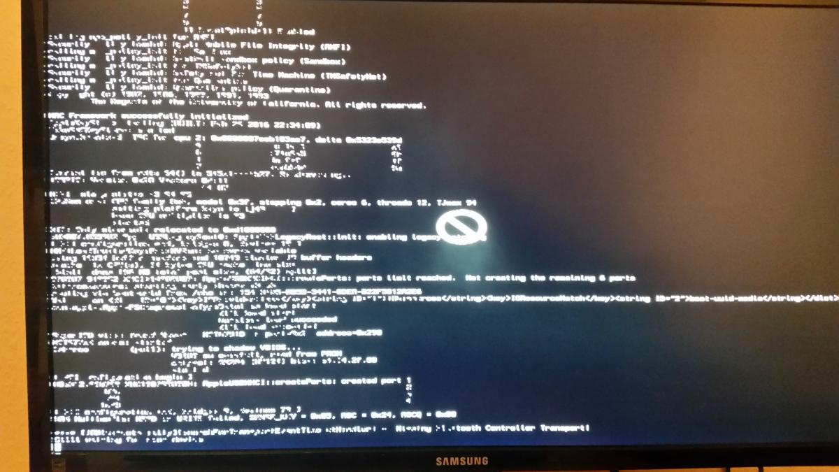

SgtSaber Posted April 12, 2016 Author Share Posted April 12, 2016 Now it looks like this .... Any Ideas? Quote Link to comment https://www.insanelymac.com/forum/topic/311798-asus-x99-el-capitan-gtx-970-help-under-construction/#findComment-2231893 Share on other sites More sharing options...
LockDown Posted April 13, 2016 Share Posted April 13, 2016 check your usb drive as you are getting SAM hence the waitting for root device 1 Quote Link to comment https://www.insanelymac.com/forum/topic/311798-asus-x99-el-capitan-gtx-970-help-under-construction/#findComment-2231956 Share on other sites More sharing options...
SgtSaber Posted April 13, 2016 Author Share Posted April 13, 2016 I dont know what u mean. IT testet in USB 2.0 and 3.0 I testet in Front USB and back side Quote Link to comment https://www.insanelymac.com/forum/topic/311798-asus-x99-el-capitan-gtx-970-help-under-construction/#findComment-2231963 Share on other sites More sharing options...
Dwarfy Posted April 13, 2016 Share Posted April 13, 2016 Try with cpus=1 try without test2.efi try changing the AptioFix 1 Quote Link to comment https://www.insanelymac.com/forum/topic/311798-asus-x99-el-capitan-gtx-970-help-under-construction/#findComment-2231967 Share on other sites More sharing options...

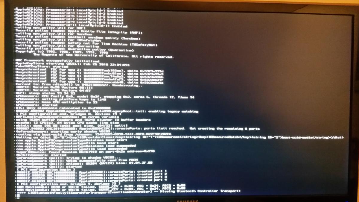

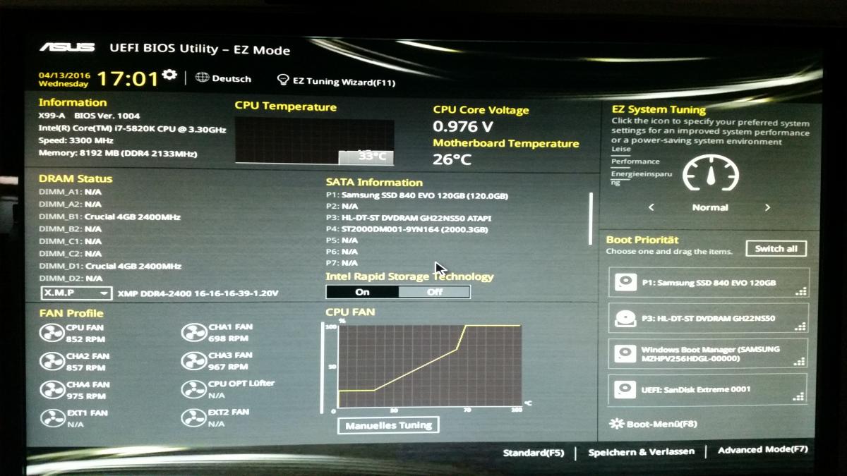

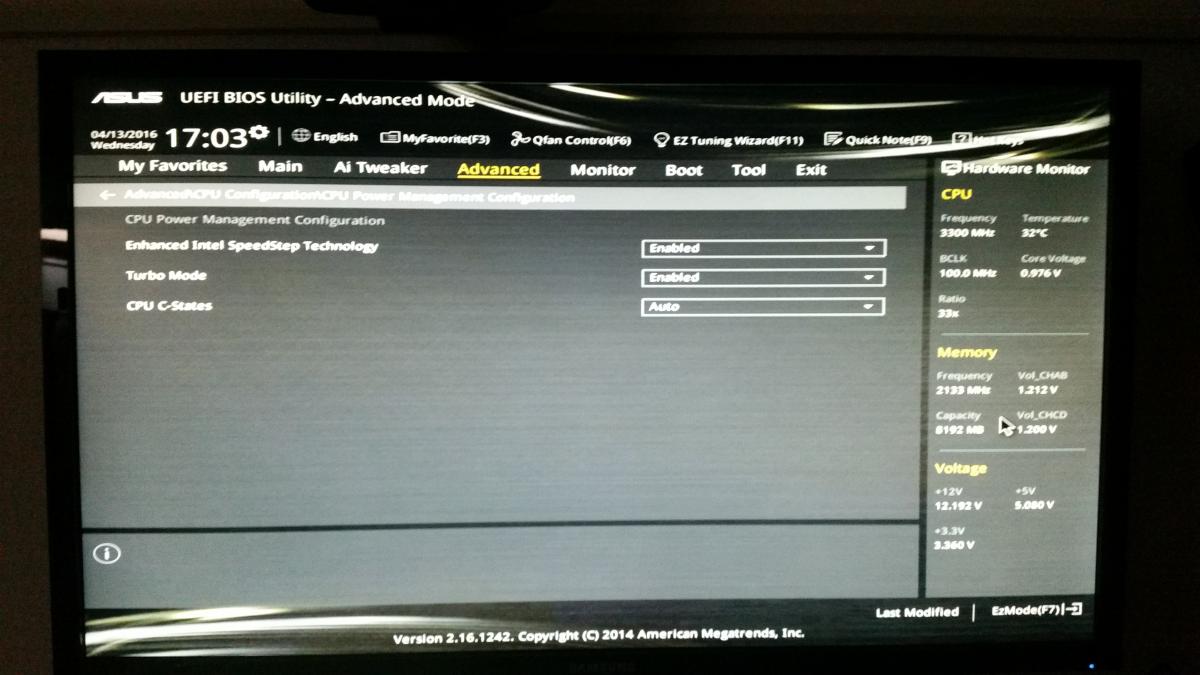

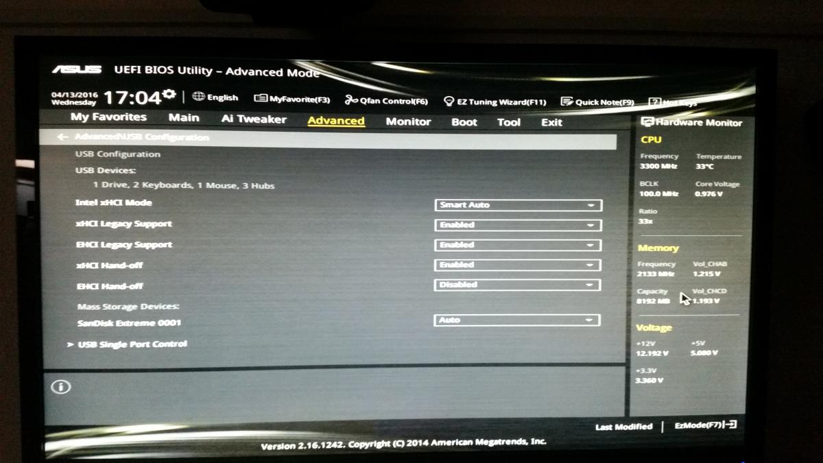

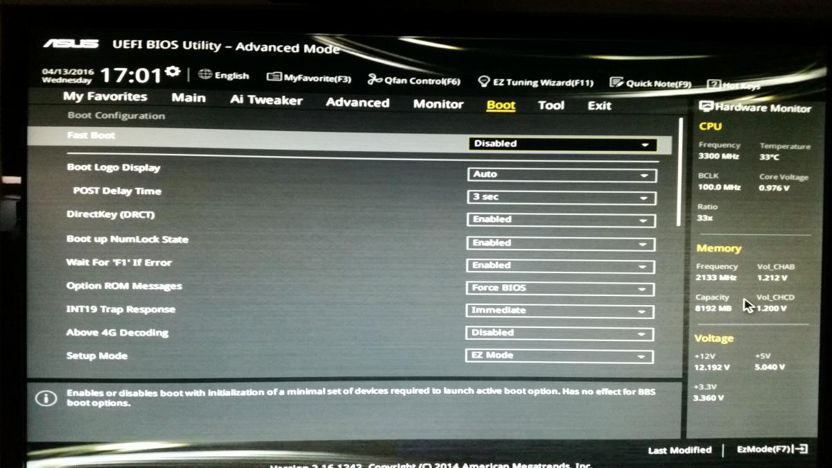

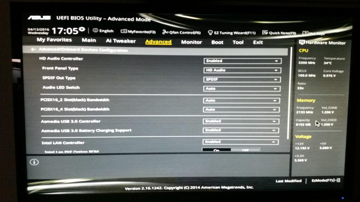

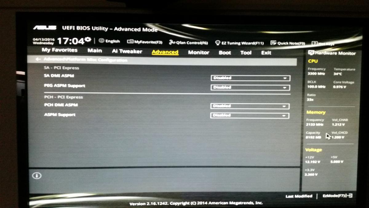

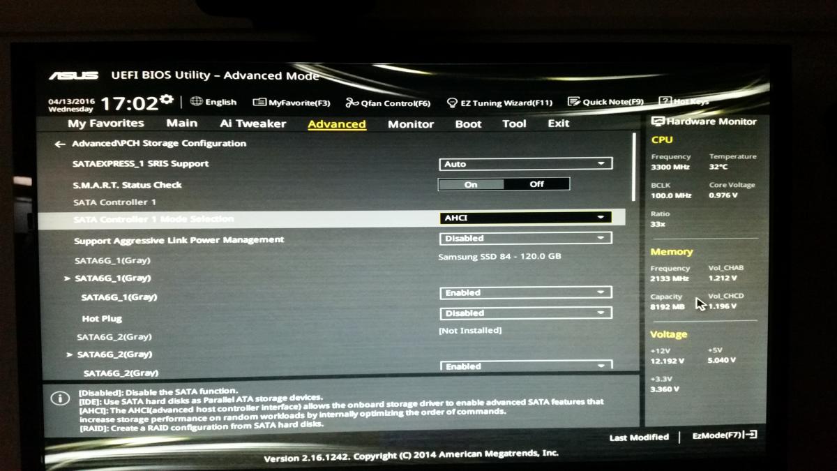

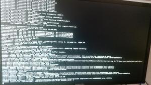

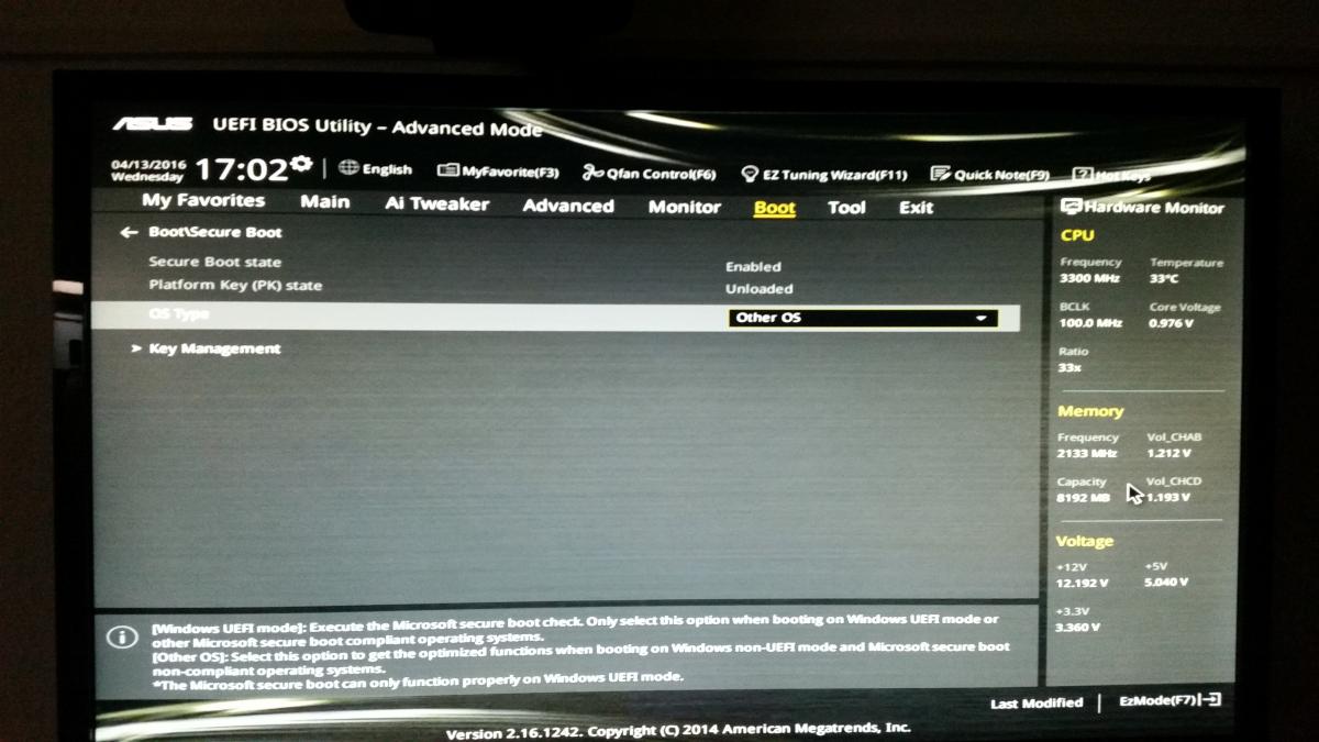

SgtSaber Posted April 13, 2016 Author Share Posted April 13, 2016 Maybe you see something wrong. Quote Link to comment https://www.insanelymac.com/forum/topic/311798-asus-x99-el-capitan-gtx-970-help-under-construction/#findComment-2232040 Share on other sites More sharing options...
Dwarfy Posted April 13, 2016 Share Posted April 13, 2016 Disable ASmedia for the install. Quote Link to comment https://www.insanelymac.com/forum/topic/311798-asus-x99-el-capitan-gtx-970-help-under-construction/#findComment-2232041 Share on other sites More sharing options...

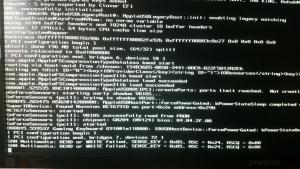

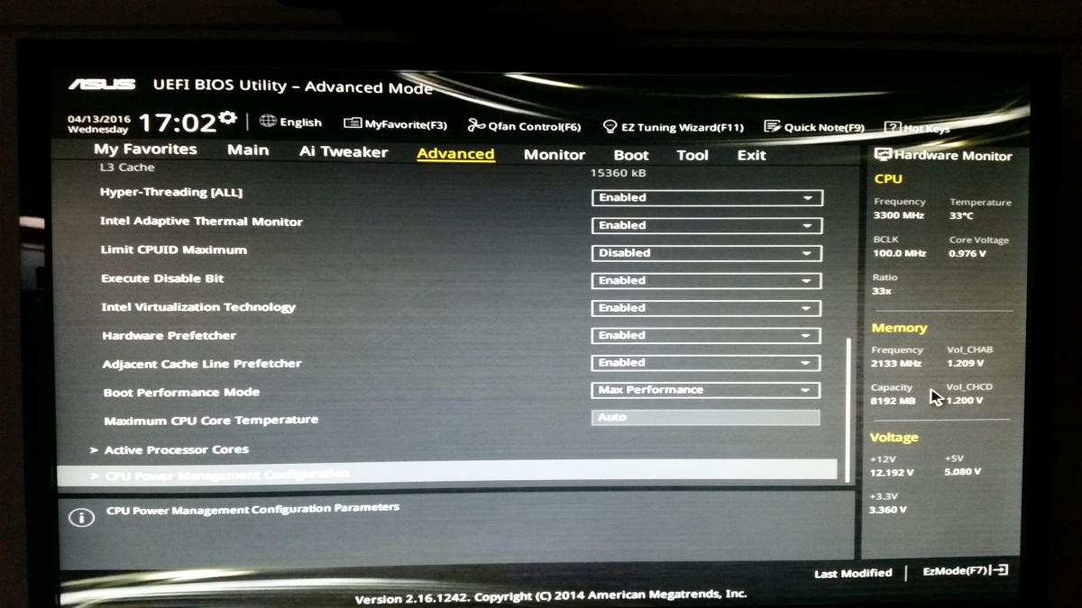

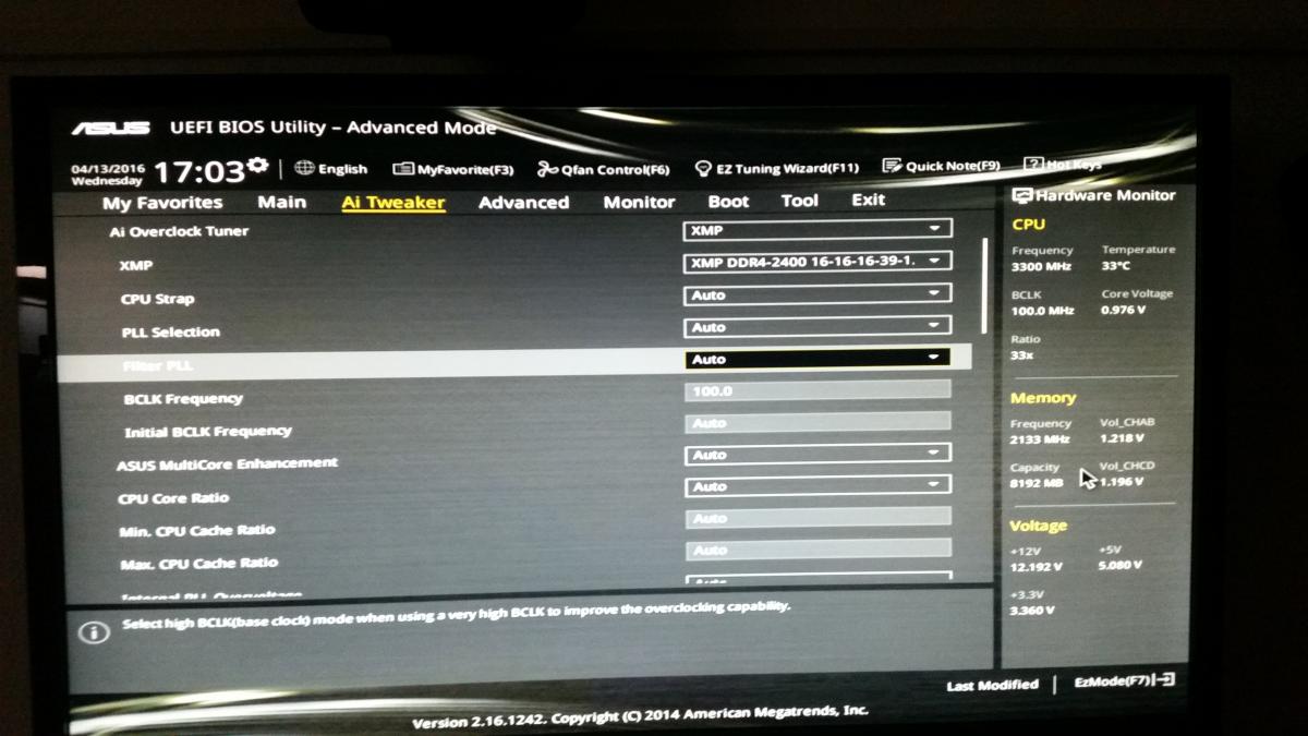

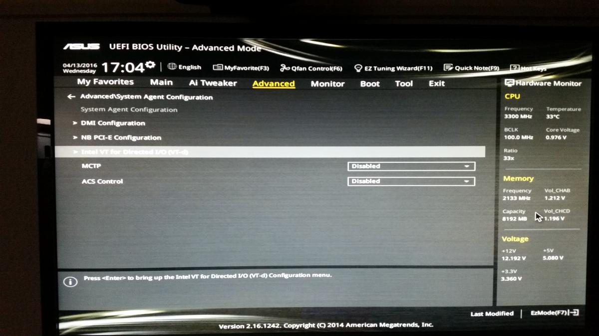

SgtSaber Posted April 13, 2016 Author Share Posted April 13, 2016 I tryed different settings in bios. Sam Multimedia: READ or WRITE failed Missing Bluetooth Controler Quote Link to comment https://www.insanelymac.com/forum/topic/311798-asus-x99-el-capitan-gtx-970-help-under-construction/#findComment-2232052 Share on other sites More sharing options...

Dwarfy Posted April 14, 2016 Share Posted April 14, 2016 Delete test2.efi and add lowmem driver. 1 Quote Link to comment https://www.insanelymac.com/forum/topic/311798-asus-x99-el-capitan-gtx-970-help-under-construction/#findComment-2232376 Share on other sites More sharing options...
Fljagd Posted April 16, 2016 Share Posted April 16, 2016 Will try tomorrow to handle IT in bios must disable the serial port (com) not ASmedia 2 Quote Link to comment https://www.insanelymac.com/forum/topic/311798-asus-x99-el-capitan-gtx-970-help-under-construction/#findComment-2232708 Share on other sites More sharing options...

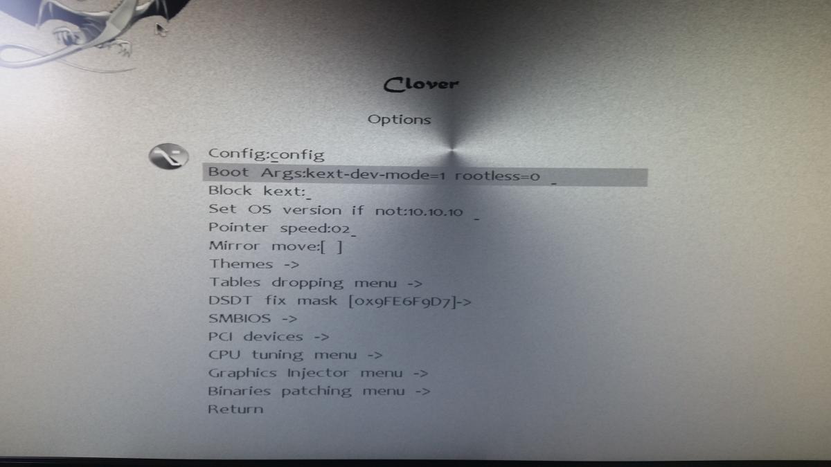

SgtSaber Posted April 24, 2016 Author Share Posted April 24, 2016 I hope i make i right. Downloaded EFI zip and copy to efi on my USB Stick The file X99 Problem: In clover u have many more Option than me. How can i get my SSD to VMware? Quote Link to comment https://www.insanelymac.com/forum/topic/311798-asus-x99-el-capitan-gtx-970-help-under-construction/#findComment-2234161 Share on other sites More sharing options...
