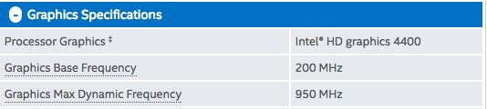

Allan Posted March 12, 2016 Share Posted March 12, 2016 Your iGPU can go until 950 MHz, nothing more: You can check if your iGPU going to using maximum power, running AppleIntelInfo. How use AppleIntelInfo: How to check your states – Using AICPMInfo, MSRDumper or AppleIntelInfo Link to comment https://www.insanelymac.com/forum/topic/311353-igpu-power-management-implementation-in-lenovo-g50-80/#findComment-2223075 Share on other sites More sharing options...
