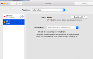

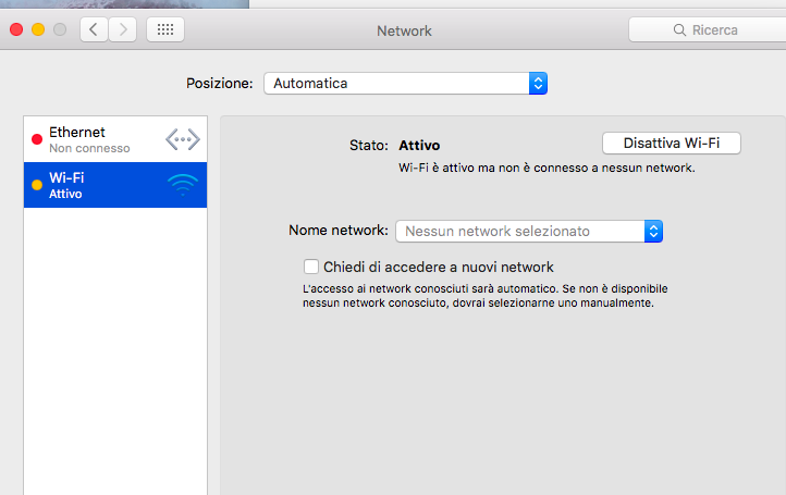

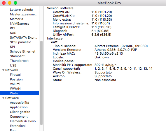

lidiano Posted March 4, 2016 Share Posted March 4, 2016 Sapete darmi una mano per favore, ho preso questa scheda WIFI e l'ho messa sul mio portatile un probook 450G1 sperando che andasse ma mi ritrovo in queste condizioni il wifi è attivo ma non trova e non si collega nessun network allego foto Link to comment https://www.insanelymac.com/forum/topic/311243-atheros-9285-non-mi-funziona/ Share on other sites More sharing options...
carbo178 Posted March 4, 2016 Share Posted March 4, 2016 Hai provato a flaggare "Chiedi di accedere a nuovi Network"? Link to comment https://www.insanelymac.com/forum/topic/311243-atheros-9285-non-mi-funziona/#findComment-2220611 Share on other sites More sharing options...

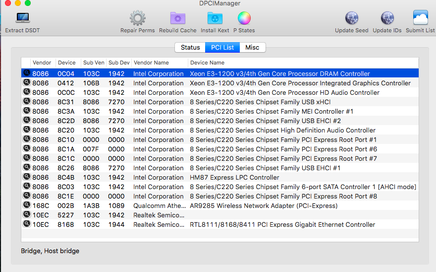

carbo178 Posted March 7, 2016 Share Posted March 7, 2016 Fai uno screen di DPCI Manager alla voce PCI List Link to comment https://www.insanelymac.com/forum/topic/311243-atheros-9285-non-mi-funziona/#findComment-2221526 Share on other sites More sharing options...
lidiano Posted March 7, 2016 Author Share Posted March 7, 2016 ecco Link to comment https://www.insanelymac.com/forum/topic/311243-atheros-9285-non-mi-funziona/#findComment-2221540 Share on other sites More sharing options...
carbo178 Posted March 7, 2016 Share Posted March 7, 2016 Iniezione nel DSDT oppure aggiunta dev-id nel kext Atheros40 Link to comment https://www.insanelymac.com/forum/topic/311243-atheros-9285-non-mi-funziona/#findComment-2221546 Share on other sites More sharing options...
