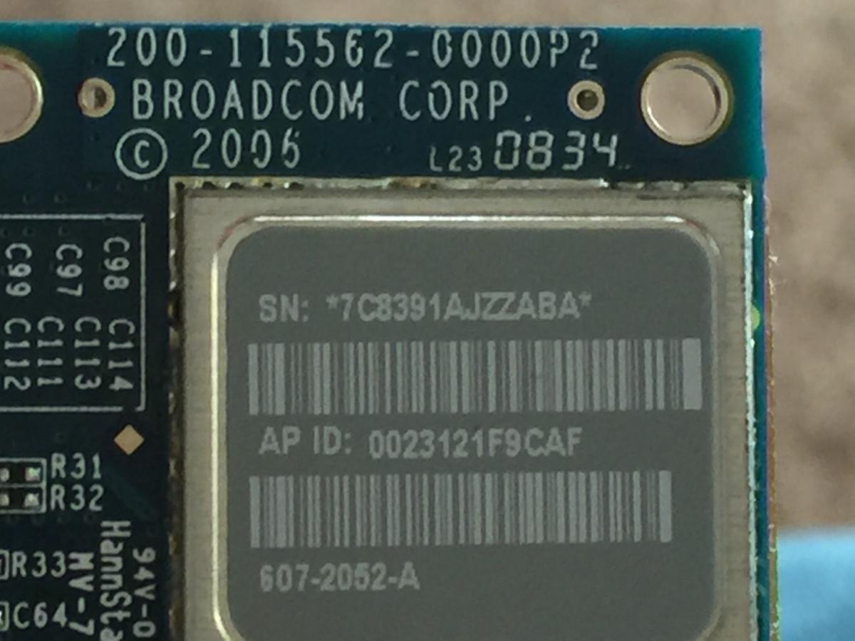

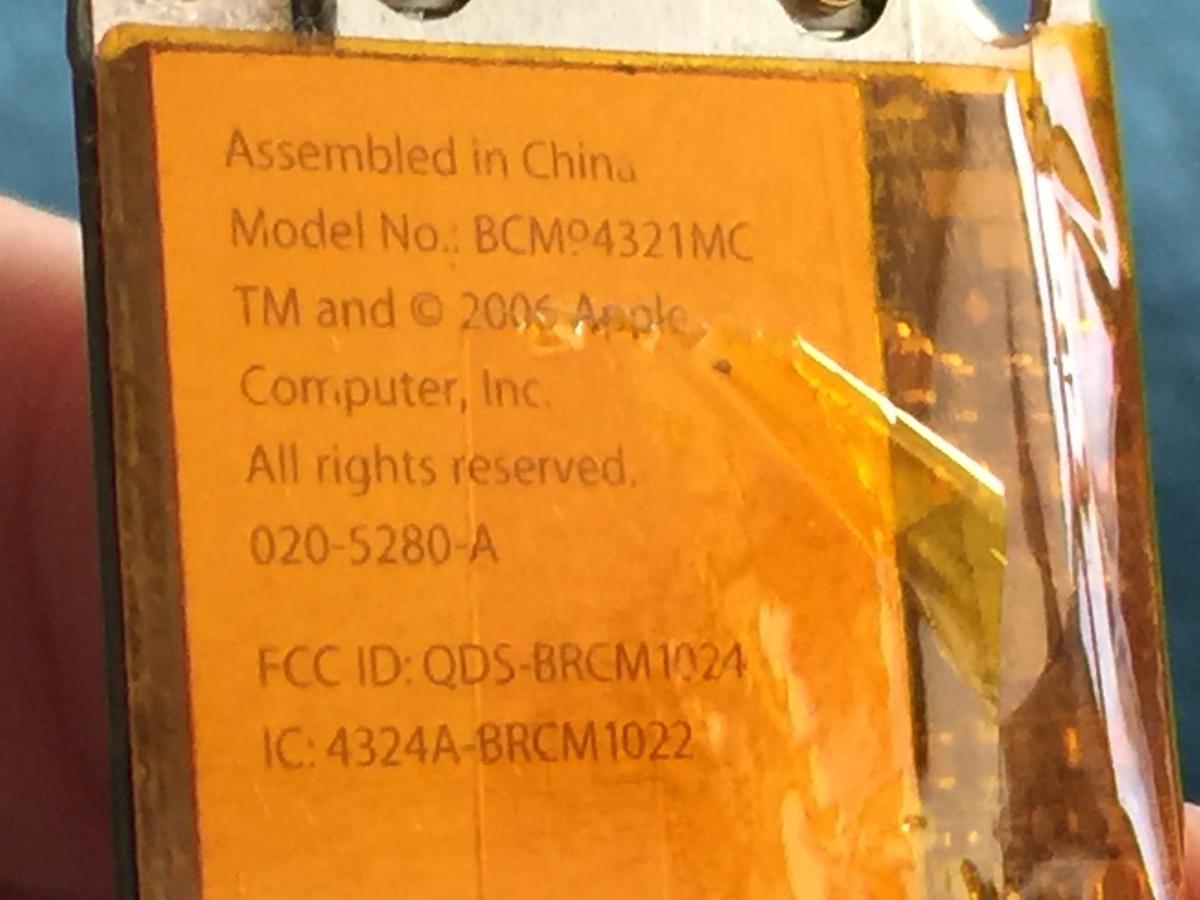

JimInChicago Posted February 21, 2016 Author Share Posted February 21, 2016 What a wonderful response, Herve' and thanks so much. Yes, I cannot imagine the Apple tech teams did not have the info. I had worked up to level 4 I think and had spent hours talking, emailing with them and trying all kinds of things with many steps. But, to the point, I have a spare card by Broadcom. . Can you tell from the attached if the latest rev of OSX would even see it? If not how can I get one of the cards you listed OR a USB known to work? I am over 70 now and this is getting a bit beyond me. I now have a 1TB SSD ready to drop in so I will have it apart anyway. Thanks so much. My wife says to replace this Mac as it is 8 years old now but I love the 17" screen! Link to comment https://www.insanelymac.com/forum/topic/310990-clean-install-of-el-capitan-in-17-mbp-finds-no-wireless-card/#findComment-2217062 Share on other sites More sharing options...
JimInChicago Posted February 23, 2016 Author Share Posted February 23, 2016 Progress! Today I put in the new 1T SSD, the wireless card, and even during just the clean install the wireless symbol was visible in the upper right! Problem now is that the driver, I think, is the wrong one because it has off and on confused and will not join any network because it thinks it is off. In "network" I click on "on" and it still shows up off but all the correct networks show up! Just cannot join. Is that driver over here: https://wikidevi.com/wiki/Apple_BCM94321MC? How can I ID the driver get and install it. Sorry but most of this is way over my head but I feel we are getting SO close. (thanks to you and this forum) Jim in Chicago Link to comment https://www.insanelymac.com/forum/topic/310990-clean-install-of-el-capitan-in-17-mbp-finds-no-wireless-card/#findComment-2217560 Share on other sites More sharing options...

JimInChicago Posted February 25, 2016 Author Share Posted February 25, 2016 Apple BCM94321MC : vendor/device id 14e4/4328, based on BCM4321 chip. It was supported in Yosemite and I see device id 4328 listed in El Capitan's AppleAirPortBrcm43224 Broadcom driver, so it should work straight away in ElCapitan. Try it out, just swap it with the old Atheros card. For the other models I mentioned, there's the well-known auction web site... As you have seen up top, the card now is found and is working. After about 10 minutes it disconnects and shuts off and I must log off and log back in to get it to work again. Progress may be slow but I AM optimistic. Any ideas on how to keep it working? You WERE the person who led me here where I have found so many good suggestions and also showed me the other database like site where all the info is. For that I thank you! Link to comment https://www.insanelymac.com/forum/topic/310990-clean-install-of-el-capitan-in-17-mbp-finds-no-wireless-card/#findComment-2218145 Share on other sites More sharing options...
