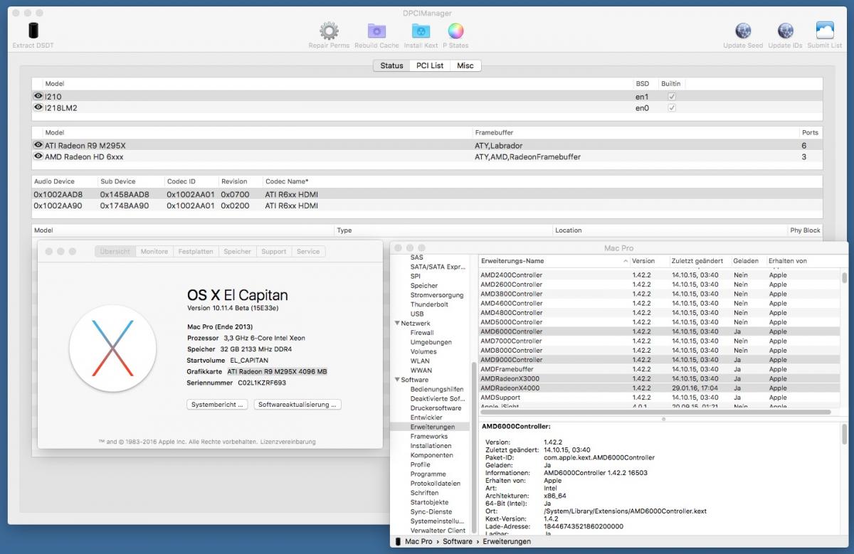

Installed this card in my ASUS X99-E WS EL CAPITAN setup with the dsame result as for a ASUS R9 380 STRIX: lost Monitorsignal after verbose boot, no screens, no connection via ARD possible.
But:
I installed a second RADEON Card, this time a Saphire Radeon HD6570 in PCI slot #1 (Radeon R9 380X sits in PCI slot #3)... et voila: Systeminformation detects the Radeon R9 380X
as a RADEON R9 M295X and shows screen on DP, HDMI and DVI!!!! So i would like to flash the M295X BIOS to the R9 380X and see, if it acts now like a RADEON R9 280X, which operates under EL CAPITAN OUT-OF-THE-BOX without the need of a second "primary" gfx-card.

See the attached picture what it looks like, when i have the HD6570 in PCI-Slot #1 and the R9 380X in PCI-Slot #2: AMDRadeonX4000.kext active, full accelleration. <--- see selection in screenshot
But this only works, if i have a second gfx-card attached to the system. I cant use internal gfx for this, cause HASWELL-E doesn't have internal (discrete) gfx.
And i have tested another constellation: R9 380 in Slot #1 and R9 380X in Slot #2. Result: same issues discribed earlier: all attached monitors loose signal and no screen works.
Little Information, too: both R9 380/x cards are based on TONGA chip. Both cards work fine, if i disable AMDRadeonX4000.kext (of cause w/o any accelleration).
