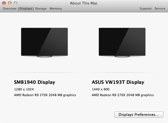

Hi all, I recently purchased an R9 270X Dual-X from Sapphire to use with my Hackintosh rig. The only problem is, my Second Monitor will not display anything (if I connect once the OS is booted) or will leave me with a white screen with the beach ball (If I connect during startup). I've read that it is a Framebuffer issue, but I've tried all the listed Personalities for the 7xxx/2xx and none of them work. Additionally, I tried Vlada's fix, but that doesn't work either. I've also tried the 'Video Ports' fix for Clover to no avail. The only time I've come close to success is with the Hamachi Framebuffer, but that failed my '3 reboots or not working' test.
My Specs Are:
CPU: Intel Core i7-4770K
GPU: Sapphire Radeon R9 270X 2GB Dual-X
RAM: 8GB Kingston HyperX
OS: Mac OS X 10.9.5
SMBIOS: iMac15,1
All help would be appreciated,
Thanks,
- Matt
EDIT: For anyone else looking for the working frame buffer patch for the Sapphire R9 270X 2GB Dual-X, here is the process:
1. Open Clover Configurator and go to the 'Kernel and Kext patches' tab.
2. Under the 'KextsToPatch' line, add 'AMD7000Controller' (note, do NOT add .kext to the end).
3. Under 'FIND [Hex]', put this code: 0004000004030000000101011204050100004000004030000000102012205040020400000014020000000103000000030600008000004020000000104001102010
4. Under 'Replace [HEX]' add this code: 0004000004030000000102011204050100002000004020000000101011000030060400000014020000000103001102050500008000004020000000104002205020
5. Under comments, add 'Hamachi Patch' or something like that.
6. Go to the 'Graphics' tab.
7. In 'FB Name', use the config 'Hamachi'.
8. Save and reboot.
9. Make sure to only plug in the second display AFTER you are logged in, or you will get weird bars on the screen.
Thanks to Vlada, Maniac10 and Codinger!

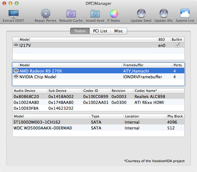

Patching the Framebuffer worked, but not on the Framebuffer Vlada specified in his guide. Futomaki didn't work at all, so I had to Patch the Hamachi Framebuffer, and all is right with the world. I will try the 'Radeon' frame buffer, and I will update the post in a minute. There's just one interesting thing about the Patch Fix. I need to plug in my second display AFTER I boot the computer, if I try to boot with it in, it gives me a white screen on my primary monitor and blue bars on my second one indefinitely (until I unplug the second, of course). Could you shed some light on this?

'Radeon' is not listed as one, so that leaves me to believe that it is defaulting to a random one listed above. But hey, if it works it works!
- Matt
Radeon is the standard framebuffer and should be selected automatically if you boot without a display connected and connect them after you've reached the desktop.
You don't need to add any patches - just use Radeon as framebuffer name.
But then again - you're using Mavericks: I can't remember if the support via Radeon framebuffer was introduced with Yosemite...
Yea, I don't know if Mavericks supports that framebuffer but it's worth a try. It's not really a "connectors patch" like you're doing now, you just need to use an untouched kext and simply set the framebuffer with your bootloader and that should be enough.
