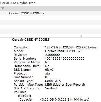

mrmacdi2 Posted October 23, 2016 Share Posted October 23, 2016 I have the same problem on my Sony laptop (see signature): "protocol: ata" in System Information and Corsair CSSD-F120GB2 is not recognized as SSD, "trimforce enable" say everything is ok, but after reboot nothing changes. SSD is connected via Intel® ICH8M 3 port Serial ATA Storage Controller. in Win TRIM is enabled and works. P.S. Also strange that I'm not able to change volume type (Apple_Boot) for "Recovery HD" as after restore it has Apple_HFS on this SSD. Filesystem is OK - I've checked. Link to comment https://www.insanelymac.com/forum/topic/310396-ssd-trim-issues-tried-a-few-things/#findComment-2304649 Share on other sites More sharing options...

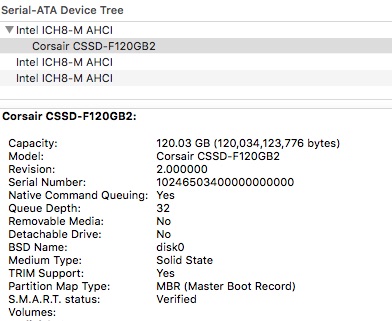

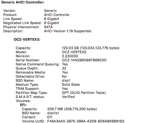

mrmacdi2 Posted October 24, 2016 Share Posted October 24, 2016 Did you check that disk mode is set to AHCI in BIOS? Or maybe you do not have that option. OS X will not recognise a SSD as such in non-AHCI mode, i.e. it'll considers it as a plain old regular hard disc and you'll therefore not have Trim enforced. Sony bioses are really easy-to-use , but I was able to change settings in NVRAM and have enabled AHCI, so in Windows this SSD works fine: in AHCI and with TRIM. I have a Hackintosh PC with Vertex SSD and TRIM works fine (see attached picture). Looks like that MBR/GUID don't affect TRIM. The only thing can affect TRIM in my case is that I had have installed El Cap on an external USB flash first and then have cloned it to my internal SSD (done it to avoid patching of OSX installer for MBR installation and for test drive, as I have Win installation which I use on a regular base on SSD). Looks like OSX used ata mode in that case (installation on USB flash, but not sure). Will try to reinstall on internal SSD directly. Link to comment https://www.insanelymac.com/forum/topic/310396-ssd-trim-issues-tried-a-few-things/#findComment-2305038 Share on other sites More sharing options...
mrmacdi2 Posted October 24, 2016 Share Posted October 24, 2016 [FIXED] Something has cleared AHCI settings in NVRAM, which I've changed long time ago and I haven't noticed it in Windows as it worked as usual. Dumped NVRAM values today and have found out that AHCI was disabled (also no AHCI in Win device manager). Changed NVRAM AHCI setting back to 1 -> reboot -> AHCI and TRIM work OOB even w/o "trim force enable". And in Win I also have AHCI, but again - no visual signs that I've enabled AHCI as drivers were already installed. Nice Link to comment https://www.insanelymac.com/forum/topic/310396-ssd-trim-issues-tried-a-few-things/#findComment-2305087 Share on other sites More sharing options...
