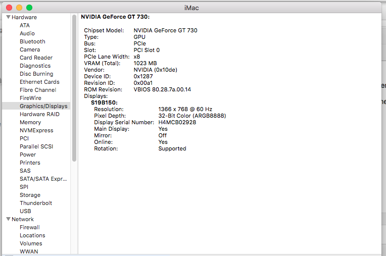

Derek12 Posted January 2, 2016 Share Posted January 2, 2016 I got today a Asus Geforce 730 2GB DDR3 to replace my old GT610 which worked OOB. OSX version: 10.11.2 Used that web driver and using nvda_drv=1 flag as stated by tutorials, it is detected and recognized in system info, except that VGA won't work. Video signal cuts off after apple logo. However, an HDMI TV works fine, complete with audio, QE CI and acceleration. When only the monitor is plugged in, it says "Built-in display" checked with VNC, if both it and the TV are plugged in, only the latter is detected. VGA only works with nv_disable=1 albeit losing all acceleration. Install is pretty vanilla, no DSDT used, no flags except that nvda_drv, only fakesmc, voodoo HDA and l1e atheros Is there something I can do except using that TV as screen? Thank you Link to comment https://www.insanelymac.com/forum/topic/310176-vga-not-working-on-gt-730/ Share on other sites More sharing options...

Derek12 Posted February 17, 2016 Author Share Posted February 17, 2016 WTF? I've reinstalled OSX from scratch and the Nvidia web driver and now the VGA output works fine and my screen is detected Two $%#$%·" weeks trying to fix this and fixed in 2 hours by simply clean install it again *facepalm* Link to comment https://www.insanelymac.com/forum/topic/310176-vga-not-working-on-gt-730/#findComment-2216241 Share on other sites More sharing options...
