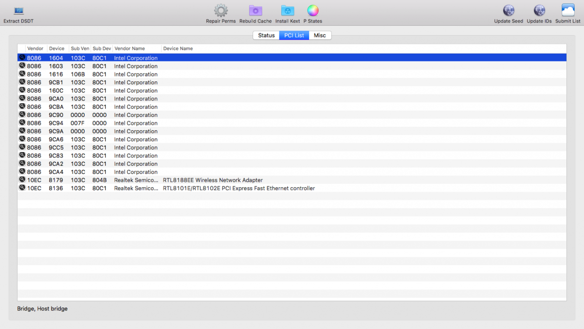

gengik84 Posted December 30, 2015 Share Posted December 30, 2015 che wifi monta il tuo portatile? Link to comment https://www.insanelymac.com/forum/topic/310078-hp-15ac158nl-100-osx-10112/page/3/#findComment-2201837 Share on other sites More sharing options...
Laquari95 Posted December 30, 2015 Author Share Posted December 30, 2015 che wifi monta il tuo portatile? devo scaricare dcpimanager o posso cercarlo nel dumper? mi sembra un realtek mi semba Link to comment https://www.insanelymac.com/forum/topic/310078-hp-15ac158nl-100-osx-10112/page/3/#findComment-2201849 Share on other sites More sharing options...
gengik84 Posted December 30, 2015 Share Posted December 30, 2015 fai la foto a dpci..... Bravo leggi l'altro topic.... Link to comment https://www.insanelymac.com/forum/topic/310078-hp-15ac158nl-100-osx-10112/page/3/#findComment-2201854 Share on other sites More sharing options...
Laquari95 Posted December 30, 2015 Author Share Posted December 30, 2015 fai la foto a dpci..... Bravo leggi l'altro topic.... ahaha scusami ma volevo fare lo screendhot per non dover far sempre la foto col cell e ho appena scoperto che il tasto cmd corrisponde ad alt Link to comment https://www.insanelymac.com/forum/topic/310078-hp-15ac158nl-100-osx-10112/page/3/#findComment-2201863 Share on other sites More sharing options...
gengik84 Posted December 30, 2015 Share Posted December 30, 2015 Niente da fare... Wifi non compatibile... Quindi o usi un usb oppure sostituisci quello interno Link to comment https://www.insanelymac.com/forum/topic/310078-hp-15ac158nl-100-osx-10112/page/3/#findComment-2201869 Share on other sites More sharing options...
Laquari95 Posted December 30, 2015 Author Share Posted December 30, 2015 Niente da fare... Wifi non compatibile... Quindi o usi un usb oppure sostituisci quello interno azz e ma lo sapevo bisogna essere parecchio fortunati ad aveere wifi supportato.. va be usero il dongle x adesso.. volevo chiederti riusciresti a darmi ancora un'occhiata allo sleep e alal gestione del power managment di batteria ecc se è settato in modo da consumare poco se lo sleep non dovesse andare di nuovo faccio che spegnere il pc e non lasciarlo in stan by Link to comment https://www.insanelymac.com/forum/topic/310078-hp-15ac158nl-100-osx-10112/page/3/#findComment-2201880 Share on other sites More sharing options...
