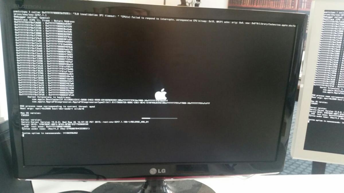

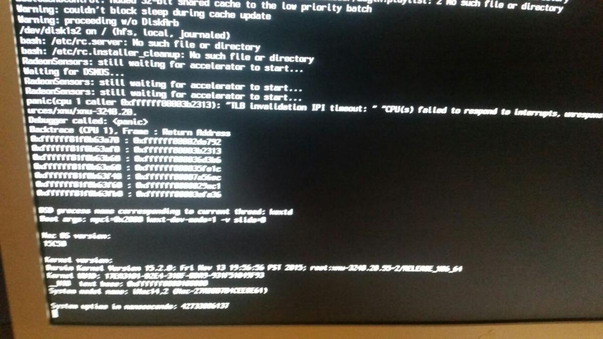

ssprod Posted December 30, 2015 Share Posted December 30, 2015 I7 5820k cpu GTX970 gpu Asus X99a mobo Just about ending my efforts in attempting a 10.11.2 installation, although many thanks goes out to Fijagd for his method of X99 Installation, i've gotten farther with this technique than the more conventional methods. I still, however, cannot get past this kernel panic (http://imgur.com/66FhZwF) and have tried numerous config.plist settings to no avail. What the heck am I doing wrong? Seems close, yet miles away to a succesful boot. Any suggestions would be much appreciated. thanks. ssprod Link to comment https://www.insanelymac.com/forum/topic/310017-asus-x99-deluxe-yosemite-succes-el-capitan-no-succes/#findComment-2201949 Share on other sites More sharing options...
Fljagd Posted December 30, 2015 Share Posted December 30, 2015 try to start with -x Link to comment https://www.insanelymac.com/forum/topic/310017-asus-x99-deluxe-yosemite-succes-el-capitan-no-succes/#findComment-2201958 Share on other sites More sharing options...
ssprod Posted December 30, 2015 Share Posted December 30, 2015 try to start with -x FLjagd, that results with this (http://imgur.com/xjw359d) and then reboots immediately. I'll keep fighting the battle. Thanks again. Link to comment https://www.insanelymac.com/forum/topic/310017-asus-x99-deluxe-yosemite-succes-el-capitan-no-succes/#findComment-2201969 Share on other sites More sharing options...
Fljagd Posted December 30, 2015 Share Posted December 30, 2015 FLjagd, that results with this (http://imgur.com/xjw359d) and then reboots immediately. I'll keep fighting the battle. Thanks again. you can send your config.plist Link to comment https://www.insanelymac.com/forum/topic/310017-asus-x99-deluxe-yosemite-succes-el-capitan-no-succes/#findComment-2201973 Share on other sites More sharing options...
ssprod Posted December 31, 2015 Share Posted December 31, 2015 you can send your config.plist Thank you, FLjagd. ssprod Link to comment https://www.insanelymac.com/forum/topic/310017-asus-x99-deluxe-yosemite-succes-el-capitan-no-succes/#findComment-2201980 Share on other sites More sharing options...
Fljagd Posted December 31, 2015 Share Posted December 31, 2015 in S / L / E delete IOBluetoothFamily.kext Link to comment https://www.insanelymac.com/forum/topic/310017-asus-x99-deluxe-yosemite-succes-el-capitan-no-succes/#findComment-2202010 Share on other sites More sharing options...
ssprod Posted December 31, 2015 Share Posted December 31, 2015 in S / L / E delete IOBluetoothFamily.kext KP'd again, however I think the issue is solved...I disabled Serial Port in the bios and she booted with graphics disabled. Question---->using your method, I have done the work so far on a "spare" drive. Can I "clone" this to my actual new drive that I'd like to use? Will everything remain intact? What software would you recommend to do this? Thanks very much Fljagda, Link to comment https://www.insanelymac.com/forum/topic/310017-asus-x99-deluxe-yosemite-succes-el-capitan-no-succes/#findComment-2202044 Share on other sites More sharing options...
