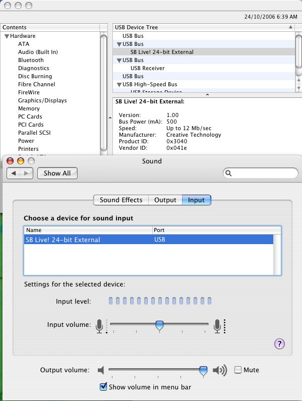

Kelvin KC Chan Posted October 23, 2006 Share Posted October 23, 2006 For notebook, if no patch file for it and u not know how to edit... I only suggest u to buy USB sound as Creative external USB---u no need to do more, just plug and work. Link to comment https://www.insanelymac.com/forum/topic/31000-no-sound-or-internet-working-aspiring-artist-needs-help/#findComment-215012 Share on other sites More sharing options...

capthook Posted October 23, 2006 Share Posted October 23, 2006 For notebook, if no patch file for it and u not know how to edit...I only suggest u to buy USB sound as Creative external USB---u no need to do more, just plug and work. Kelvin; Which model SB ext. works with OSX86? There are quite a few different models, even a fancy one with surround & remote sorry answered my own q's easily on this forum with other posts: Soundblaster Live 24 bit external seems to be the best, cheap solution. Any one else have a good USB sound device that works? Link to comment https://www.insanelymac.com/forum/topic/31000-no-sound-or-internet-working-aspiring-artist-needs-help/#findComment-215074 Share on other sites More sharing options...
Kelvin KC Chan Posted October 23, 2006 Share Posted October 23, 2006 See picture as below: Link to comment https://www.insanelymac.com/forum/topic/31000-no-sound-or-internet-working-aspiring-artist-needs-help/#findComment-215147 Share on other sites More sharing options...
