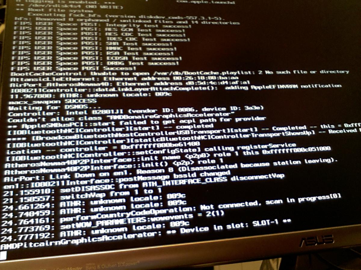

gengik84 Posted January 7, 2016 Share Posted January 7, 2016 Foto verbose...Please... Link to comment https://www.insanelymac.com/forum/topic/309924-risoltouna-scheda-grafica-per-domarli-tutti/page/2/#findComment-2203906 Share on other sites More sharing options...
carbo178 Posted January 7, 2016 Share Posted January 7, 2016 Forse serve npci=0x2000 (strano però) Link to comment https://www.insanelymac.com/forum/topic/309924-risoltouna-scheda-grafica-per-domarli-tutti/page/2/#findComment-2203909 Share on other sites More sharing options...

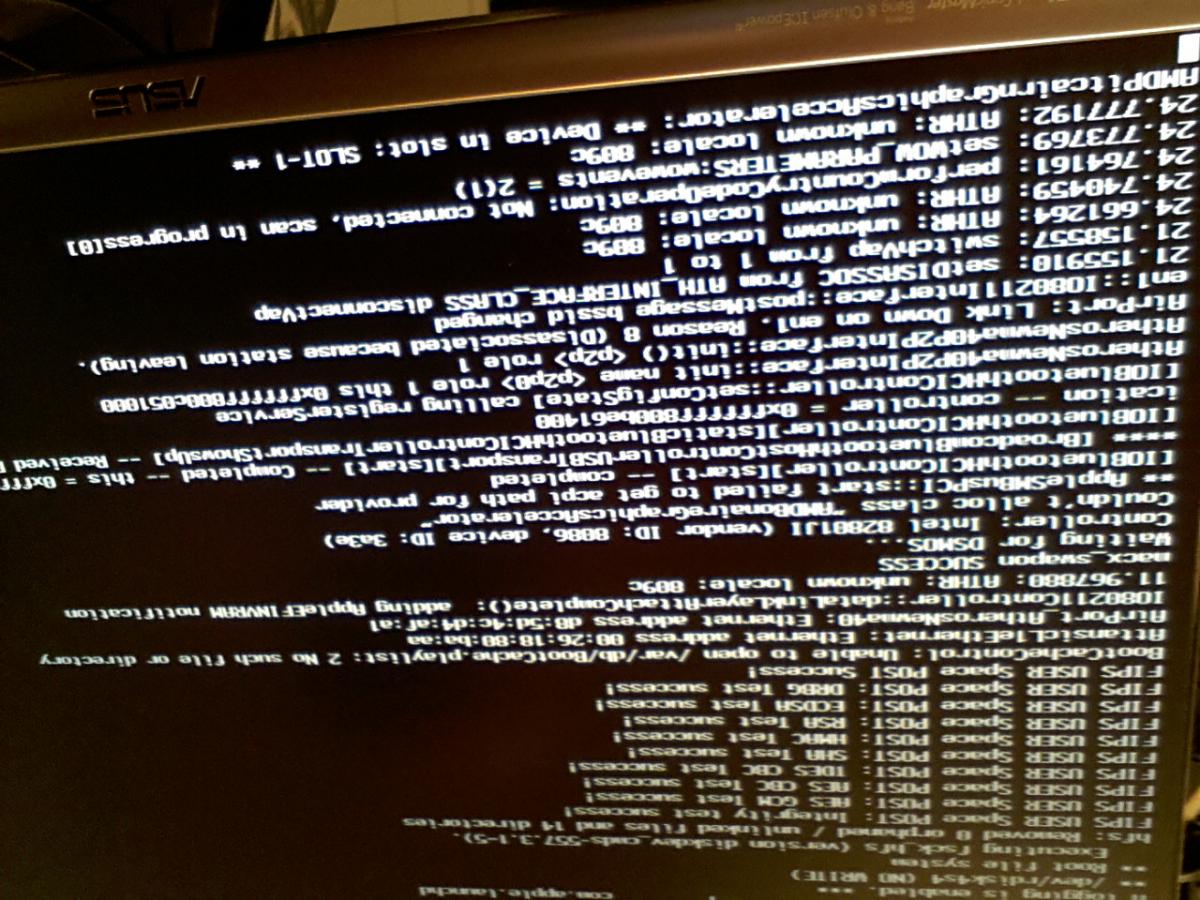

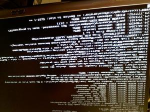

MARZILLO Posted January 7, 2016 Author Share Posted January 7, 2016 foto del verbose Raddrizzo Link to comment https://www.insanelymac.com/forum/topic/309924-risoltouna-scheda-grafica-per-domarli-tutti/page/2/#findComment-2203915 Share on other sites More sharing options...
gengik84 Posted January 7, 2016 Share Posted January 7, 2016 questo senza le "cose" dette? Sul bios la scheda come è impostata? Link to comment https://www.insanelymac.com/forum/topic/309924-risoltouna-scheda-grafica-per-domarli-tutti/page/2/#findComment-2203917 Share on other sites More sharing options...
