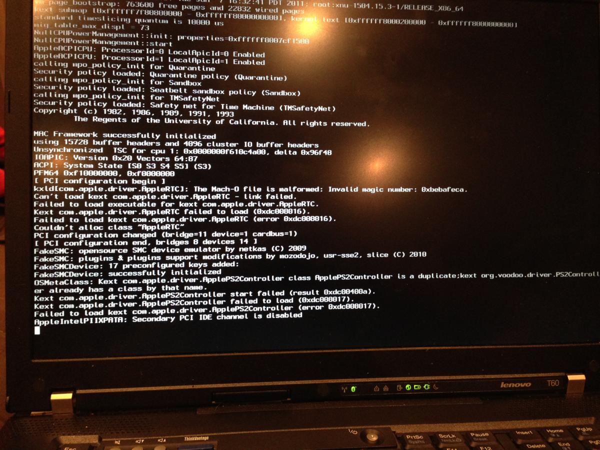

jonciaco Posted December 1, 2015 Share Posted December 1, 2015 So I finally got my ThinkPad to get to the Apple screen with GE=Yes. I switched from the default bootloader that [url="http://www.insanelymac.com/forum/topic/279450-why-insanelymac-does-not-support-tonymacx86/"]#####[/url] installs to the Chameleon Bootloader(using the latest in Chameleon Wizard). Now once it gets to the Apple logo, it just stops. I went into verbose mode to see why it stops and I am not so sure(picture attached below). Specs(ThinkPad T60 8745BU): Core 2 Duo T7200 3GB Ram Radeon x1400(Both kexts installed, Radeon x1400 and Radeon HD, and the HD kext does have the screens edid file.) Thanks! Link to comment https://www.insanelymac.com/forum/topic/309652-os-x-wont-boot-thinkpad-t60/ Share on other sites More sharing options...
Codinger Posted December 27, 2015 Share Posted December 27, 2015 So I finally got my ThinkPad to get to the Apple screen with GE=Yes. I switched from the default bootloader that ##### installs to the Chameleon Bootloader(using the latest in Chameleon Wizard). Now once it gets to the Apple logo, it just stops. I went into verbose mode to see why it stops and I am not so sure(picture attached below). Specs(ThinkPad T60 8745BU): Core 2 Duo T7200 3GB Ram Radeon x1400(Both kexts installed, Radeon x1400 and Radeon HD, and the HD kext does have the screens edid file.) Thanks! 1. You are not allowed to use TonyMac here! http://www.insanelymac.com/forum/topic/275941-very-important-please-read-about-tonymacx86-and-iatkos-m-y/ 2. Remove ApplePS2Controller.kext from S/L/E -> boot with -s Link to comment https://www.insanelymac.com/forum/topic/309652-os-x-wont-boot-thinkpad-t60/#findComment-2200862 Share on other sites More sharing options...
