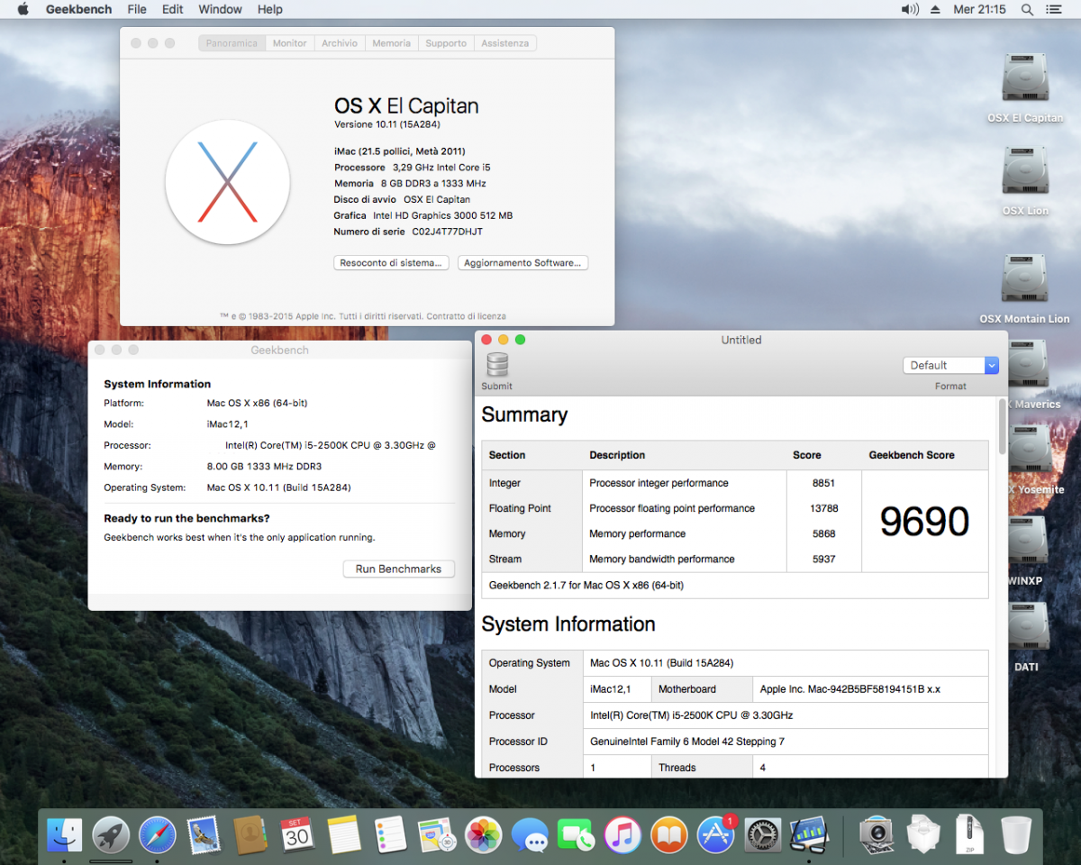

And I Install Multiboot OSx Lion, OS X Montain Lion, OSX Yosemite, OSX El Capitan, etc. with Chameleon because i have used MBR partitions  and the system has a Legacy  Bios ...
It works 100%
Intel HD 3000  VGA/HDMI  QE/CI - OK  see my post
Nec uPD72020 USB3 - OK (on 10.11 i have to fix it)
Audio ALC889  - HDMI and legacy (front and rear) Ok
Network RTL81111 - OK
SATA3 AHCI - OK
SSD - OK - Trim Enabler
Sleep/Wake Ok
Blu-ray Sony BD-5300S - works fine with Mac BluRay Player -OK

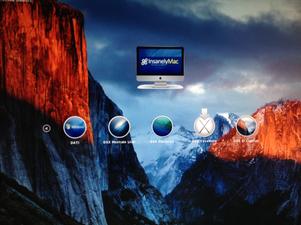

When all was fine , then i created my personal Chameleon Theme to boot all OSXs

How to Multiboot
I began installing OSX Lion some times ago , on dual boot with windows XP.
First i have resize partitions from windows to make some space for OSX.
So at every OSX new release, i shrink data partition of 20-25 Gb and create a new empty partition for the new S.O.
The trick is to maintain active partition on ( i.e. OSX Lion partition)  where i have installed Chameleon ( and which i update when it get to old to boot new SO).
Every OSX partition has its own /Extra folder with specific Kexts or configuration, so i can fix  if needed.
The good is that i selected a set of Kexts that are working from OSX Lion To OSX El Capitan ...
I have updated each OSX to its maximum release ... 10.7.5, 10.8.5, 10.9.5 , 10.10.5
The DSDT.aml , smbios iMac12.1  are the same for all, and with Chameleon Enoch i can boot all OSX versions.
