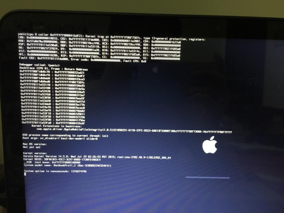

Frighten Posted September 25, 2015 Share Posted September 25, 2015 i was using the hackintosh and update xcode to 7. then i restarted and faced this problem. i've tried safe mode but it doesn' seem to work. p/s: i have no mobile device connected to the laptop Link to comment https://www.insanelymac.com/forum/topic/308192-kernel-panic/ Share on other sites More sharing options...
spakk Posted September 25, 2015 Share Posted September 25, 2015 replace AppleMobileFileIntegrity.kext and this file /usr/libexec/amfid from 10.10.4 then repair the permission 1 Link to comment https://www.insanelymac.com/forum/topic/308192-kernel-panic/#findComment-2170187 Share on other sites More sharing options...
Frighten Posted September 25, 2015 Author Share Posted September 25, 2015 replace AppleMobileFileIntegrity.kext and this file /usr/libexec/amfid from 10.10.4 then repair the permission where can I download these files? thanks Link to comment https://www.insanelymac.com/forum/topic/308192-kernel-panic/#findComment-2170192 Share on other sites More sharing options...
spakk Posted September 25, 2015 Share Posted September 25, 2015 test it once only with the driver, repair the permission and kernel cache package.zip Link to comment https://www.insanelymac.com/forum/topic/308192-kernel-panic/#findComment-2170322 Share on other sites More sharing options...
