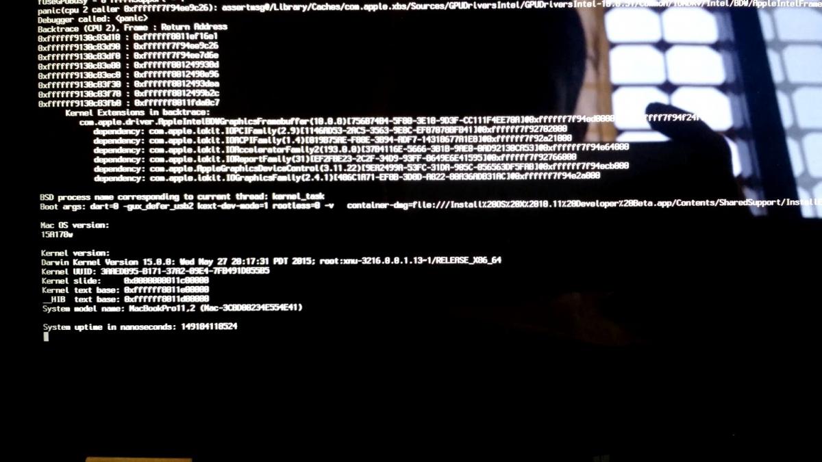

zaidshb Posted September 22, 2015 Author Share Posted September 22, 2015 Okay we have a progress here, the good news is i can now see verbose mode working (i guess the problem was caused by the faulty FakeSMC). the bad news is it stops at some point and restarts automatically as shown in the last second screenshot i could get. i didn't patch DVMT because as i said earlier i have it set to 128MB (Dedicated video memory). P.S: my BIOS settings only have AHCI option Thanks Link to comment https://www.insanelymac.com/forum/topic/308145-el-capitan-with-broadwell-u-gives-black-screen/#findComment-2169608 Share on other sites More sharing options...
duduclx Posted September 22, 2015 Share Posted September 22, 2015 the problem was the OsxAptioFixDrv-64.efi (conflict with OsxAptioFixDrv2-64.efi) and bad fakesmc.kext what version of El capitan are you running ? Only Developer preview 1 and 2, Public Beta 1 have yosemite boot arg. if you have a higher version of El Capitan, uncheck : - dart=0 - rootless=0 - gux-defer-usb2 you only need kext-dev-mode=1 I think you have CSM/UEFI option in your Bios, try something like: disable the secure boot first . Then , Advanced tab -> System Configuration . Then you can see the boot mode option . I'm 99% sure that the problem is relative to bios setting. Link to comment https://www.insanelymac.com/forum/topic/308145-el-capitan-with-broadwell-u-gives-black-screen/#findComment-2169621 Share on other sites More sharing options...
vusun123 Posted September 22, 2015 Share Posted September 22, 2015 The problem is DVMT related. Pick 64 or 96MB as DVMT, else you will get KP at AppleIntelBDWGraphics, or blackscreen and reboot Link to comment https://www.insanelymac.com/forum/topic/308145-el-capitan-with-broadwell-u-gives-black-screen/#findComment-2169623 Share on other sites More sharing options...

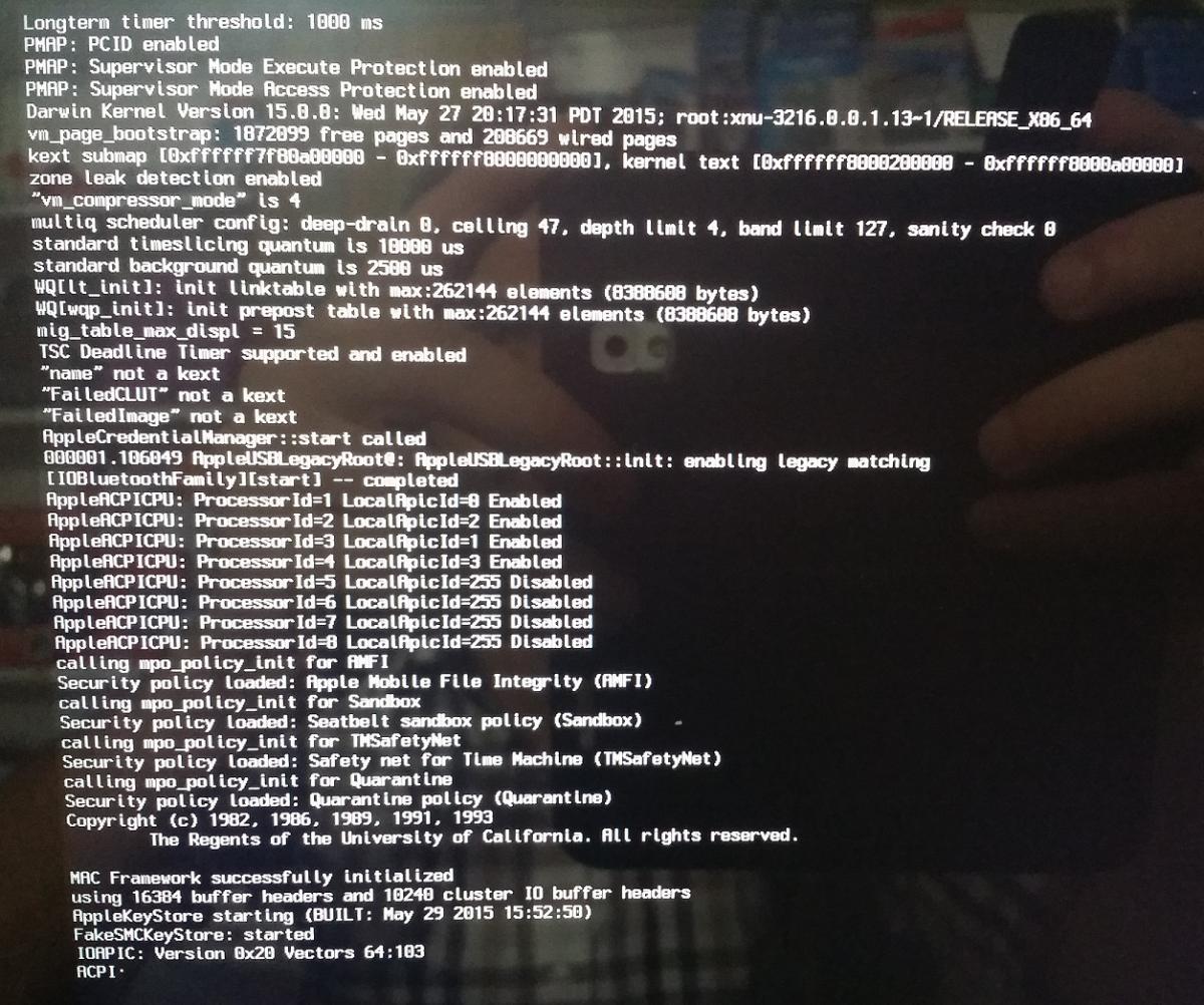

zaidshb Posted September 23, 2015 Author Share Posted September 23, 2015 activate secure boot and virtualization. remove useless part, like Wlan wake/boot, port, and more. try as much combo as you can, if it still fail, then, DVMT is your last step to do. A lot of digging and trying later, install stucks at: FakeSMC again you think? Link to comment https://www.insanelymac.com/forum/topic/308145-el-capitan-with-broadwell-u-gives-black-screen/#findComment-2169818 Share on other sites More sharing options...
vusun123 Posted September 23, 2015 Share Posted September 23, 2015 If you are using someone else's DSDT and SSDTs, then don't use them Link to comment https://www.insanelymac.com/forum/topic/308145-el-capitan-with-broadwell-u-gives-black-screen/#findComment-2169825 Share on other sites More sharing options...
zaidshb Posted September 23, 2015 Author Share Posted September 23, 2015 If you are using someone else's DSDT and SSDTs, then don't use themOkay then, back to first square Link to comment https://www.insanelymac.com/forum/topic/308145-el-capitan-with-broadwell-u-gives-black-screen/#findComment-2169827 Share on other sites More sharing options...

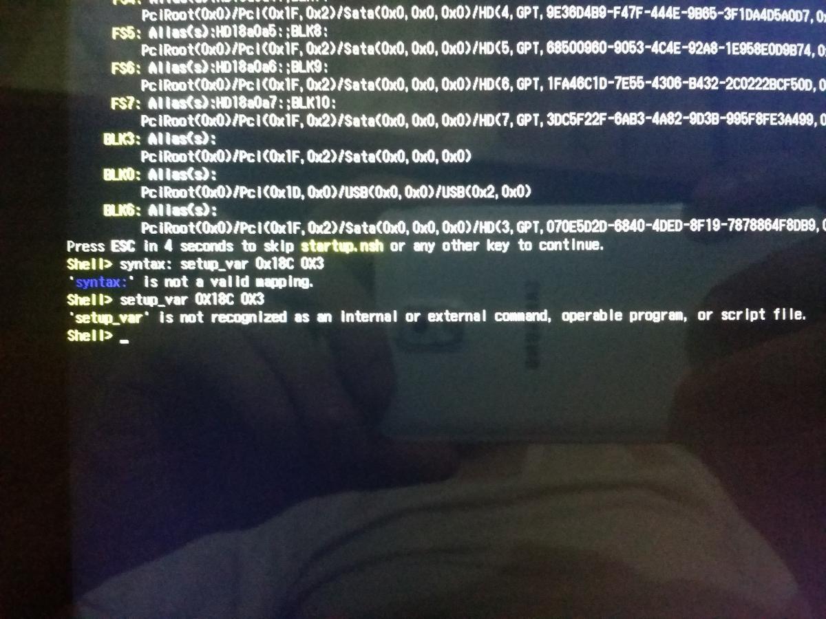

duduclx Posted September 27, 2015 Share Posted September 27, 2015 when on clover, select Shell. apply the patch to bios. no need to have a dsdt till you can't boot and install os x. Link to comment https://www.insanelymac.com/forum/topic/308145-el-capitan-with-broadwell-u-gives-black-screen/#findComment-2170784 Share on other sites More sharing options...
zaidshb Posted September 27, 2015 Author Share Posted September 27, 2015 when on clover, select Shell. apply the patch to bios. no need to have a dsdt till you can't boot and install os x. Link to comment https://www.insanelymac.com/forum/topic/308145-el-capitan-with-broadwell-u-gives-black-screen/#findComment-2170793 Share on other sites More sharing options...
vusun123 Posted September 28, 2015 Share Posted September 28, 2015 IMG_20150928_012053.jpg You wrote it wrong. It should be 0x18C 0x3, not 0X, and also Clover's Shell won't work if you are planning to change the DVMT. Get Austere's bootx64.efi Link to comment https://www.insanelymac.com/forum/topic/308145-el-capitan-with-broadwell-u-gives-black-screen/#findComment-2170821 Share on other sites More sharing options...
