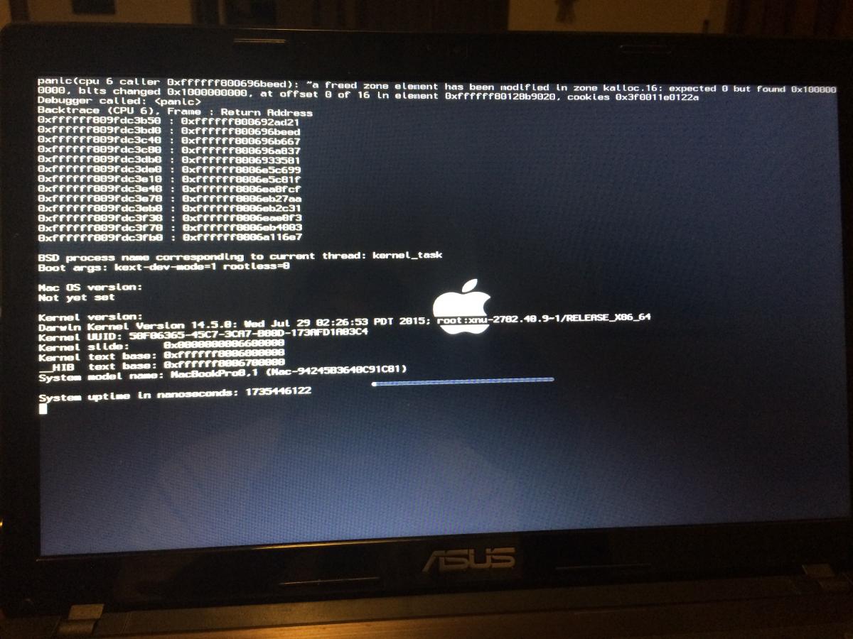

gengik84 Posted August 30, 2015 Share Posted August 30, 2015 Il KP da cosa può dipendere lo hai capito? dovresti postare la foto... Link to comment https://www.insanelymac.com/forum/topic/307851-asus-x53sv-togliere-il-null/#findComment-2164500 Share on other sites More sharing options...

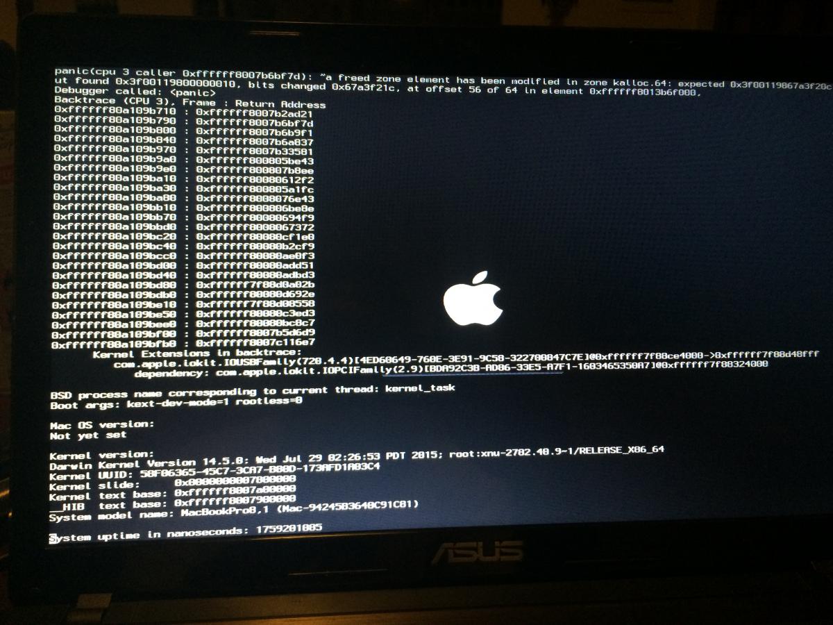

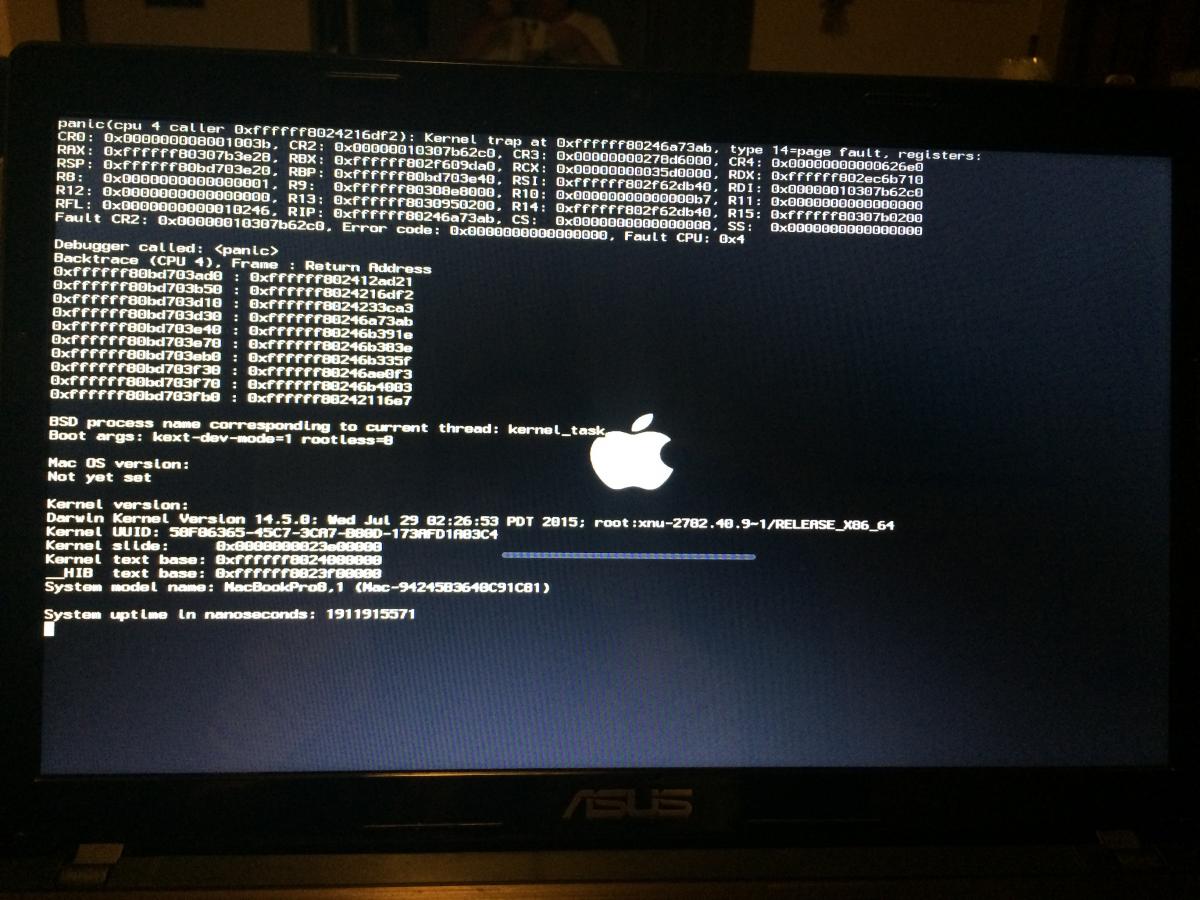

lidiano Posted August 30, 2015 Author Share Posted August 30, 2015 Allora ho riavviato questo il primo kp poi si è riavviato e ha fatto questo secondo kp poi terzo kp poi si è riavviato normalmente Link to comment https://www.insanelymac.com/forum/topic/307851-asus-x53sv-togliere-il-null/#findComment-2164511 Share on other sites More sharing options...

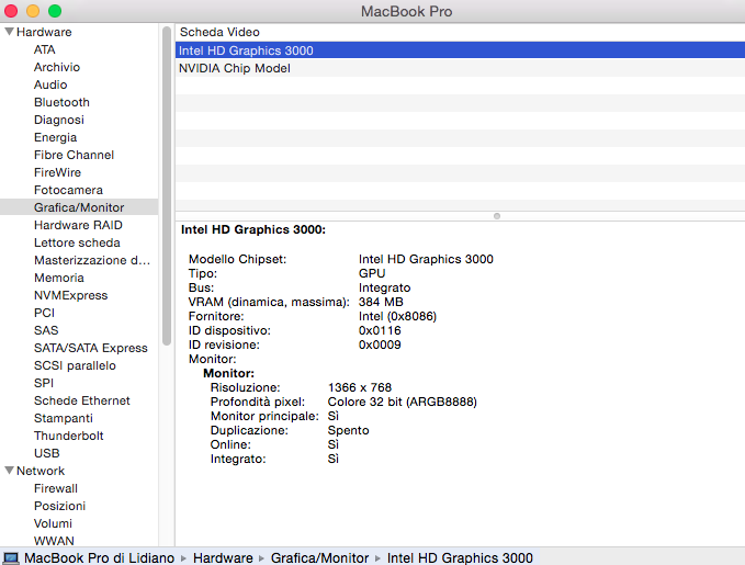

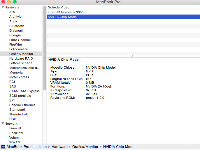

gengik84 Posted September 1, 2015 Share Posted September 1, 2015 su informazioni di sistema, grafica cosa risulta? Link to comment https://www.insanelymac.com/forum/topic/307851-asus-x53sv-togliere-il-null/#findComment-2164943 Share on other sites More sharing options...
lidiano Posted September 1, 2015 Author Share Posted September 1, 2015 questo Link to comment https://www.insanelymac.com/forum/topic/307851-asus-x53sv-togliere-il-null/#findComment-2164948 Share on other sites More sharing options...

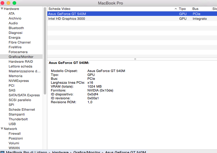

gengik84 Posted September 1, 2015 Share Posted September 1, 2015 Prova a mettere sul config inject nvidia... La grafica integrata è riconusciuta. Link to comment https://www.insanelymac.com/forum/topic/307851-asus-x53sv-togliere-il-null/#findComment-2164950 Share on other sites More sharing options...
lidiano Posted September 1, 2015 Author Share Posted September 1, 2015 Fatto adesso mi vede quanta Vram c'è Link to comment https://www.insanelymac.com/forum/topic/307851-asus-x53sv-togliere-il-null/#findComment-2164977 Share on other sites More sharing options...
gengik84 Posted September 1, 2015 Share Posted September 1, 2015 ok,ora va bene... Link to comment https://www.insanelymac.com/forum/topic/307851-asus-x53sv-togliere-il-null/#findComment-2164978 Share on other sites More sharing options...
lidiano Posted September 1, 2015 Author Share Posted September 1, 2015 peccato solo che non venga usata visto che usa solo quella integrata mi sai aiutare anche sul far funzionare iMessage Link to comment https://www.insanelymac.com/forum/topic/307851-asus-x53sv-togliere-il-null/#findComment-2164979 Share on other sites More sharing options...
gengik84 Posted September 1, 2015 Share Posted September 1, 2015 Per iMessage devi seguire una delle guide sul forum. quel "peccato" che hai detto era riferito a prima... ora che la scheda è riconosciuta correttamente, viene usata quella... Link to comment https://www.insanelymac.com/forum/topic/307851-asus-x53sv-togliere-il-null/#findComment-2164987 Share on other sites More sharing options...
