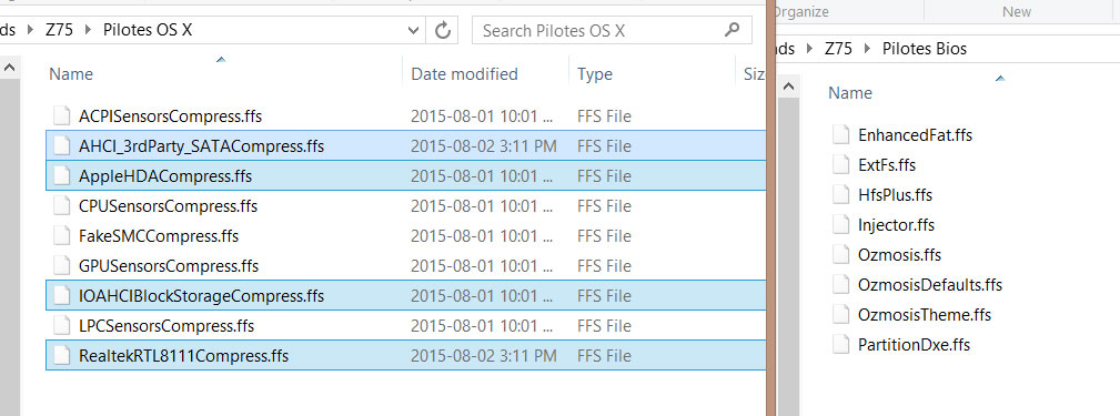

gablabelle Posted August 2, 2015 Share Posted August 2, 2015 *** UPDATED at the bottom Hello,So I have the following build on which I'm trying to install Yosemite (vanilla installation with no bootleader):- AsRock z75 Pro3 (UEFI, Flashed BIOS with Ozmosis)- Intel i7-2600k Unlocked CPU- Corsair Vengeance 1600MHz DDR3 Ram - 16GB- Nzxt S340- Corsair H60 Water Cooling Unit- Corsair 120Go Force3 SATA 3 SSD- Corsair HX650W ATHere under is the config.plist (OzmosisDefault.plist) file that I've convert to OzmosisDefault.ffs (Found the config.plist there:http://www.insanelymac.com/forum/top...rock-z75-pro3/but not sure it was a good idea, maybe I should use the default one? ) <?xml version="1.0" encoding="UTF-8"?> <!DOCTYPE plist PUBLIC "-//Apple//DTD PLIST 1.0//EN" "http://www.apple.com/DTDs/PropertyList-1.0.dtd"> <plist version="1.0"> <dict> <key>ACPI</key> <dict> <key>DSDT</key> <dict> <key>Debug</key> <false/> <key>DropOEM_DSM</key> <false/> <key>Name</key> <string>DSDT.aml</string> <key>ReuseFFFF</key> <false/> </dict> <key>SSDT</key> <dict> <key>DropOem</key> <true/> <key>Generate</key> <dict> <key>CStates</key> <false/> <key>PStates</key> <false/> </dict> </dict> </dict> <key>Boot</key> <dict> <key>Arguments</key> <string>-xcpm kext-dev-mode=1</string> <key>Log</key> <false/> <key>Secure</key> <false/> <key>Timeout</key> <integer>1</integer> <key>XMPDetection</key> <string>Yes</string> </dict> <key>Devices</key> <dict> <key>USB</key> <dict> <key>AddClockID</key> <true/> <key>FixOwnership</key> <true/> <key>HighCurrent</key> <true/> <key>Inject</key> <true/> </dict> </dict> <key>GUI</key> <dict> <key>Language</key> <string>it:0</string> <key>Mouse</key> <dict> <key>DoubleClick</key> <integer>500</integer> <key>Enabled</key> <false/> <key>Mirror</key> <false/> <key>Speed</key> <integer>8</integer> </dict> <key>Scan</key> <true/> <key>ScreenResolution</key> <string>1920x1080</string> </dict> <key>Graphics</key> <dict> <key>Inject</key> <dict> <key>ATI</key> <false/> <key>Intel</key> <false/> <key>NVidia</key> <false/> </dict> </dict> <key>KernelAndKextPatches</key> <dict> <key>AppleRTC</key> <true/> <key>AsusAICPUPM</key> <true/> </dict> <key>SMBIOS</key> <dict> <key>BiosReleaseDate</key> <string>10/12/2012</string> <key>BiosVendor</key> <string>Apple Inc.</string> <key>BiosVersion</key> <string>IM131.88Z.010A.B05.1210121459</string> <key>Board-ID</key> <string>Mac-FC02E91DDD3FA6A4</string> <key>BoardManufacturer</key> <string>Apple Inc.</string> <key>BoardType</key> <integer>10</integer> <key>ChassisAssetTag</key> <string>iMac-Aluminum</string> <key>ChassisManufacturer</key> <string>Apple Inc.</string> <key>ChassisType</key> <string>13</string> <key>Family</key> <string>iMac</string> <key>Manufacturer</key> <string>Apple Inc.</string> <key>Mobile</key> <false/> <key>ProductName</key> <string>iMac13,2</string> <key>SerialNumber</key> <string>C02KCAWEDNMP</string> <key>Trust</key> <false/> <key>Version</key> <string>1.0</string> </dict> <key>SystemParameters</key> <dict> <key>InjectKexts</key> <string>Yes</string> </dict> </dict> </plist> If you look at the attached z75.jpg, you will see a list of the kexts I've included in the BIOS I've patched but when booting the USB installation disk I get the circle with the line.I end up trying with less kexts. They are the highlighted ones on the left list. The right list kext where still included into the new patched BIOS. I even tried with none the kexts on the left but end with the circle with the line anyway. My BIOS settings are optimized defaut, Share memory to 32MB, disabled serial port, ACPI, really don't know what to try next.1) Is there a way to start the installation in verbose mode with a vanilla Yosemite USB installation ?2) Any help would be greatly appreciated. What am I missing? My guess would be this OzmosisDefaults.plist file but I'm not sure. *** UPDATE I was able to boot in verbose mode using Windows+V keys Then I get the following error attached in the screenshot Link to comment https://www.insanelymac.com/forum/topic/307406-ozmosis-stuck-on-the-circle-with-line-at-the-yosemite-installation-patched-bios-with-ozmosis/ Share on other sites More sharing options...
al6042 Posted August 4, 2015 Share Posted August 4, 2015 What Version of Ozmosis are you using? If it's 1479 would you check if you have an hidden EFI-Partition on your Harddisk(s)? If so, you would be able to use an Defaults.plist in the directory /EFI/Oz, in which you set all the necessary entries without tempering with the UEFI-Flashrom every time. The file itself should look like: <?xml version="1.0" encoding="UTF-8"?> <!DOCTYPE plist PUBLIC "-//Apple//DTD PLIST 1.0//EN" "http://www.apple.com/DTDs/PropertyList-1.0.dtd"> <plist version="1.0"> <dict> <key>Defaults:1F8E0C02-58A9-4E34-AE22-2B63745FA101</key> <dict> <key>BootEntryTemplate</key> <string>$label</string> <key>DarwinDiskTemplate</key> <string>$label</string> <key>DarwinRecoveryDiskTemplate</key> <string>$label</string> <key>DisableIntelInjection</key> <false/> <key>DisableNvidaInjection</key> <false/> </dict> <key>Defaults:4D1FDA02-38C7-4A6A-9CC6-4BCCA8B30102</key> <dict> <key>BaseBoardAssetTag</key> <string>Base Board Asset Tag#</string> <key>BaseBoardSerial</key> <string>Deine SystemSerial auf 17 Stellen erweitert</string> <key>BiosDate</key> <string>From CloverConfigurator</string> <key>BiosVersion</key> <string>From CloverConfigurator</string> <key>BoardVersion</key> <string>Proto1</string> <key>ChassisAssetTag</key> <string>From CloverConfigurator</string> <key>EnclosureType</key> <integer>13</integer> <key>FirmwareFeatures</key> <integer>2147488791</integer> <key>FirmwareFeaturesMask</key> <integer>3221487415</integer> <key>FirmwareRevision</key> <integer>65546</integer> <key>FirmwareVendor</key> <string>Apple</string> <key>HardwareAddress</key> <string>Your MAC-address of en0 as XX:XX:XX:XX:XX:XX</string> <key>HardwareSignature</key> <string>From Apple MAC Hack Field Hardware UUID</string> <key>Manufacturer</key> <string>From CloverConfigurator</string> <key>ProcessorSerial</key> <string>Copy from SystemSerial</string> <key>ProductFamily</key> <string>From CloverConfigurator</string> <key>ProductId</key> <string>From CloverConfigurator</string> <key>ProductName</key> <string>From CloverConfigurator</string> <key>SystemSKU</key> <string>System SKU#</string> <key>SystemSerial</key> <string>From CloverConfigurator, also used for ProcessorSerial and BaseBoardSerial</string> <key>SystemVersion</key> <string>1.0</string> <key>platform-uuid</key> <string>From Apple MAC Hack Field System UUID</string> </dict> <key>Defaults:7C436110-AB2A-4BBB-A880-FE41995C9F82</key> <dict> <key>boot-args</key> <string>kext-dev-mode=1 darkwake=8</string> </dict> <key>Timestamp</key> <integer>0</integer> <key>Version</key> <string>1.0.1</string> </dict> </plist> Link to comment https://www.insanelymac.com/forum/topic/307406-ozmosis-stuck-on-the-circle-with-line-at-the-yosemite-installation-patched-bios-with-ozmosis/#findComment-2157793 Share on other sites More sharing options...
