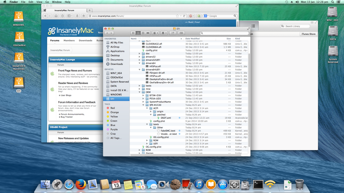

fusion71au Posted June 20, 2015 Share Posted June 20, 2015 @gemins, I'm assuming you are changing your computer's motherboard not your own mother ??? Joking aside, you most likely will need to change/tweak some of your configuration files in order to boot and run OSX on the new hardware eg new bootloader plist, SMBIOS, DSDT/SSDT, kexts eg for audio,lan. If you use Clover as your boot loader, its quite possible to keep multiple hardware configurations (each with its own config.plist, DSDT/SSDT, injected kexts) stored in the EFI/Clover/OEM folder ---> boot multiple systems with the same vanilla OSX installation. eg I have OSX installed on an external USB HD and use Clover's OEM folder to store multiple different hardware configs --->use this HD as an "emergency" OSX to multiboot several machines As you can see in the screenshot, I have the necessary files needed to boot the XPS M1530 in the folder "XPS M1530" inside Clover's OEM folder. I also have the Clover configuration files for my newer desktop based on a UEFI capable GAB75M-D3H motherboard in the B75M-D3H folder..... So I am able to boot OSX on my legacy XPS M1530 laptop through Clover EFI and my GA-B75M-D3H through its native UEFI firmware using the same USB Hard drive . 2 Link to comment https://www.insanelymac.com/forum/topic/306748-i-will-change-my-mother-with-ios-install-right-now/#findComment-2146616 Share on other sites More sharing options...
