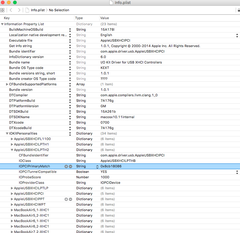

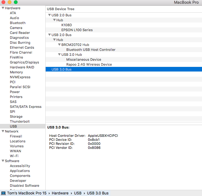

TomHsiung Posted August 22, 2015 Share Posted August 22, 2015 Mine USB3.0 displayed abnormally. Device ID: 8086 8cb1 Link to comment https://www.insanelymac.com/forum/topic/306586-usb-30-drives-not-recognized-by-os-x-1011/#findComment-2162556 Share on other sites More sharing options...
