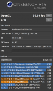

Pavo Posted June 8, 2015 Share Posted June 8, 2015 the 290X gets full acceleration without and with injection, framebuffer patch only allows you to use more than 1 monitor, if you are using 1 monitor then you don't need to injection or framebuffer patch below is a Cinebeach score with my 290X 8Gb without injection: Link to comment https://www.insanelymac.com/forum/topic/306511-sapphire-r9-290x-problems/#findComment-2142731 Share on other sites More sharing options...

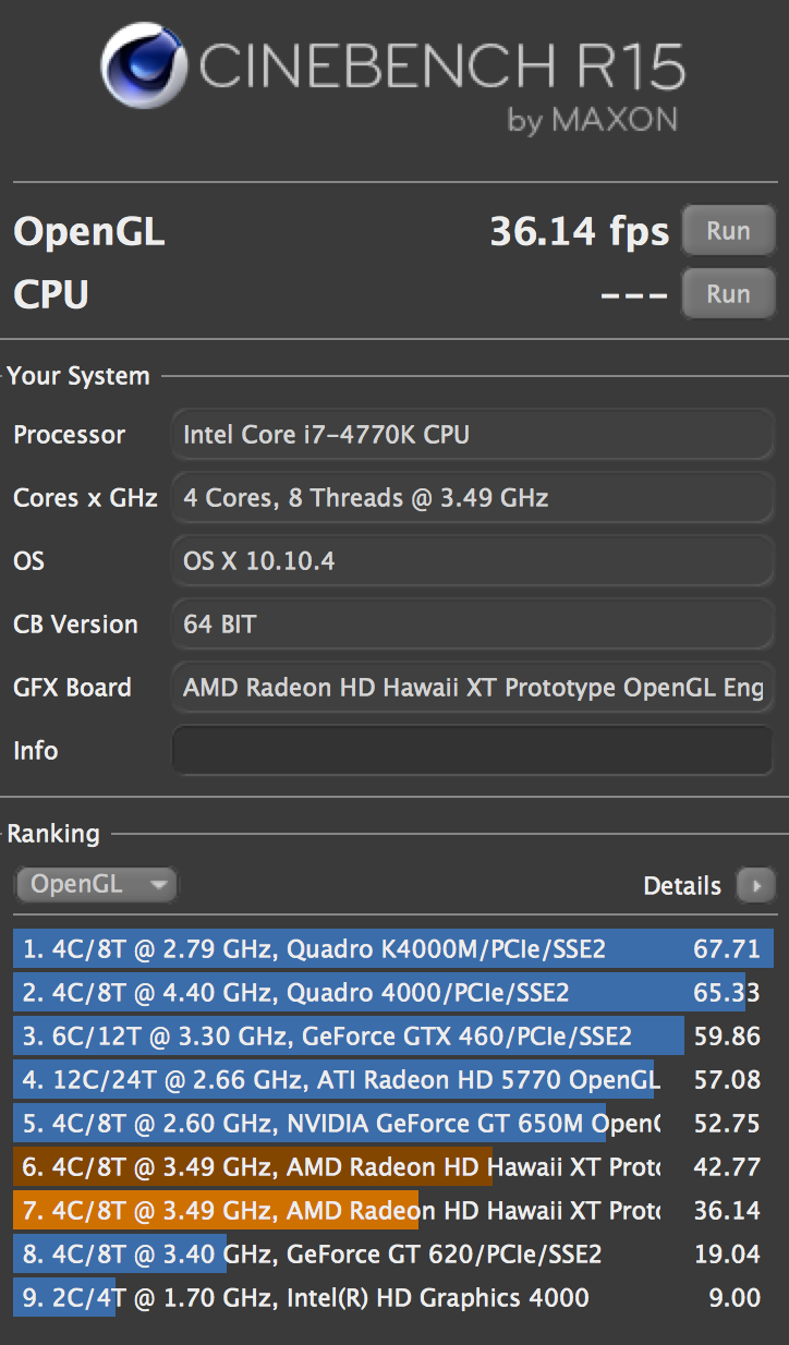

Picasso Posted August 19, 2015 Share Posted August 19, 2015 I was reading all the thread about 290X, and the Cinebench uploaded for Pavo has the same result as my old 7970. I had a 280X too, and works very similar! So, I thinks 290X is not working with full acceleration. I think, for the specification have to work with more FPS. Maybe I am wrong. I'm very interesting to get 290X working. Link to comment https://www.insanelymac.com/forum/topic/306511-sapphire-r9-290x-problems/#findComment-2161710 Share on other sites More sharing options...

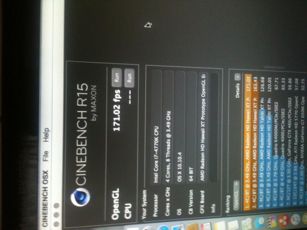

Picasso Posted August 23, 2015 Share Posted August 23, 2015 My test 290X Radeon Sapphire 4 GB. Link to comment https://www.insanelymac.com/forum/topic/306511-sapphire-r9-290x-problems/#findComment-2162926 Share on other sites More sharing options...
