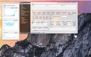

Followed clover guide installed Yosemite 10.10.3 made post changes from rampaged files X79 system runs nice ,just needs more fine tuning ,Speed step seems to work ,but it throttles max at 3.5 not 3.8(i73930k 3.2-3.8 turbo,not sure why ,sleep works ,but does not wake once it' sleeps,remains black screen,have win8.1 on another drive it runs well sleep works wakes ,I'm new to Clover and UEFI bios type setups ,If pointed in correct direction I would like to figure this out ,after looking into Clover's Glossary it's not clear what all settings are for ,I guess I'm not in the know ,I thought about Chameleon ,but seems to be limited as with Clover setup.
The Intel board DX79SR bios is updated to latest 6.50 version ;I try to keep bios setting simple but it's bit hard to follow with various settings power settings C4,C5,C6,it remains default at C4 directed at S3,not sure what that means exactly,also speed step is enabled as well as custom power which is also default. I'm thinking I need to tweak the kernel in Yosemite and or SSDT to get turbo native and sleep working correctly. I generated an "f4" DDST from clover and that did something but not entirely sure as Clover works with on the fly patching process sounds cool ,but no joy in making my rig work 100%.i know it's capable just need more info on the final tweaks .

Updated  used  SSDT to over clock  seems to work nicely ,all ports work 3.0 USB SATA 3  ALL Natively, with Clover  method ,and patched AppleIntelCPUPowerManagement.kext ,what I've learned is that  these X79 boards do not support OsX86  Vanilla CPUPM,from 2011socket LGA ,bummer...after having been spoiled with the "BadAxe2" board i was hoping to have same results ,only thing I can Not get working is waking from SLEEP function ..and Clover website state you may need to patch the DDST in the "GPE" section ,or not proper initialized PCI dev,AppleHDA, which I  have patched HDA kext and injector kext ,i tried  removing  them and still No wake function  ;and last there is  another beta GenericUSBXHCI_1.7_yoseite_14A329 that may prevent wake from sleep fix ,no joy  anyone  know how I could patch GPE section of Clover extracted DDST file ?
