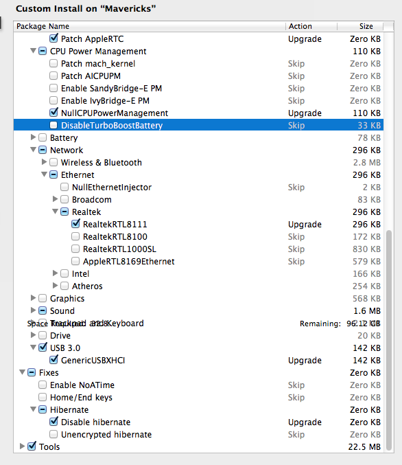

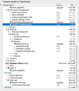

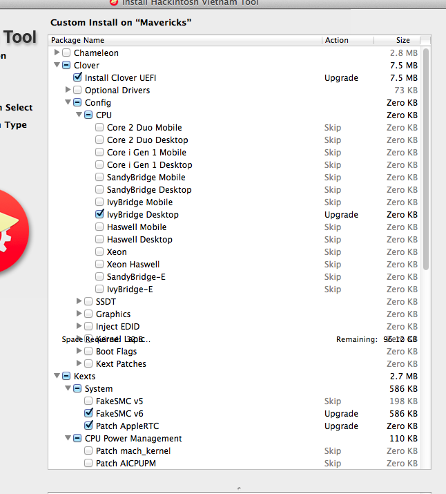

arcone Posted May 25, 2015 Author Share Posted May 25, 2015 hopefully I managed to upload the two screen dumps... could not fit all into one jpeg. Quote Link to comment https://www.insanelymac.com/forum/topic/306274-asus-p8h61mx-usb3/#findComment-2138584 Share on other sites More sharing options...
Allan Posted May 25, 2015 Share Posted May 25, 2015 Put this boot arguments in your config.plist: -gux_defer_usb2 -gux_no_idle PS: You really have used NullCPU for your Hack? This will bring some problems for you. Quote Link to comment https://www.insanelymac.com/forum/topic/306274-asus-p8h61mx-usb3/#findComment-2138585 Share on other sites More sharing options...
arcone Posted May 28, 2015 Author Share Posted May 28, 2015 Put this boot arguments in your config.plist: -gux_defer_usb2 -gux_no_idle PS: You really have used NullCPU for your Hack? This will bring some problems for you. if you mean that my cpu will run at full speed 3.5 gig, I know, it does not exceed 33 deg C. My system will not boot without this, I get a panic. Someone said about a patched bios, but I have not seen any sign of this. in any case I remember when all cpus always ran at full speed. To be honest was more concerned with by nvidia 570 as it runs at 70 deg c. In windows I use a profile to make the fan faster. Not found this in mac yet. I will try the instructions you gave me as soon as I get a chance and report back. Kind regards, Tony Quote Link to comment https://www.insanelymac.com/forum/topic/306274-asus-p8h61mx-usb3/#findComment-2139548 Share on other sites More sharing options...
arcone Posted May 30, 2015 Author Share Posted May 30, 2015 Thank you Allan for your help. usb now appears to be fully working. I did not do this quite the way you said, the argument has been entered into the config.plist, however I used clover configurator, in the boot section the argument appears, so I ticked it having imported my plist file and then saved it... 1 Quote Link to comment https://www.insanelymac.com/forum/topic/306274-asus-p8h61mx-usb3/#findComment-2139931 Share on other sites More sharing options...
