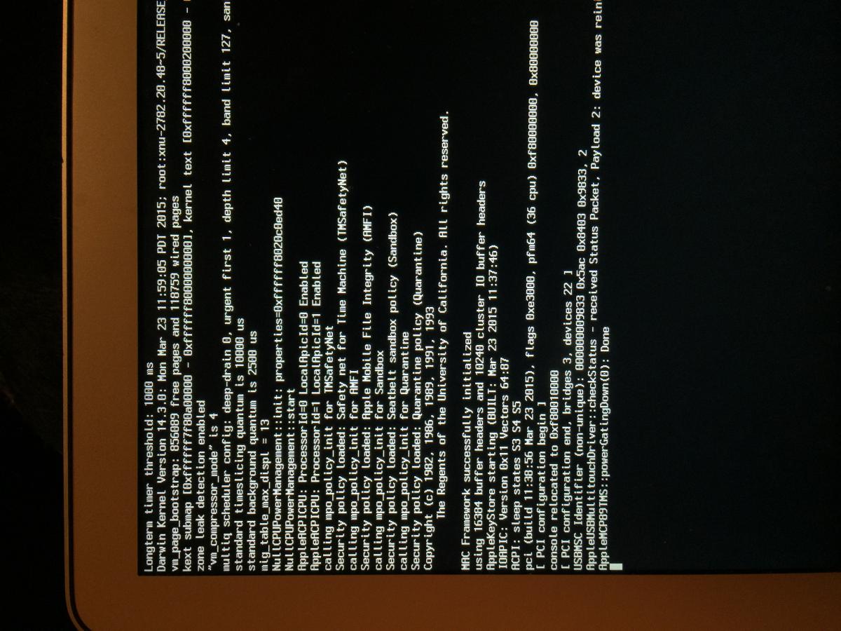

personavox Posted April 19, 2015 Share Posted April 19, 2015 Installed myhack.kext on Yosemite (Well I didn't; a buddy did thinking he was cool) This is a hackintosh type files. Verbose seizes as does single user mode and attempting to boot goes to fifty and no further. In verbose ending line. powerGatingDown Looking for commands and options I can use in terminal to not loose my data. Assuming I need to isolate this problem. Possibility of clover or chamoealn installed. So startup system. Single user is not working. Only able to boot into command R. Repair competed successfully. No change. Terminal seems to be only choice. I'm assuming hackintosh files were installed. Please help thanks. Link to comment https://www.insanelymac.com/forum/topic/305743-help_-os-x-yosemite-macbook-air-late-2010-accidental-install/ Share on other sites More sharing options...

Allan Posted May 16, 2015 Share Posted May 16, 2015 Here: cd /Volumes/ ls ( list of available partitions on the system ) cd “OS X partition name” mkdir /Backup cp –rf /System/Library/Extensions/myhack.kext /Backup rm –rf /System/Library/Extensions/myhack.kext ( if you want to delete this kext ) Use backup folder for your delete after you boot OS X. Link to comment https://www.insanelymac.com/forum/topic/305743-help_-os-x-yosemite-macbook-air-late-2010-accidental-install/#findComment-2135966 Share on other sites More sharing options...
