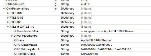

orobin Posted April 14, 2015 Share Posted April 14, 2015 Hello, I need some advice, please, I try to modify a kext file, and I think I miss something. I bought ( and made mistake but ...) a Dlink DLG 528 T. inside the cdrom provided with the card, there is driver (kext) called : AppleRTL8169.kext, for osx 10.4 I am running osx 10.10.2 so it does not work. then I got a driver here : http://www.insanelymac.com/forum/files/file/370-applertl8169ethernetkext/ I installed the kext with kext wizard, rebuild permission and rebuild kernel cache. it does not work, my card do not appear in the pref panel. then, I decided to try to mix the dlink driver, with the insanelymac driver : I looked into the kext, and looked the info.plist. in the dlink file, there is this in <dict> section : <key>DGE-528T</key> <dict> <key>CFBundleIdentifier</key> <string>com.apple.driver.AppleRTL8169Ethernet</string> <key>IOClass</key> <string>rtl8169</string> <key>IODefaultMedium</key> <string>00000020</string> <key>IOPCIPrimaryMatch</key> <string>0x43001186</string> <key>IOPCISecondaryMatch</key> <string>0x43001186</string> <key>IOProviderClass</key> <string>IOPCIDevice</string> </dict> I checked in the system info, : 0x43001186 is recognised for this card, by OSX. so I inserted this section above, in the info.plist of the insanelymac kext, save the result, uninstalled the one on my hackintosh, installed the modified one. I checked it the kext load properly : it does. it still not work. so my question : it could work doing that way ? then, what I am missing ? or it cannot work, and I need more work on that ? thanks for any advice, to help to modify my first kext. Olivier Link to comment https://www.insanelymac.com/forum/topic/305659-try-to-update-appletrl8169kext-but-need-advice/ Share on other sites More sharing options...

orobin Posted April 15, 2015 Author Share Posted April 15, 2015 Hello, thanks for the help. it is written, on the chipset : DLG 10028C OSX system info says, in PCI menu item : vendor ID : 0x1186 device ID : 0x4300 which are what I find in the original kext of DLINK ( in info.plist) I see it as a good news :-) I remind that the original driver are labeled AppleRTL8169Ethernet.kext.\ >Try the original one for Lion from Realtek/Downloads, unpack it, add it to IONetworkingFamily.kext/PlugIns and install it back to S/L/E with KextUtility. Bootargument in >Clover and Chameleon kext_dev_mode=1 and first reboot after installing by ignoring caches is mandatory. I´ll hope for you, that I am wrong with the PCI thing and you get >your card working. please, let me add detail, in order to be sure on my side that I understand well : I unpack the original kernel, and get the original kext ? it is located, in the driver, in Archive.pax/Archive or you are talking about the binary in the kext ? I am afraid that it will not work as it is a x86 driver, Yosemite is x64 >first reboot after installing by ignoring caches is mandatory. what does it mean ? on my side I always boot with clover, kext_dev_mode=1. should I not ? after installing a kext, I always fix permission, and rebuilt kernel cache, using kext wizard tool ( don't remember where I got this tool) sorry to request more detail, I am a bit lost. thanks Olivier [edit] I found what to put in IONetworking...kext Link to comment https://www.insanelymac.com/forum/topic/305659-try-to-update-appletrl8169kext-but-need-advice/#findComment-2128339 Share on other sites More sharing options...

spaham Posted August 28, 2015 Share Posted August 28, 2015 Hi ! I'm replying late, but this could be useful for other people. There's an easy way to get it working (cf http://www.tonymacx86.com/wiki/index.php/Network_Card_Database ) In order to do this you need to : - Install AppleRTL8169Ethernet.kext from (I see this name is banned, search on google and you'll easilly know where to get it). Inside that kext, there's a .plist that you need to edit by hand but it's quite simple : the file itself is here : /System/Library/Extensions/IONetworkingFamily.kext/Contents/PlugIns/AppleRTL8169Ethernet.kext/Contents/Info.plist but you'll get into permission problems if you try to edit it directly, so : - copy /System/Library/Extensions/IONetworkingFamily.kext/Contents/PlugIns/AppleRTL8169Ethernet.kext to your desktop edit AppleRTL8169Ethernet.kext/Contents/Info.plist at the bottom you'll see IOKitPersonalities, edit inside this : RTL8169/RTL8110 -> IOPCIPrimaryMatch (so that's IOKitPersonalities->RTL8110->IOPCIPrimaryMatch ) add 0x43001186 to the Values. ie mine looks like this : copy back AppleRTL8169Ethernet.kext from your desktop to /System/Library/Extensions/IONetworkingFamily.kext/Contents/PlugIns/ then clean permissions / update cache with kext wizard then reboot and voilà ! (hopefully) Link to comment https://www.insanelymac.com/forum/topic/305659-try-to-update-appletrl8169kext-but-need-advice/#findComment-2163967 Share on other sites More sharing options...
