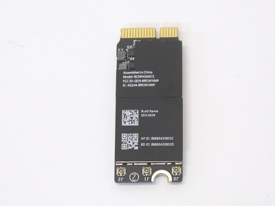

ergot Posted February 9, 2015 Share Posted February 9, 2015 hi all I have the original Apple WIFI+BT module that i want to connect my hackintosh...which way is the best way to connect it? What is the connection type on this module? will WIFI+BT will work OOTB? Thanks Link to comment https://www.insanelymac.com/forum/topic/304441-apple-wifi-and-bt-module/ Share on other sites More sharing options...

ergot Posted February 22, 2015 Author Share Posted February 22, 2015 thanks my module is:BCM94331CSAX BCM4331 Bluetooth BT+WLAN Card Module I purchesed this one: http://www.ebay.com/itm/Mini-PCI-E-Adapter-Card-for-BCM94331CD-BCM943224PCIEBT2-BCM94360CD-BCM94331CSAX-/321603948315?pt=LH_DefaultDomain_0&hash=item4ae116cf1b#ht_1088wt_908 Link to comment https://www.insanelymac.com/forum/topic/304441-apple-wifi-and-bt-module/#findComment-2113868 Share on other sites More sharing options...
sailor25462 Posted February 22, 2015 Share Posted February 22, 2015 So where do you intend to plug your wifi antenna into? From what I understood so far, you also need to attach the bluetooth to your internal usb Link to comment https://www.insanelymac.com/forum/topic/304441-apple-wifi-and-bt-module/#findComment-2113869 Share on other sites More sharing options...
ergot Posted February 22, 2015 Author Share Posted February 22, 2015 really? im not going to use wifi only BT...why need to plug it to a USB port? for power? isnt the power coming from the X1 slot? Link to comment https://www.insanelymac.com/forum/topic/304441-apple-wifi-and-bt-module/#findComment-2113881 Share on other sites More sharing options...
VirusX Posted February 22, 2015 Share Posted February 22, 2015 BT is powered via internal USB and Wifi is powered by PCI-E. Those adapter cards from ebay usually have antennas for both Wifi and BT and a USB connector cable included 1 Link to comment https://www.insanelymac.com/forum/topic/304441-apple-wifi-and-bt-module/#findComment-2113894 Share on other sites More sharing options...
