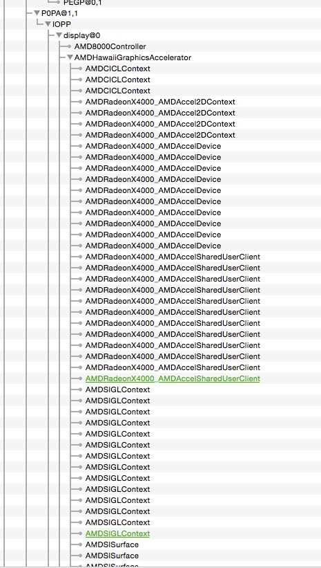

darkip Posted June 15, 2015 Share Posted June 15, 2015 I'm using iMac14,2 (automatic from Clover). So I had a spare Z68 board around and I thought I'd try the GPU in there. Turns out the fans sped up correctly on that board. Need to double check this. So I investigated further and found that only on the Z68 board did the gpu-control entry appear: So maybe this is something that needs to be patched with a DSDT / SSDT edit? Link to comment https://www.insanelymac.com/forum/topic/304386-el-capitan-1011-r9-290x-2/page/2/#findComment-2145420 Share on other sites More sharing options...

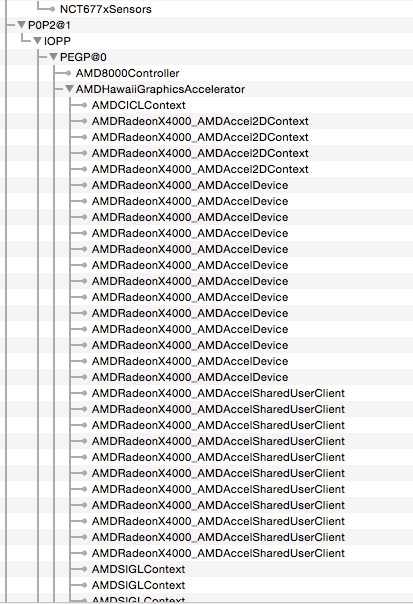

darkip Posted June 16, 2015 Share Posted June 16, 2015 So I double checked the GPU in the other board (Z68) and the fans definitely do spin up. I also tried setting the SMBIOS of the Z68 machine to MacPro6,1 and despite the gpu-control device disappearing from the ioreg, the fans still worked. So unfortunately that doesn't seem to be related. Here's a comparison of the IOReg GPU area for the from the Z68 machine and the Z97 (no fan speedup). Both are using MacPro6,1 SMBIOS: Z68 Z97 I wonder if the controller being underneath this "display@0" node rather than "PEGP@0" is causing a problem? Link to comment https://www.insanelymac.com/forum/topic/304386-el-capitan-1011-r9-290x-2/page/2/#findComment-2145555 Share on other sites More sharing options...
darkip Posted June 16, 2015 Share Posted June 16, 2015 I had a closer look at the device-id's and I think the problem is the PLX chip on our boards. The PLX chip sits between PEG0 (the PCI-E controller on the processor) and what is being labelled "display" (what I believe is the actual GPU device). I'm guessing the PLX chip being labelled PEG0 rather than actual GPU device is preventing the driver talking to the card for some reason. I think we need DSDT modification assistance. Link to comment https://www.insanelymac.com/forum/topic/304386-el-capitan-1011-r9-290x-2/page/2/#findComment-2145573 Share on other sites More sharing options...

darkip Posted July 3, 2015 Share Posted July 3, 2015 So I've fixed my fan issue. All it took was disassembling the driver and finding some hidden debugging flags Add the following to AMD8000Controller/Contents/Info.plist in the aty_properties dictionary <key>PP_PcieDpmDisabled</key> <integer>1</integer> I'm now running into 2D acceleration issues - When I play a flash video fullscreen it's very stuttery. Anyone else with similar issues? Link to comment https://www.insanelymac.com/forum/topic/304386-el-capitan-1011-r9-290x-2/page/2/#findComment-2150393 Share on other sites More sharing options...
