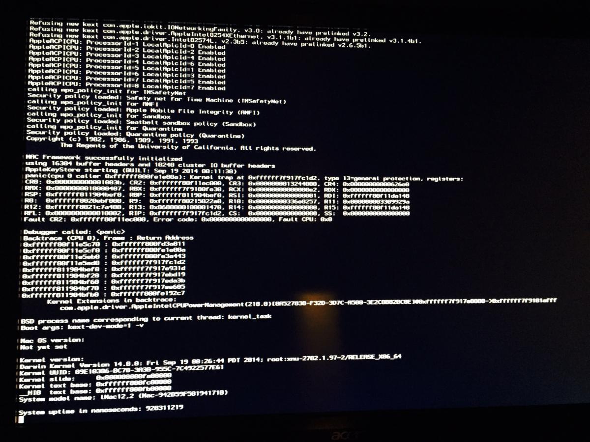

redcoatd Posted January 10, 2015 Share Posted January 10, 2015 Hi, New to all this, but struggling to find help to learn how to solve panic on Dell XPS 8300 that I just installed Yosemite on. I actually posted here: http://www.insanelymac.com/forum/topic/303791-please-help-panic-on-dell-xps-8300/ but thinking this is a better place to ask. Could anyone *please* point me in the right direction - I need to figure out how to avoid the panic, but still support Sleep / WOL. Processor a Main Circuit Board b 3.40 gigahertz Intel Core i7-2600256 kilobyte primary memory cache1024 kilobyte secondary memory cache8192 kilobyte tertiary memory cache64-bit readyMulti-core (4 total)Hyper-threaded (8 total) Board: Dell Inc. 0Y2MRG A00Serial Number: ..CN7360415401D9.Bus Clock: 100 megahertzBIOS: Dell Inc. A03 02/15/2011 original DSDT and panic screen shot attached. Would be very grateful for some guidance / help! cheers! David dsdt.bot.zip Link to comment https://www.insanelymac.com/forum/topic/303825-appleintelcpupowermanagement-panic-in-dell-xps-8300/ Share on other sites More sharing options...
kvonlinee Posted January 10, 2015 Share Posted January 10, 2015 What bootloader you are using? Try to run your machine with clover. Incase you run with chameleon, you properly need nullcpupowermanagemwnt.kext. Under maverick, sleepenabler.kext help alot. Not sure it would help or not on yosmity. Link to comment https://www.insanelymac.com/forum/topic/303825-appleintelcpupowermanagement-panic-in-dell-xps-8300/#findComment-2102014 Share on other sites More sharing options...
wartomato Posted January 10, 2015 Share Posted January 10, 2015 Hi, New to all this, but struggling to find help to learn how to solve panic on Dell XPS 8300 that I just installed Yosemite on. I actually posted here: http://www.insanelymac.com/forum/topic/303791-please-help-panic-on-dell-xps-8300/ but thinking this is a better place to ask. Could anyone *please* point me in the right direction - I need to figure out how to avoid the panic, but still support Sleep / WOL. Processor a Main Circuit Board b 3.40 gigahertz Intel Core i7-2600 256 kilobyte primary memory cache 1024 kilobyte secondary memory cache 8192 kilobyte tertiary memory cache 64-bit ready Multi-core (4 total) Hyper-threaded (8 total) Board: Dell Inc. 0Y2MRG A00 Serial Number: ..CN7360415401D9. Bus Clock: 100 megahertz BIOS: Dell Inc. A03 02/15/2011 original DSDT and panic screen shot attached. Would be very grateful for some guidance / help! cheers! David Hi, I guess this is a fresh install? - 1. Install NullCPUPowermanagement.kext with KextWizard (or any other tool you have) and 2. rebuilt the kernel cache. 3. You have to boot with "kext-devs-mode=1" or the system will not load unsigned or altered kernel extensions. After the reboot, you can then patch the SSDT (not your DSDT) with AICPMPatch to get the Speedstepping fully working. Oh, you can copy the kernel extension with Win, if you have a dual boot system and some driver for Win like Paragon's HFS+ for Windows. Might help a lot... ;-) Link to comment https://www.insanelymac.com/forum/topic/303825-appleintelcpupowermanagement-panic-in-dell-xps-8300/#findComment-2102024 Share on other sites More sharing options...
redcoatd Posted January 10, 2015 Author Share Posted January 10, 2015 Thanks for the replies!! @kvonlinee: booting with Clover. I followed this guide to dual boot Yosemite and Win 7 using UEFI, even though I have legacy BIOS: http://www.insanelymac.com/forum/topic/303615-guide-install-windows-8-uefi-on-legacy-bios-with-clover-and-dual-boot-with-yosemite/ Hi, I guess this is a fresh install? - 1. Install NullCPUPowermanagement.kext with KextWizard (or any other tool you have) and 2. rebuilt the kernel cache. 3. You have to boot with "kext-devs-mode=1" or the system will not load unsigned or altered kernel extensions. After the reboot, you can then patch the SSDT (not your DSDT) with AICPMPatch to get the Speedstepping fully working. Oh, you can copy the kernel extension with Win, if you have a dual boot system and some driver for Win like Paragon's HFS+ for Windows. Might help a lot... ;-) Yep, fresh install. I thought NullCPUPowermanagement prevented Sleep / WOL from working? I'll try tho I don't follow how exactly I patch the SSDT - what do I do after booting into Windows? cheers! David PS I have intel gigabit ct (82574l) ethernet pci-e card ethernet. Link to comment https://www.insanelymac.com/forum/topic/303825-appleintelcpupowermanagement-panic-in-dell-xps-8300/#findComment-2102144 Share on other sites More sharing options...
kvonlinee Posted January 10, 2015 Share Posted January 10, 2015 On clover, make sure you enable asuscpu to true, appleLPC to be true, it shout run w/o nullcpu kext. Load w/o cache and rebuild cache. Link to comment https://www.insanelymac.com/forum/topic/303825-appleintelcpupowermanagement-panic-in-dell-xps-8300/#findComment-2102159 Share on other sites More sharing options...
wartomato Posted January 11, 2015 Share Posted January 11, 2015 On clover, make sure you enable asuscpu to true, appleLPC to be true, it shout run w/o nullcpu kext. Load w/o cache and rebuild cache. Yep, if you are using Clover then follow kvonlinee's tips. I am using Chameleon to dual boot Yosemite and Win8.1 on non-UEFI BIOS notebook :-) Link to comment https://www.insanelymac.com/forum/topic/303825-appleintelcpupowermanagement-panic-in-dell-xps-8300/#findComment-2102255 Share on other sites More sharing options...
redcoatd Posted January 12, 2015 Author Share Posted January 12, 2015 On clover, make sure you enable asuscpu to true, appleLPC to be true, it shout run w/o nullcpu kext. Load w/o cache and rebuild cache. Thanks! Loading w/o cache allowed it to load. Dumb question - how do I rebuild cache? Next issue: Ethernet is not showing up - in logs I see "Refusing new kext com.apple.driver.AppleIntel8254XEthernet, v3.1.1b1: already have prelinked v3.1.04b1. I do have IONetworkingFamily.kext installed for my intel gigabit ct (82574l) ethernet How do I fix that?! Grateful for the help... cheers! David Link to comment https://www.insanelymac.com/forum/topic/303825-appleintelcpupowermanagement-panic-in-dell-xps-8300/#findComment-2102390 Share on other sites More sharing options...
kvonlinee Posted January 12, 2015 Share Posted January 12, 2015 Kext wizard, install and rebuild cache. Link to comment https://www.insanelymac.com/forum/topic/303825-appleintelcpupowermanagement-panic-in-dell-xps-8300/#findComment-2102398 Share on other sites More sharing options...
redcoatd Posted January 12, 2015 Author Share Posted January 12, 2015 Ah, thanks! I told you I was new to all this Ok, so I can load via Clover now and ethernet shows up. The machine goes to sleep, too, but nothing happens when I send magic packet to try and use Wake On Lan. Also, when I press the power button, the computer wakes up, but monitor is stuck asleep, and I have to power down completely. How would I go about fixing this? cheers David Link to comment https://www.insanelymac.com/forum/topic/303825-appleintelcpupowermanagement-panic-in-dell-xps-8300/#findComment-2102460 Share on other sites More sharing options...
