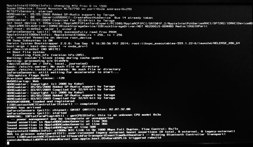

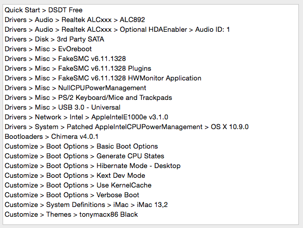

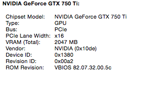

clver16 Posted December 26, 2014 Share Posted December 26, 2014 I have installed yosemite in my pc my specs are as follows i7 3770 P8Z77 V Pro ThunderboltGeforce GTX 750 Ti (palit)this is my third post because i was changing graphics card. please bear with meI installed nvidia web driver to enable full Acceleration on this cardI posted my Multicast log, my verbose and what yosemites detects from my card^^ please post if you need more info.The Last line in my verbose is missing bluetooth controller transport and i used the move all intelhd and at to intel_back. it worked one time i was able to get into the desktop without safe mode then i chose in the system preference to use nvidia web driver and i rebooted then stuck again help ^^ my sambas is mac 13,2 do i need to change?^^ Link to comment https://www.insanelymac.com/forum/topic/303573-cant-boot-only-safe-mode-geforce-gtx-750-ti-maxwell-help/ Share on other sites More sharing options...
jamiethemorris Posted December 26, 2014 Share Posted December 26, 2014 Are you using nvda_drv=1 ? Link to comment https://www.insanelymac.com/forum/topic/303573-cant-boot-only-safe-mode-geforce-gtx-750-ti-maxwell-help/#findComment-2098089 Share on other sites More sharing options...
clver16 Posted December 26, 2014 Author Share Posted December 26, 2014 Yes^^ Link to comment https://www.insanelymac.com/forum/topic/303573-cant-boot-only-safe-mode-geforce-gtx-750-ti-maxwell-help/#findComment-2098104 Share on other sites More sharing options...

durpflip Posted December 30, 2014 Share Posted December 30, 2014 use mac pro smbios instead and use the latest web drivers (that support the GTX 970 and 980) from nvidia if you haven't already,i had to do that to get full accel. on my own strix GTX 750 ti. 1 Link to comment https://www.insanelymac.com/forum/topic/303573-cant-boot-only-safe-mode-geforce-gtx-750-ti-maxwell-help/#findComment-2098993 Share on other sites More sharing options...
