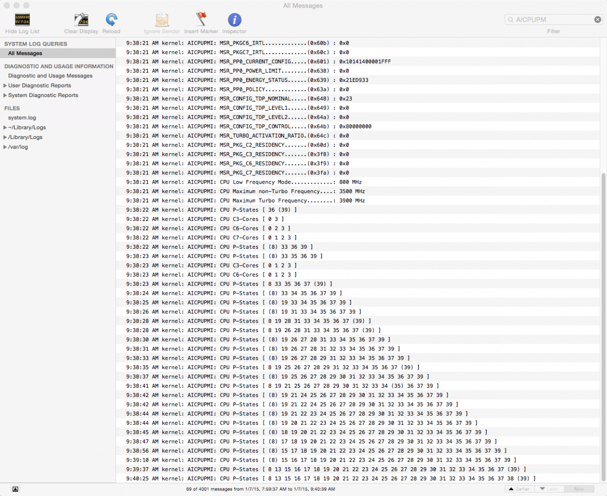

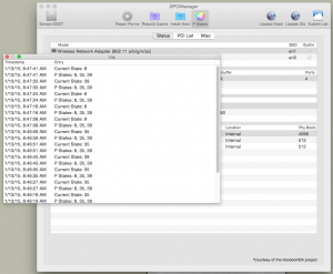

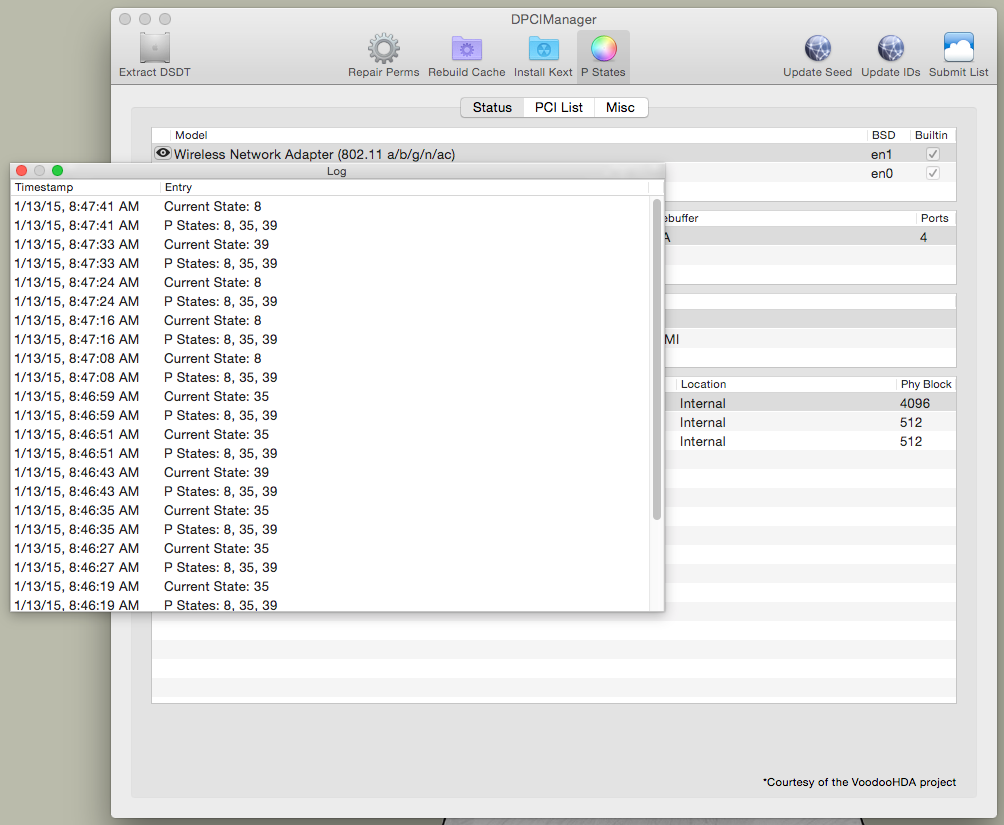

xouspring Posted January 2, 2015 Share Posted January 2, 2015 Hey thanks for the report. I have the same motherboard with i5 4690S except i have the stock HD4600 until the GTX960 comes out. I was wondering how many sates you have with your config speedstep wise? Turbo boost is working and so does idling speed but i think i'm missing steps in between. Checking DPCI manager i have : 02/01/2015 16:01:28, P States: 8, 32, 33, 34, 35, 36, 37, 38, 39 Also you say : "The AppleGraphicsPowerManagement.kext and IOPlatformPluginFamily.kext is edited acoording to my need" How do you do that? Thanks! Link to comment https://www.insanelymac.com/forum/topic/303424-report-asus-z97i-plus-gtx-770-yosemite-1010/#findComment-2099841 Share on other sites More sharing options...
aankun.ganteng Posted January 7, 2015 Author Share Posted January 7, 2015 Hey thanks for the report. I have the same motherboard with i5 4690S except i have the stock HD4600 until the GTX960 comes out. I was wondering how many sates you have with your config speedstep wise? Turbo boost is working and so does idling speed but i think i'm missing steps in between. Checking DPCI manager i have : 02/01/2015 16:01:28, P States: 8, 32, 33, 34, 35, 36, 37, 38, 39 Also you say : "The AppleGraphicsPowerManagement.kext and IOPlatformPluginFamily.kext is edited acoording to my need" How do you do that? Thanks! I hope I can explain this well AppleGraphicsPowerManagement.kext When you open Info.plist on AppleGraphicsPowerManagement.kext you will see a list of mac type such as MacPro, Macbook etc. In this case I use MacPro5,1. So I need to put my GPU Vendor and device ID inside the MacPro5,1 list. So for example my GPU is Vendor10deDevice1184 (GTX 770 ASUS DirectCU II) at the screenshot you can see my vendor and device ID, below that is a set of instruction that i copy from Vendor10deDevice119e. 10de119e is GeForce GTX 780M Mac Edition. That is the closest GPU architecture that match my GPU. IOPlatformPluginFamily.kext Inside the PlugIns folder you will find X86PlatformPlugin.kext. Inside the resources folder you will see some plist files. That plist files represent Mac board id. Since I use MacPro SMBIOS and board id, which not available on that folder. I copy one of the plist that have the closest match on processor type. In my case is the iMac15,1 with Haswell processor. Copy the plist and rename it with your current board id on your SMBIOS information. When using DPCI Manager to check p-states, I also got missing states. Try use Piker's AppleCPUPowerManagementInfo.kext (http://www.insanelymac.com/forum/topic/298027-guide-aio-guides-for-hackintosh/?p=2020580). I think DPCI Manager only list the p-state that used at the moment. Some p-state might be change to fast so DPCI Manager can’t capture all of them. I hope this can help good luck my-kext.zip Link to comment https://www.insanelymac.com/forum/topic/303424-report-asus-z97i-plus-gtx-770-yosemite-1010/#findComment-2101356 Share on other sites More sharing options...

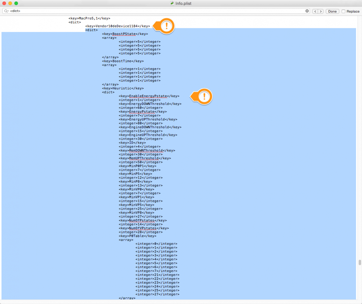

xouspring Posted January 11, 2015 Share Posted January 11, 2015 thanks for the reply! still only have 1 state and turbo states. Did you disable speedstep and turbo mode in uefi bios? I hope I can explain this well AppleGraphicsPowerManagement.kextWhen you open Info.plist on AppleGraphicsPowerManagement.kext you will see a list of mac type such as MacPro, Macbook etc. In this case I use MacPro5,1. So I need to put my GPU Vendor and device ID inside the MacPro5,1 list. So for example my GPU is Vendor10deDevice1184 (GTX 770 ASUS DirectCU II) at the screenshot you can see my vendor and device ID, below that is a set of instruction that i copy from Vendor10deDevice119e. 10de119e is GeForce GTX 780M Mac Edition. That is the closest GPU architecture that match my GPU.IOPlatformPluginFamily.kextInside the PlugIns folder you will find X86PlatformPlugin.kext. Inside the resources folder you will see some plist files. That plist files represent Mac board id. Since I use MacPro SMBIOS and board id, which not available on that folder. I copy one of the plist that have the closest match on processor type. In my case is the iMac15,1 with Haswell processor. Copy the plist and rename it with your current board id on your SMBIOS information.When using DPCI Manager to check p-states, I also got missing states. Try use Piker's AppleCPUPowerManagementInfo.kext (http://www.insanelymac.com/forum/topic/298027-guide-aio-guides-for-hackintosh/?p=2020580). I think DPCI Manager only list the p-state that used at the moment. Some p-state might be change to fast so DPCI Manager can’t capture all of them. I hope this can help good luck Link to comment https://www.insanelymac.com/forum/topic/303424-report-asus-z97i-plus-gtx-770-yosemite-1010/#findComment-2102350 Share on other sites More sharing options...

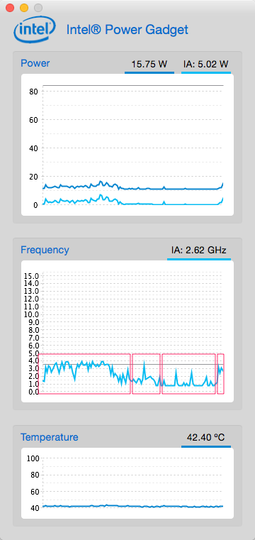

aankun.ganteng Posted January 13, 2015 Author Share Posted January 13, 2015 thanks for the reply! still only have 1 state and turbo states. Did you disable speedstep and turbo mode in uefi bios? Nope, the speedstep and turbo mode are enable on bios. Have you try intel power to check you CPU speed??? If the power gadget show speed between your lowest state speed (mine is 0.8GHz), and max-non-turbo speed (mine is 3.5GHz) when idle. It should be fine. As you can see on my sceenshot. The first red box is when I do browsing while listening to itunes and also open a bunch of app. the second box is when I closing all the app, the third is idle and doing nothing. And the last one is when I open skitch and take screenshot. So basically my processor work just fine, eventhough the DPCIManager show only 3 states. I think DPCIManager's p-state checker is already obsolete for Yosemite, maybe. (the last update on the download page is 2013-08-17) Link to comment https://www.insanelymac.com/forum/topic/303424-report-asus-z97i-plus-gtx-770-yosemite-1010/#findComment-2102607 Share on other sites More sharing options...
xouspring Posted January 14, 2015 Share Posted January 14, 2015 Yes i checked Intel Power Gadget and i guess my speedstep is working fine according to the graph. Just bugged me that i only get few steps but i'll leave it at that! Thanks again! And you're right, this mackintosh setup works very nicely! Nope, the speedstep and turbo mode are enable on bios. Have you try intel power to check you CPU speed??? If the power gadget show speed between your lowest state speed (mine is 0.8GHz), and max-non-turbo speed (mine is 3.5GHz) when idle. It should be fine. As you can see on my sceenshot. The first red box is when I do browsing while listening to itunes and also open a bunch of app. the second box is when I closing all the app, the third is idle and doing nothing. And the last one is when I open skitch and take screenshot. So basically my processor work just fine, eventhough the DPCIManager show only 3 states. I think DPCIManager's p-state checker is already obsolete for Yosemite, maybe. (the last update on the download page is 2013-08-17) Link to comment https://www.insanelymac.com/forum/topic/303424-report-asus-z97i-plus-gtx-770-yosemite-1010/#findComment-2102880 Share on other sites More sharing options...
