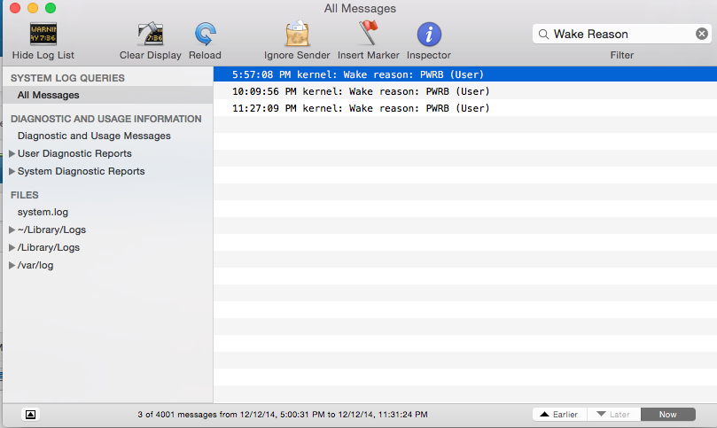

Trajic Posted December 13, 2014 Share Posted December 13, 2014 Hi guys/gals. Specs: GAH61m-DS2 Rev 2.2 Core i5 2500k EVGA GTX650 1024mb 8GB Corsair XMS3 120GB SSD OSX Yosemite 10.10.1 Issue: My hackintosh will not wake from sleep via my keyboard (apple wired USB) or my wireless logitech mouse. I have to manually press the button on the tower to awake it from a deep sleep. I spoke to a gentleman on hackintoshosx and he said to check my console and said it was related to PWRB in my DSDT and i need to patch it. I am not good with patching and such as my knowledge is limited. So i have some questions. Could you guys patch my DSDT or guide me on how to enable sleep with it? is my issue it even related to patching my DSDT? Here is the console message: Extra Notes: Using Clover 10.10.1 Nvidia Web drivers installed FakeSMC.kext & ethernet kext installed at /EFI/Clover/Kexts/10.10 Speed Step works Boot flags in Clover Config: NVDA_DRV=1 dart=0 kext-dev-mode=1 I will post my DSDT on request. Thanks! Hope to hear back Link to comment Share on other sites More sharing options...
copil Posted December 14, 2014 Share Posted December 14, 2014 Hello. You've tried to clear the check box Add ClockID? Open Clover Configurator open your config.plist -> in Devices -> USB -> Add ClockID uncheck this box Link to comment Share on other sites More sharing options...
Slice Posted December 15, 2014 Share Posted December 15, 2014 Not PRWB. If you can't wake by USB device then your USB bus is in deep sleep then is due to Clover's flag <key>USB</key> <dict> <key>AddClockID</key> <true/> Set to false and look again. Link to comment Share on other sites More sharing options...
