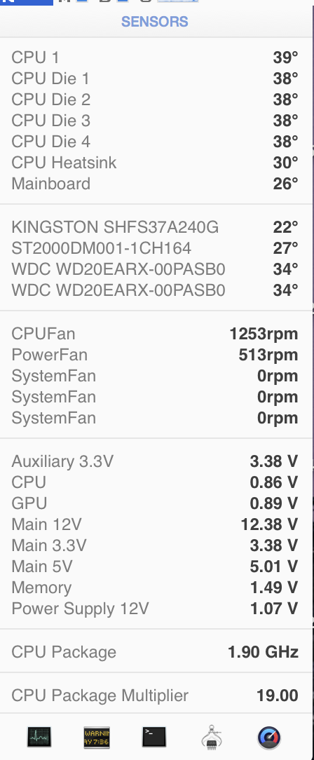

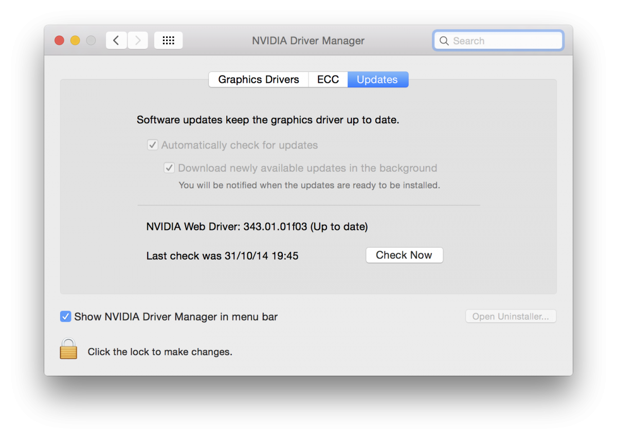

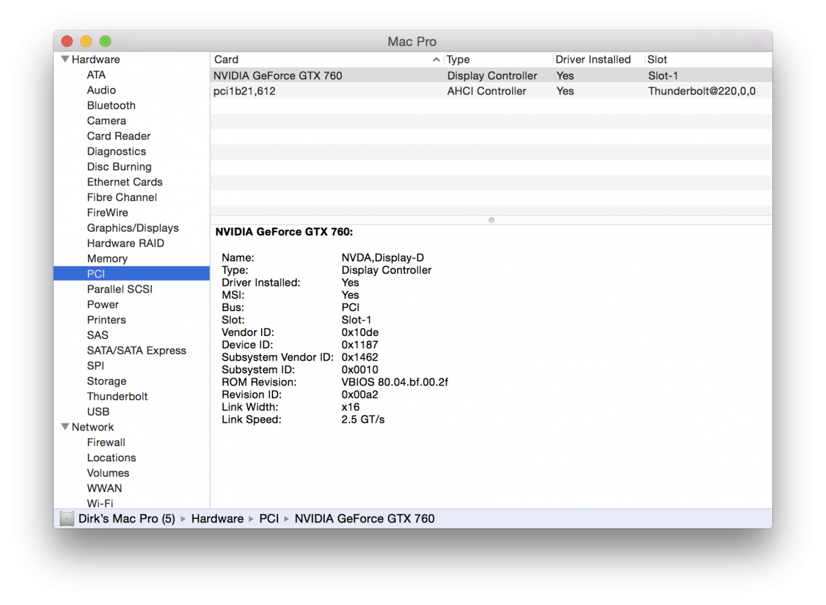

Redtigerxx Posted October 31, 2014 Share Posted October 31, 2014 Hi Guys, I recently bought the MSI GTX 760 so I could power mine 4K Dell monitor (MST). I got 60HZ to work via this topic (http://forums.macrumors.com/showthread.php?t=1760435&page=1). But one problem still exists. When Yosemite is loaded the fans of the video card go banana's. I think they run at their full speed, it's like having a hair dryer underneath your desk. I'm using the Nvidia web driver, because I need to power the screen at 60 HZ. When I use the stock driver, this problem doesn't exists. iStat menu doesn't show the GPU temperature or the fan speed. But here comes the weird part, when I put my Mac to sleep and activate it afterwards the fans aren't running at full speed. Does anybody has an idea what the problem is? Update: After sleep iStat does give the RPM and temperature. Link to comment https://www.insanelymac.com/forum/topic/302205-gtx-760-4k-60hz-and-fan-control/ Share on other sites More sharing options...
