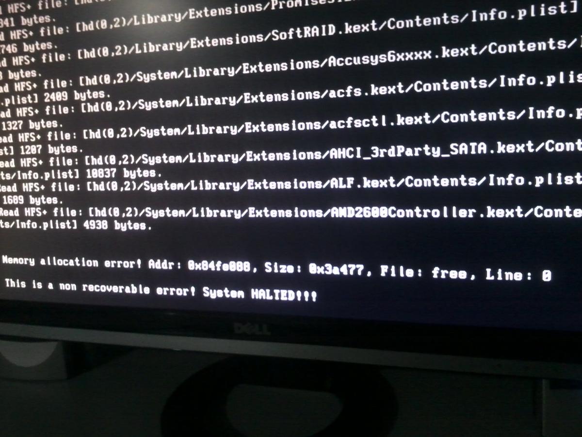

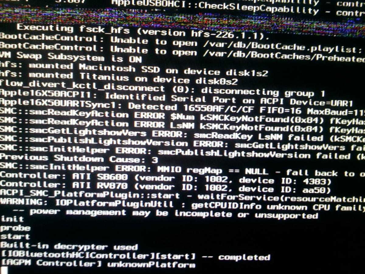

Eweie Posted October 11, 2014 Share Posted October 11, 2014 Hello, I've been using a radeon hd 4850 for the longest time, since snow leopard and all the way to the latest mavericks version without a problem. but recently I acquired a XFX ATI Radeon HD 5850 and just cant get it to work. I'm using the same installation I was using for the other card but even went ahead and deleted the kext i was using for it. It's my understanding that you're supposed to open up AMD5000Controller.kext and AMDRadeonX3000 and insert the device ID into IOPCIMatch in the controller and in AMDCypressGraphicsAccelerator > IOPCIMatch for the X3000 kext. but I'm getting no results. My device ID is 6899 it just boots into a grey screen, I cant see anything abnormal in verbose mode and I can ssh into the computer so seems the OS is working. I've tried with GraphicsEnabler yes and no I've tried setting the SMBios to Mac pro 5,1 and iMac 11,3 also tried several ATIconfigs but I'm not exactly sure which one to use. I'm using Chameleon. Am I missing something? I've read a ton of threads and I cant find a solution. I can boot into the os with -x and I see under the about this mac and system profiler that it says radeon hd 4850 and 5mb vram but shows the correct device ID for the HD 5850. Also this happens when I try to boot with -f to ignore the kext cache and sometimes when the screen doesn't go to grey this part of the verbose is left on the screen I don't know if theres anything weird in those last lines. but I can still ssh to the computer and file share from a mac. Please help me, I'm at my wits end. Link to comment https://www.insanelymac.com/forum/topic/301439-problems-installing-xfx-ati-radeon-hd-5850-in-mavericks-1095/ Share on other sites More sharing options...
