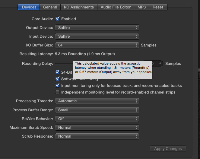

leukhin Posted October 10, 2014 Author Share Posted October 10, 2014 Well, will answer to my question myself. I took the risk for a third time (after buying ESI and E-MU). But this time I switched from USB to FireWire. So my choice fell on Focusrite products. According to my budget I bought Focusrite Saffire PRO 14 and STLab PCI FireWire interface on Texas Instruments controller. Everything worked out of the box. No driver installation, no fixes required. Both sound recording and playback performs fine. I have Intel Core i5-4570 3.2GHz on my board, and I tried 32 samples buffer. In sound i heard a quiet clicks but when I switch buffer to 64 samples everything went perfectly. So I recommend to use this sound card on OS X Yosemite. Here is my settings, you can see calculated latency value (Screen Shot 2014-10-10 at 10.16.24 AM.png) Good luck guys! And have nice sound. Link to comment https://www.insanelymac.com/forum/topic/300969-looking-for-working-usb-external-sound-card-for-yosemite-osx-1010/#findComment-2068018 Share on other sites More sharing options...
