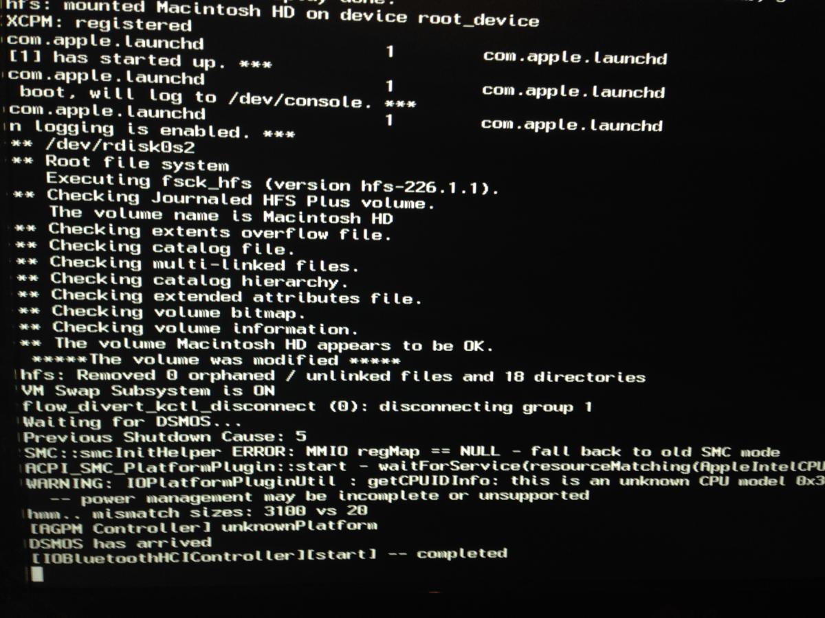

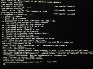

inonehalf Posted September 16, 2014 Share Posted September 16, 2014 Hi everybody. I'm trying to install OSX Mavericks and i cannot find a way to do it. I've read many posts but... nothing. I've tried all kind of flags and i cannot manage even to enter the installation process. I've tried -x for safe mode and the loading stucked (image). I really need help. I've been using OSX for a while now in a previous hackintosh that worked really good and dont need to boot with flags or anything else. And sorry for may english its not good at all. This is may configuration GA-B85M-D3H intel i5 4440 Intel Graphics HD4600 8GB RAM (4 and 4) Kingston HDD Sata 160GB (if the problem is the Hard Drive i cant try with Sata 2 1.5TB) LG 22EA53VA Quote Link to comment https://www.insanelymac.com/forum/topic/300908-ga-b85m-d3h-no-booting-even-with-flags/ Share on other sites More sharing options...

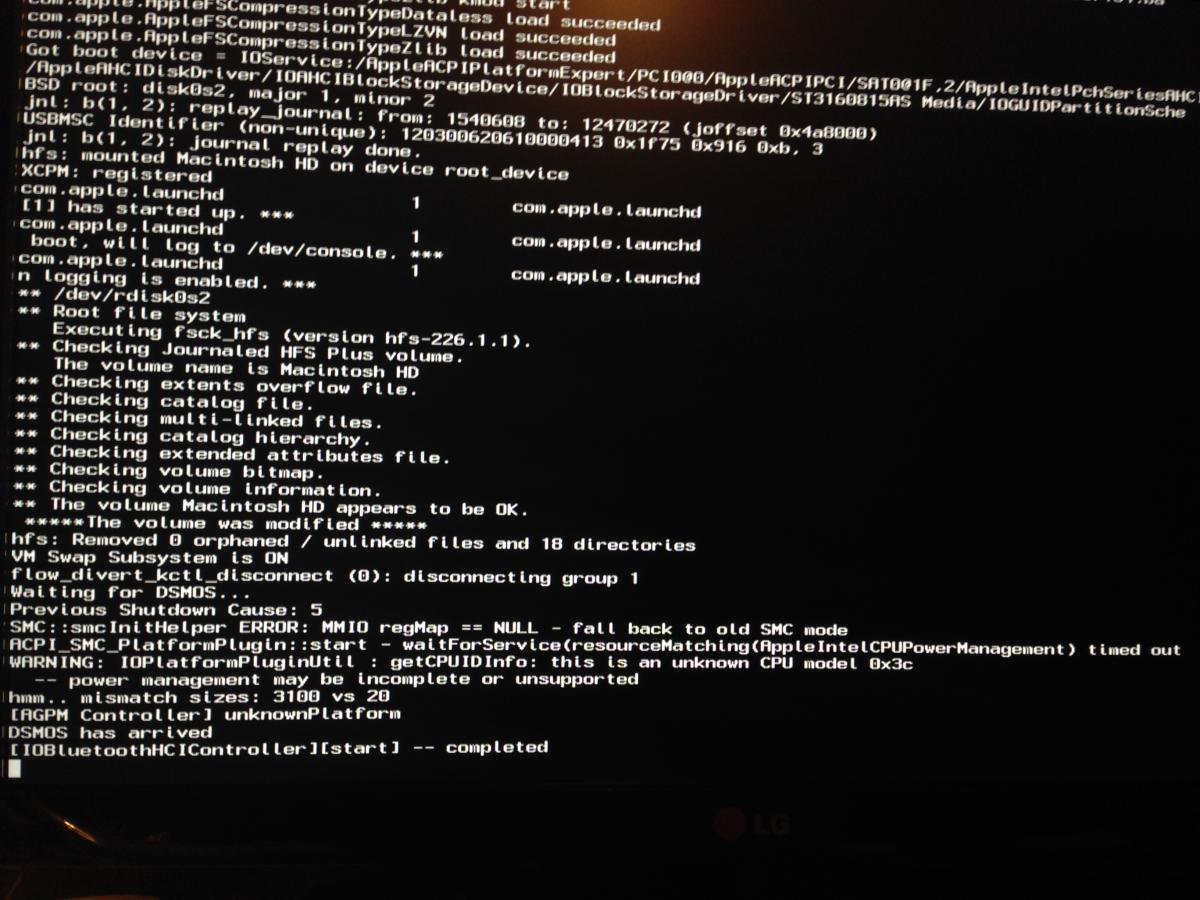

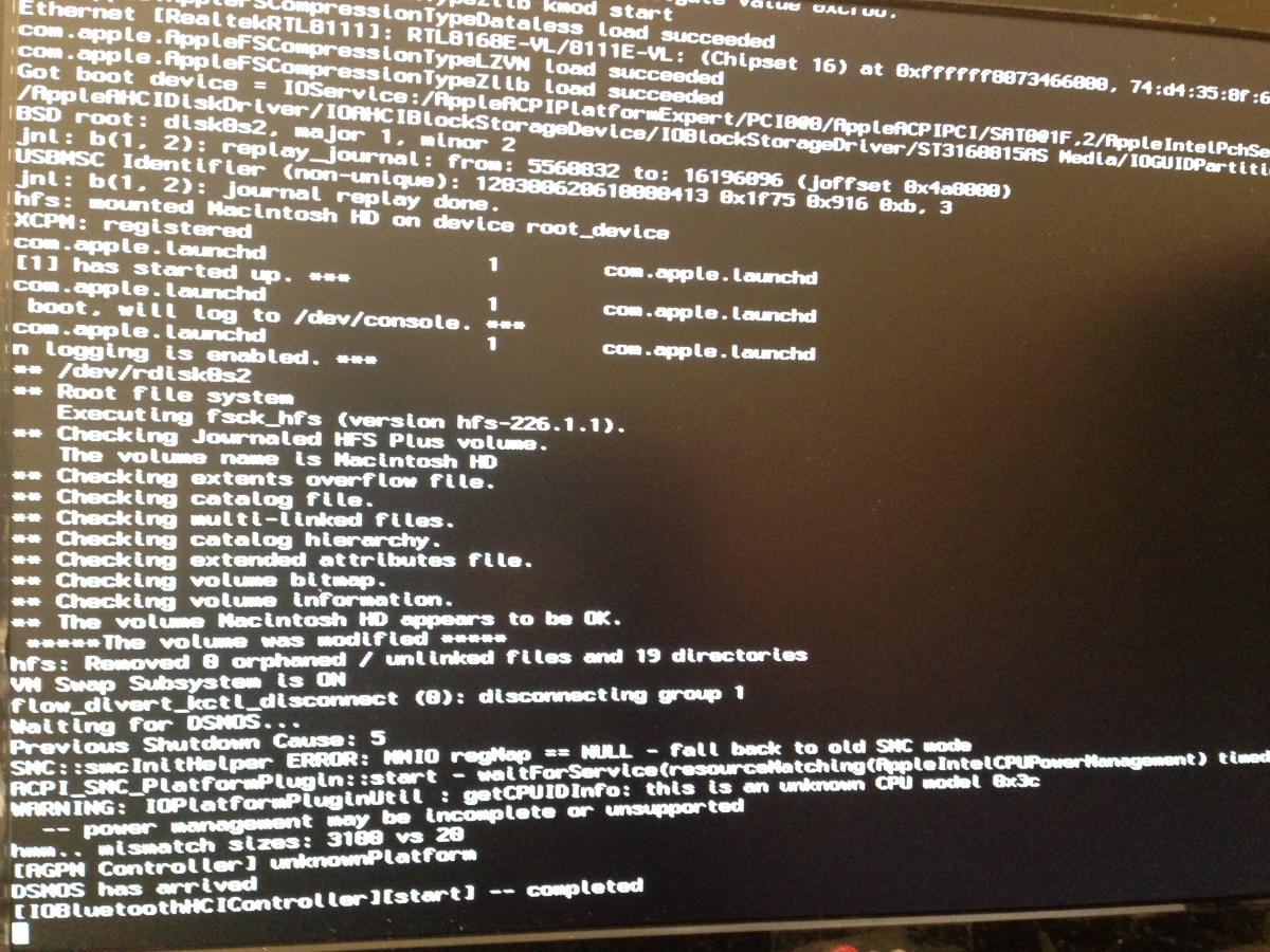

inonehalf Posted September 17, 2014 Author Share Posted September 17, 2014 Hello. I,ve already done what u suggested. I used chamaleon and now i have another error. I injected IntelAzulFB=10 for HD4600 and GraphicsEnabler=Yes, -x -v. Also i dont have the monitor connected on DVI or HDMI port (is this important?). I have it on the normal blue port. what should i do? sorry i,ve forgot the image Quote Link to comment https://www.insanelymac.com/forum/topic/300908-ga-b85m-d3h-no-booting-even-with-flags/#findComment-2061442 Share on other sites More sharing options...
vusun123 Posted September 17, 2014 Share Posted September 17, 2014 Enter dart=0 too. I have a friend who have the same board, same cpu and it booted fine. The flags I used were: -v -f GraphicsEnabler=Yes dart=0 IntelAzulFB=10. Make sure you have FakeSMC.kext; also connect the monitor via HDMI or DVI. VGA isn't natively support for Haswell IGPU ( I used DVI ) Edit: Maybe the monitor's resolution is important too. I can't get it to boot using a monitor with resolution less than 1600x900 Quote Link to comment https://www.insanelymac.com/forum/topic/300908-ga-b85m-d3h-no-booting-even-with-flags/#findComment-2061469 Share on other sites More sharing options...
