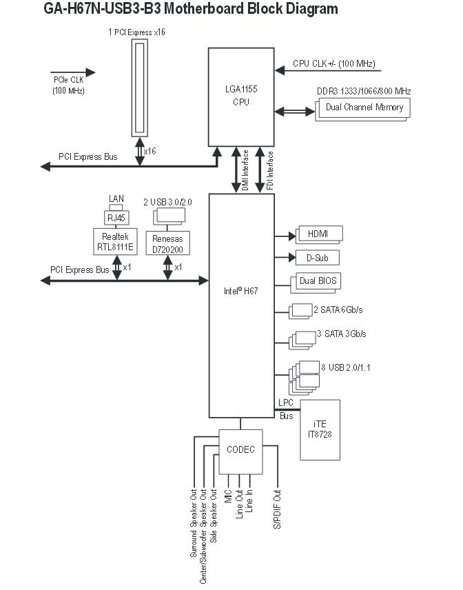

PippoX0 Posted September 11, 2014 Author Share Posted September 11, 2014 can you give us more details from linux using lspci -v to find out which usb3 controller is onboard? instead of installing additional kexts like PXHCD.kext you could have even fixed your dsdt properly to make the vanilla kexts work on your board. Thanks DirectXtraOrninary, I looked at Motherboard User manual and i found that MB USB3 controller should be NEC/Renesas USb3.0 controller Specific -> Renesas D720200 Any ideas how to get it working?? Link to comment https://www.insanelymac.com/forum/topic/300819-optimized-for-ssd-inateck-usb-30-hdd-case/#findComment-2059672 Share on other sites More sharing options...
