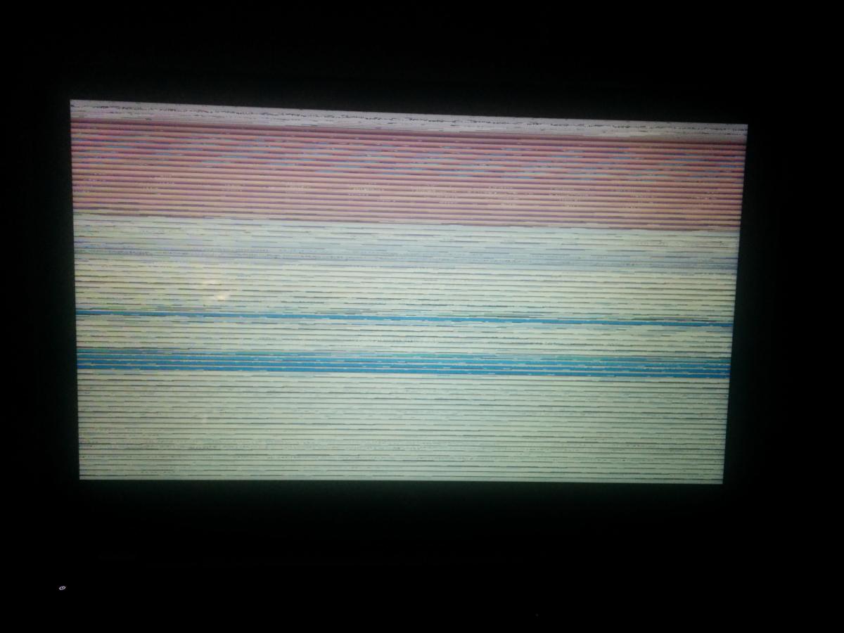

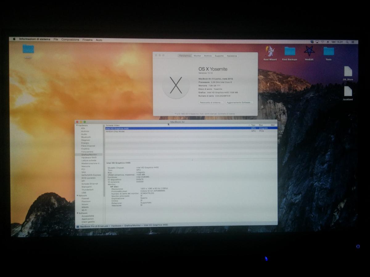

ele146cc Posted August 22, 2014 Author Share Posted August 22, 2014 i have some good news! I read the topic again and i found that i had written 0x0300220D but in clover i have to write 0x0D220003. Now i have full qe/ci on HDMI and something weird with lvds. Screen Below Link to comment https://www.insanelymac.com/forum/topic/300241-intel-graphics-hd4400-hdmi-problem/#findComment-2054253 Share on other sites More sharing options...
Allan Posted July 18, 2015 Share Posted July 18, 2015 Maybe you'll need edit some Framebuffer values for your LVDS. Link to comment https://www.insanelymac.com/forum/topic/300241-intel-graphics-hd4400-hdmi-problem/#findComment-2153956 Share on other sites More sharing options...
