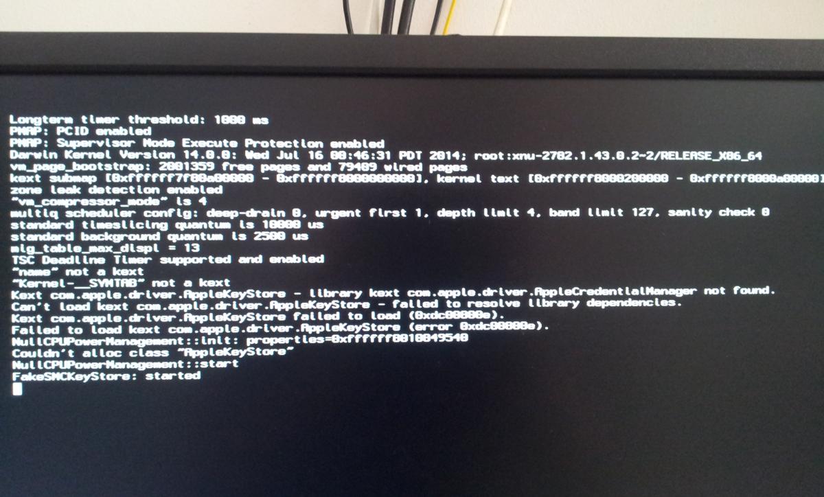

vuhothang Posted August 10, 2014 Share Posted August 10, 2014 Hello All! I using Yosemite DP1-2-3-4-5, now i want to check Beta, i was created usb likw DP1 with Chameleon R2391 and here is ocb file: <?xml version="1.0" encoding="UTF-8"?> <!DOCTYPE plist PUBLIC "-//Apple//DTD PLIST 1.0//EN" "http://www.apple.com/DTDs/PropertyList-1.0.dtd"> <plist version="1.0"> <dict> <key>EthernetBuiltIn</key> <string>Yes</string> <key>Kernel Flags</key> <string>-v -f kext-dev-mode=1</string> <string>Yes</string> <key>UseKernelCache</key> <string>No</string> </dict> </plist> and smbios is mac mini 6,2. I stucked like this picture attach. Can someone help to resolve. Thanks! Link to comment https://www.insanelymac.com/forum/topic/300171-yosemite-beta-1-stuck/ Share on other sites More sharing options...
HBP Posted August 10, 2014 Share Posted August 10, 2014 By the look, the boot loader is not passing everything cleanly to boot.efi. I would wait until that boot loader has been fixed or use the clover boot loader listed in this forum http://www.insanelymac.com/forum/topic/299865-clover-v2k-r2780-special-edition-yosemite-beta/, you can install it on a USB stick without messing your current boot loader up. Link to comment https://www.insanelymac.com/forum/topic/300171-yosemite-beta-1-stuck/#findComment-2050277 Share on other sites More sharing options...
aww Posted August 10, 2014 Share Posted August 10, 2014 From my own experience, bad boot sectors, you will not get to this state, try a FakeSMC without sensors plugins, try suppress cache. Link to comment https://www.insanelymac.com/forum/topic/300171-yosemite-beta-1-stuck/#findComment-2050367 Share on other sites More sharing options...
vuhothang Posted August 10, 2014 Author Share Posted August 10, 2014 it stuck with usb installer boot to install YM beta, i was try with FakeSMC without sensor plugins. how to try suppress cache? Link to comment https://www.insanelymac.com/forum/topic/300171-yosemite-beta-1-stuck/#findComment-2050434 Share on other sites More sharing options...

vuhothang Posted August 15, 2014 Author Share Posted August 15, 2014 I was created usb like vanilla creater, this usb can boot to install on other PC. Now it resolved, my mainboard is Asrock B75 Pro3-M with bios 1.90 patched with PMPatch, now i return to bios to 1.50 patched download from repobios space on tonymacx86 forum, now can boot with usb installer. Thanks! Link to comment https://www.insanelymac.com/forum/topic/300171-yosemite-beta-1-stuck/#findComment-2051872 Share on other sites More sharing options...
