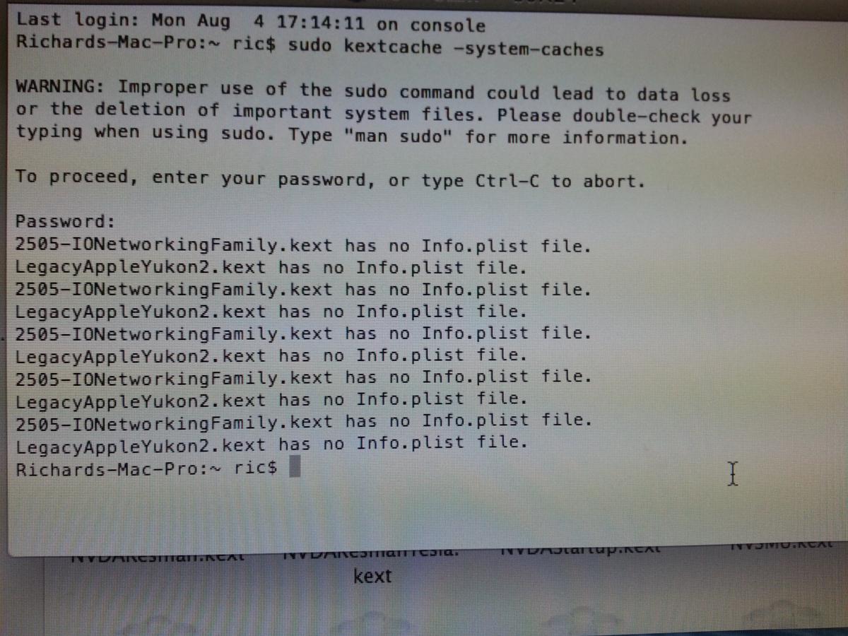

Phr4c7ur3 Posted August 4, 2014 Author Share Posted August 4, 2014 Small update: I tried to update kernelcache manually and I got a list of errors telling me that 2 of my Kexts have no info.plist. Screen image attached. I'm reaching the limits of my knowledge now so I'd appreciate any input whatsoever. Link to comment https://www.insanelymac.com/forum/topic/300036-asus-p6t-deluxe-v2-ethernet-and-sound-issues-post-intall/#findComment-2048505 Share on other sites More sharing options...
rlf Posted August 4, 2014 Share Posted August 4, 2014 Reinstall. Use Kext Wizard to install kexts properly. It will update the kext cache for you: http://www.insanelymac.com/forum/topic/253395-kext-wizard-easy-to-use-kext-installer-and-more/ Link to comment https://www.insanelymac.com/forum/topic/300036-asus-p6t-deluxe-v2-ethernet-and-sound-issues-post-intall/#findComment-2048506 Share on other sites More sharing options...
Phr4c7ur3 Posted August 4, 2014 Author Share Posted August 4, 2014 Should I remove the Kexts before reinstalling or will the refresh take care of any old info? Link to comment https://www.insanelymac.com/forum/topic/300036-asus-p6t-deluxe-v2-ethernet-and-sound-issues-post-intall/#findComment-2048511 Share on other sites More sharing options...
rlf Posted August 4, 2014 Share Posted August 4, 2014 Typically, when reinstalling, you erase the partition. But if you are trying to save something that you already installed, then yes, delete the two broken kexts and install over top of your existing installation. Link to comment https://www.insanelymac.com/forum/topic/300036-asus-p6t-deluxe-v2-ethernet-and-sound-issues-post-intall/#findComment-2048521 Share on other sites More sharing options...

Capsule Posted August 8, 2014 Share Posted August 8, 2014 Why don't you update your kext permissions and delete their cache manually? All it takes is a few commands: http://www.macbreaker.com/2012/01/how-to-manually-install-kexts.html I've got the same MB/CPU and currently running 10.9.3 with network (obviously ;-)) and sound. The sound patching was a bit tricky, I patched my DSDT using these instructions (just the DSDT part) : http://www.insanelymac.com/forum/topic/280468-applehda-patching-in-mountain-lion/page-4?do=findComment&comment=1839042 And used this kext: http://www.insanelymac.com/forum/files/file/17-applehda-for-ad2000b-108/ For the network, you can follow these instructions: - Open a terminal and enter: sudo nano /System/Library/Extensions/IONetworkingFamily.kext/Contents/Plugins/AppleYukon2.kext/Contents/Info.plist- Find Yukon-88E8053 and make it Yukon-88E8056- Find 0x436211ab and make it 0x436411ab Of course you need the purge cache/fix kexts permissions everytime you make a change to them. HTH 1 Link to comment https://www.insanelymac.com/forum/topic/300036-asus-p6t-deluxe-v2-ethernet-and-sound-issues-post-intall/#findComment-2049718 Share on other sites More sharing options...

Phr4c7ur3 Posted August 9, 2014 Author Share Posted August 9, 2014 Why don't you update your kext permissions and delete their cache manually? All it takes is a few commands: http://www.macbreaker.com/2012/01/how-to-manually-install-kexts.html I've got the same MB/CPU and currently running 10.9.3 with network (obviously ;-)) and sound. The sound patching was a bit tricky, I patched my DSDT using these instructions (just the DSDT part) : http://www.insanelymac.com/forum/topic/280468-applehda-patching-in-mountain-lion/page-4?do=findComment&comment=1839042 And used this kext: http://www.insanelymac.com/forum/files/file/17-applehda-for-ad2000b-108/ For the network, you can follow these instructions: - Open a terminal and enter: sudo nano /System/Library/Extensions/IONetworkingFamily.kext/Contents/Plugins/AppleYukon2.kext/Contents/Info.plist - Find Yukon-88E8053 and make it Yukon-88E8056 - Find 0x436211ab and make it 0x436411ab Of course you need the purge cache/fix kexts permissions everytime you make a change to them. HTH Hi Capsule. Thank you for your response, those instructions helped me fix my Ethernet. I'm having some real issues with purging/fixing kextcache. I'm not able to use KextWizard as I described here and when I don't seem to be able to find the steps to manually purge/fix via Terminal...the steps described in the link you supplied above simply won't work for me. I'm going to attempt to get my sound working next... Watch this space! Link to comment https://www.insanelymac.com/forum/topic/300036-asus-p6t-deluxe-v2-ethernet-and-sound-issues-post-intall/#findComment-2049984 Share on other sites More sharing options...
