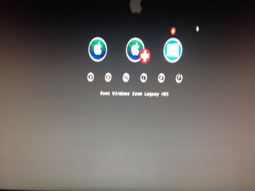

Agostino9446 Posted July 31, 2014 Share Posted July 31, 2014 Hi guys i decided to install yosemite with clover 2774...succesfull installation and everything work...i have only a problem i have two hdd one with windows 8.1 and another with yosemite beta public...at boot i select clover boot osx to boot up yosemite but if i select windos it don't boot up...to boot up windows i have to change everytime boot priority and chose windows hdd...so i ask you an solution...please help me! Link to comment https://www.insanelymac.com/forum/topic/299964-dual-boot-clover-2774/ Share on other sites More sharing options...
crusher Posted July 31, 2014 Share Posted July 31, 2014 Hi guys i decided to install yosemite with clover 2774...succesfull installation and everything work...i have only a problem i have two hdd one with windows 8.1 and another with yosemite beta public...at boot i select clover boot osx to boot up yosemite but if i select windos it don't boot up...to boot up windows i have to change everytime boot priority and chose windows hdd...so i ask you an solution...please help me! Post a picture how it looks.... Link to comment https://www.insanelymac.com/forum/topic/299964-dual-boot-clover-2774/#findComment-2047108 Share on other sites More sharing options...
Agostino9446 Posted July 31, 2014 Author Share Posted July 31, 2014 Post a picture how it looks.... Link to comment https://www.insanelymac.com/forum/topic/299964-dual-boot-clover-2774/#findComment-2047110 Share on other sites More sharing options...

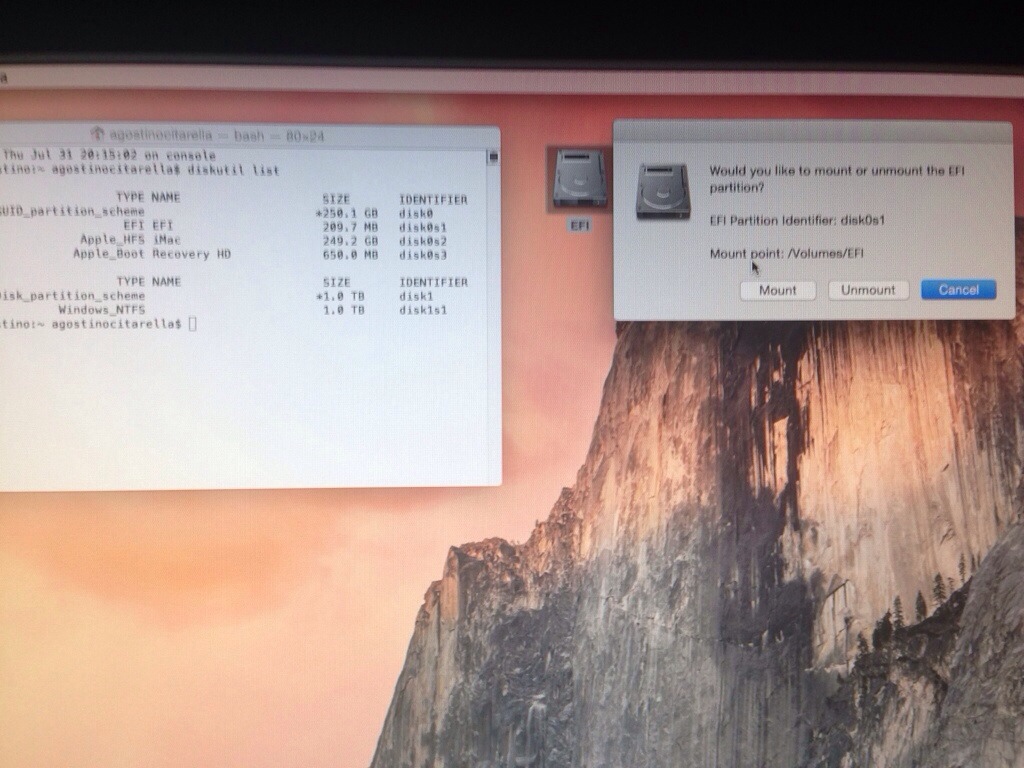

crusher Posted July 31, 2014 Share Posted July 31, 2014 ImageUploadedByTapatalk1406844886.326787.jpg Go to Utilities/Disk Utility and post pisture Link to comment https://www.insanelymac.com/forum/topic/299964-dual-boot-clover-2774/#findComment-2047112 Share on other sites More sharing options...
Agostino9446 Posted July 31, 2014 Author Share Posted July 31, 2014 I can give you this because i am not near pc...and this i think is the same Link to comment https://www.insanelymac.com/forum/topic/299964-dual-boot-clover-2774/#findComment-2047115 Share on other sites More sharing options...
crusher Posted July 31, 2014 Share Posted July 31, 2014 Why no snapshot your screen. command+shift+3 or 4 on win keyboard windows+shift+3 or 4 Link to comment https://www.insanelymac.com/forum/topic/299964-dual-boot-clover-2774/#findComment-2047120 Share on other sites More sharing options...
Agostino9446 Posted July 31, 2014 Author Share Posted July 31, 2014 I posted a screen that i make before...because now i am not at home...can you help me please Link to comment https://www.insanelymac.com/forum/topic/299964-dual-boot-clover-2774/#findComment-2047121 Share on other sites More sharing options...
crusher Posted July 31, 2014 Share Posted July 31, 2014 Why no snapshot your screen. command+shift+3 or 4 on win keyboard windows+shift+3 o You no have system reserved. You have a second HDD Look pic It's that no bootable. Link to comment https://www.insanelymac.com/forum/topic/299964-dual-boot-clover-2774/#findComment-2047122 Share on other sites More sharing options...
Agostino9446 Posted July 31, 2014 Author Share Posted July 31, 2014 And what i have to do to solve this problem? Link to comment https://www.insanelymac.com/forum/topic/299964-dual-boot-clover-2774/#findComment-2047123 Share on other sites More sharing options...

fusion71au Posted August 1, 2014 Share Posted August 1, 2014 @Agostino9446, It looks like you have a similar issue to @powermapler who had problems dual booting OSX and legacy (MBR) Windows (installed on separate drives) with Clover. Try @dmazar's suggestion from post#5268 in the Clover General Discussion Thread (BIOS set to boot in both UEFI and legacy mode) set Clover option as first one in boot order in UEFI/BIOS screen set your legacy windows drive as second one in boot order in UEFI/BIOS screen set Boot/Legacy=LegacyBiosDefault in Clover's config.plist And then selecting any legacy entry in your Clover main menu should boot your legacy windows If you still have problems, I would suggest you reinstall UEFI Windows on a GUID partitioned drive with EFI partition. It is much easier to dual boot OSX & UEFI Windows with Clover. Good Luck! 1 Link to comment https://www.insanelymac.com/forum/topic/299964-dual-boot-clover-2774/#findComment-2047214 Share on other sites More sharing options...
Agostino9446 Posted August 1, 2014 Author Share Posted August 1, 2014 @Agostino9446, It looks like you have a similar issue to @powermapler who had problems dual booting OSX and legacy (MBR) Windows (installed on separate drives) with Clover. Try @dmazar's suggestion from post#5268 in the Clover General Discussion Thread (BIOS set to boot in both UEFI and legacy mode) set Clover option as first one in boot order in UEFI/BIOS screen set your legacy windows drive as second one in boot order in UEFI/BIOS screen set Boot/Legacy=LegacyBiosDefault in Clover's config.plist And then selecting any legacy entry in your Clover main menu should boot your legacy windows If you still have problems, I would suggest you reinstall UEFI Windows on a GUID partitioned drive with EFI partition. It is much easier to dual boot OSX & UEFI Windows with Clover. Good Luck! You are the best...workkkkk Link to comment https://www.insanelymac.com/forum/topic/299964-dual-boot-clover-2774/#findComment-2047230 Share on other sites More sharing options...
